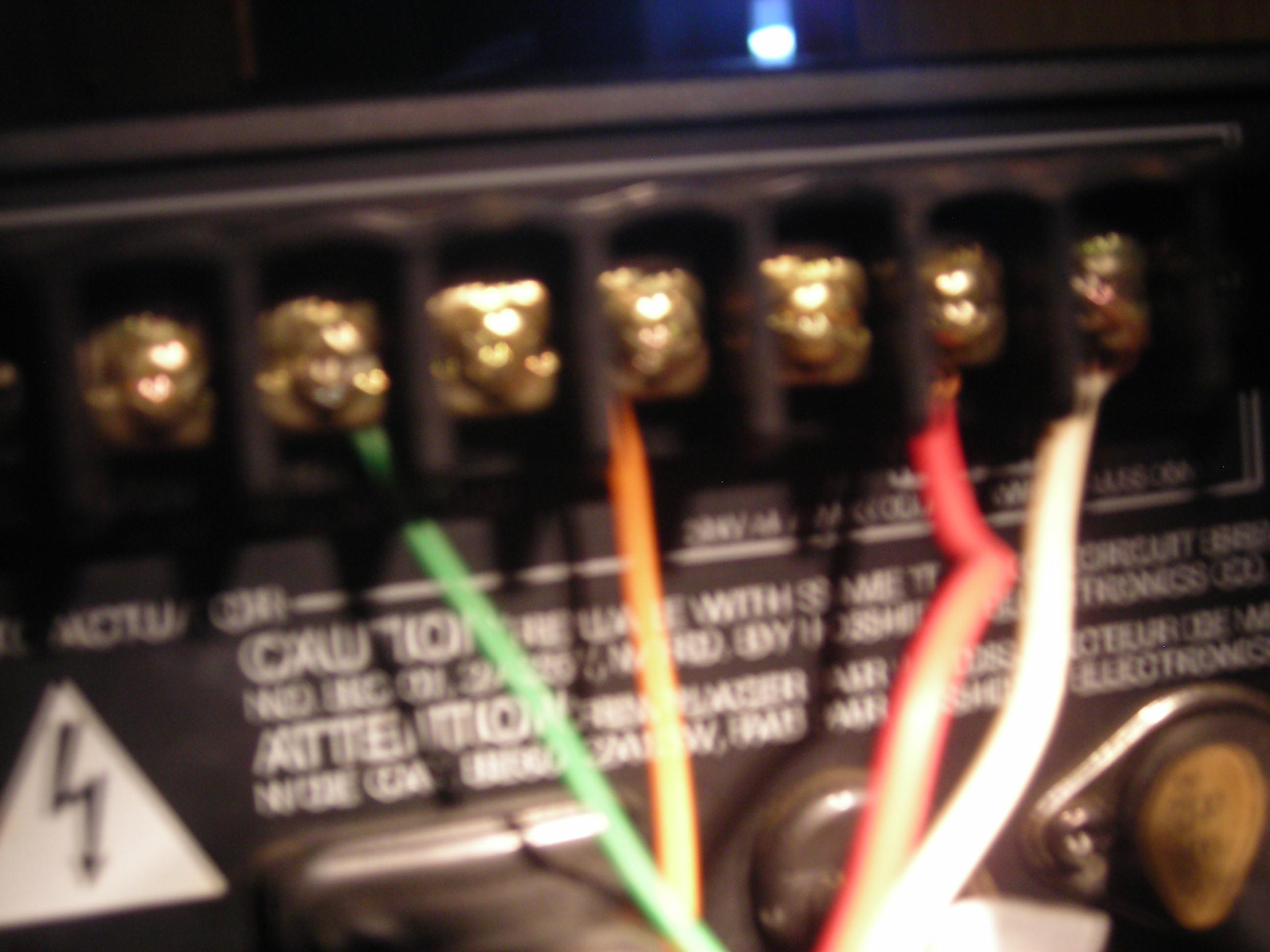

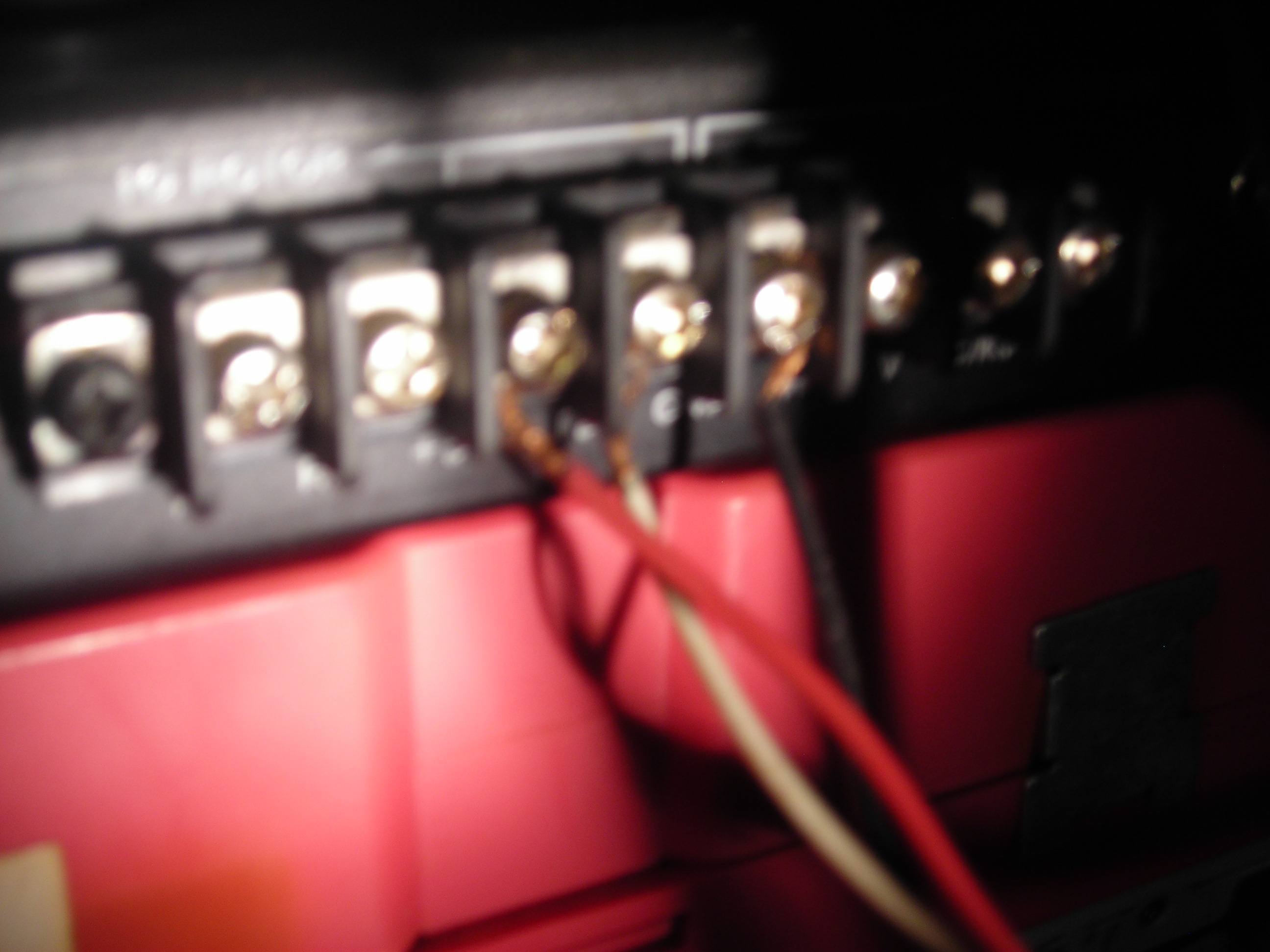

How many cables or wires go from the receiver to the dish? I am just wanting to get an idea of what size conduit i need.
Also, i noticed that the 4dtv receiver best output connection is an S video:(. I have an DVI out on my sony sat receiver now. Man, there is a huge difference between the s video and dvi quality in the picture. I have a sony LCD projection tv. So you know what the blurry can mean on that tv. I have heard some bragging about the Cband quality versus pizza. Is there really that much difference?
On my C-band, There are three separate wires. The box is a General Instrument analog which I use as a dish mover.
#1 one coax going from the dish to the box.
#2 another wire with three small wires.
#3 another wire with four wires.
May I suggest, as long as you are running conduit, add some additional coax wires in case you decide to add more dishes later on.
I would use the direct burial satellite ribbon cable they sell and use PVC if you want to encase it.
