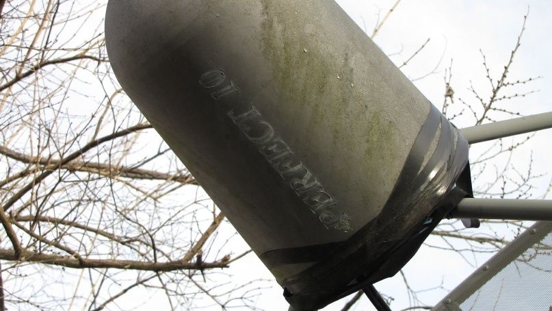

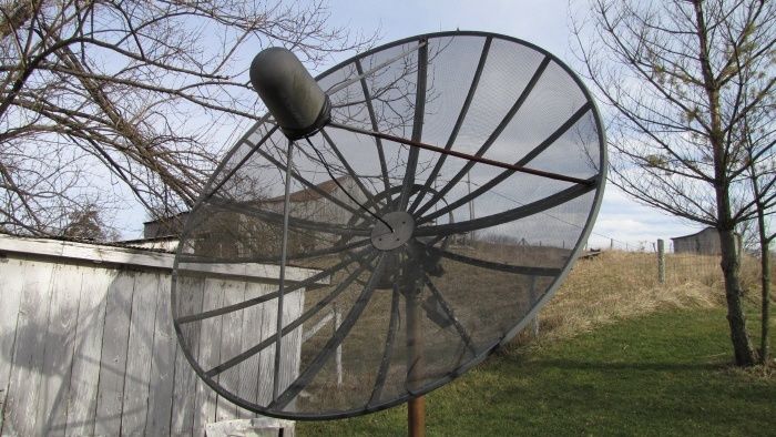

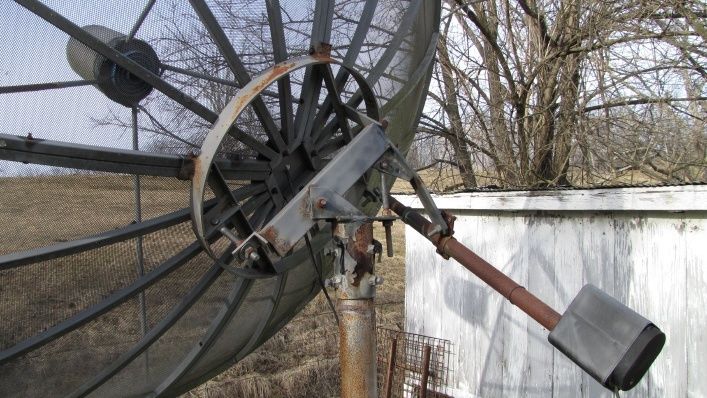

Okay, i just got back from looking at that dish i was telling yall about.

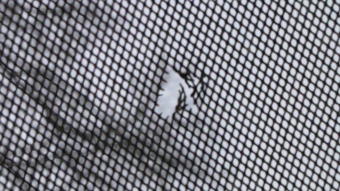

Its an 8ft, aluminum mesh dish. On the cover it says Perfect 10. There is a small hole in the mesh. About the size of a dime.
Anyway, here are some pics. Will this work for 4dtv, c/ku?

Yes it will work with C band and Ku and a 4DTV. Needs a bit of cleanup and paint for cosmetic reasons. You can fix that tear with some fine wire. If the electronics are good you won't have to replace those.

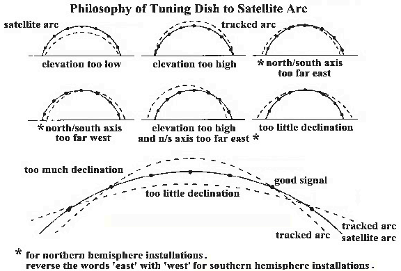

Here is another link to a page on the site TVROPro posted earlier.
Footprints by Dish Size - Adjusting the Polar Mount for Prime Focus Antenna - C/Ku-Band Satellite Systems - Tuning, Tracking, Azimuth, Elevation, Declination Angles, F/D Ratio, Focal Distance, Inclinometer, LNB/Feedhorn Assembly, Actuator Assembly, C
There is an arc tracking graphic near the bottom of the page that may help you invision the relationship between true south, inclination and declination.

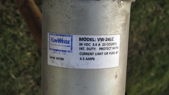

The jack might still work but I doubt it. It's a good one when new.

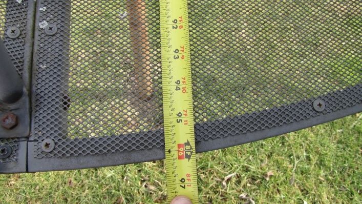

Did you measure the dish? It looks just like my 10'

I have already planned on replacing the jack. It may still work, but i doubt too. Think she told me last week that its about 15 years old.

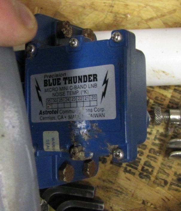

LNB - I THINK i want a c/ku lnb. Will i need a polarizer? What is a GOOD quality LNB?

From the bolts that i saw, there were 1/4-20 bolts and 1/2-13 bolts. I was also thinking about getting stainless hardware.
Pic added.

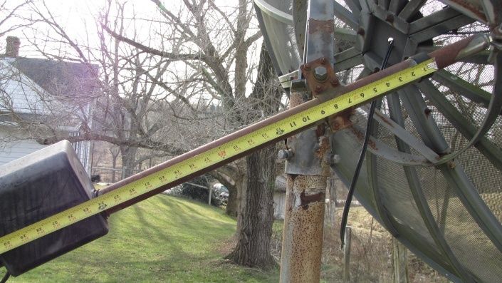

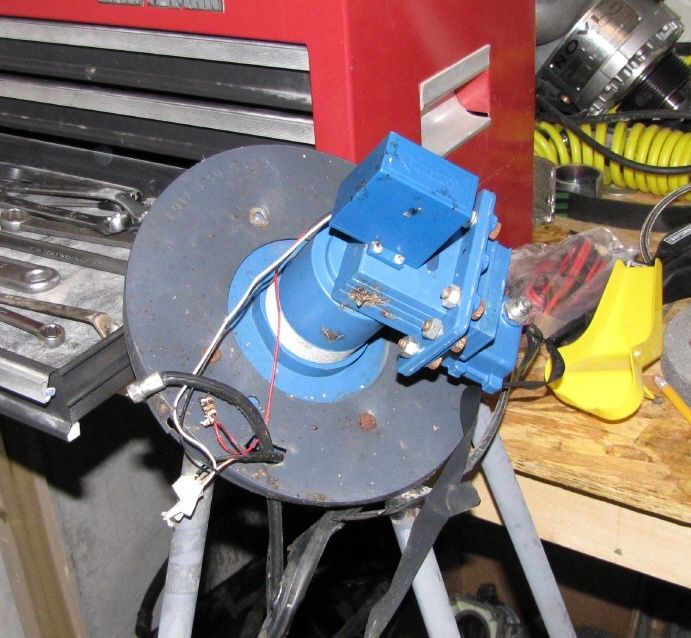

Well i got my dish home yesterday. Took me around an hour to take down. I took it down to two pieces and put in the trailer and brought it home.

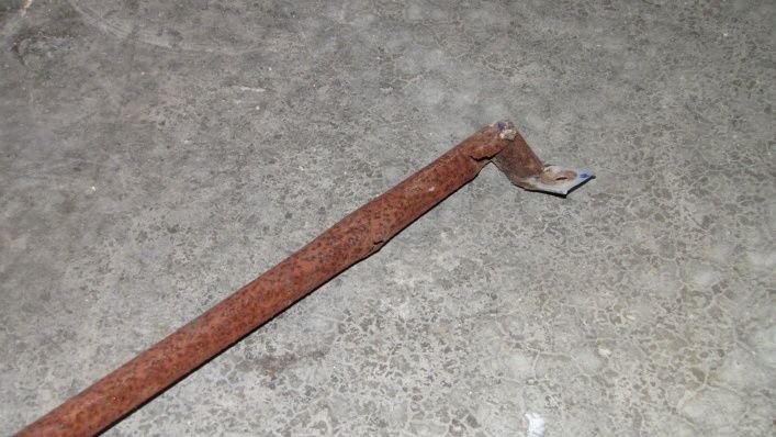

I noticed yesterday that one of the struts for the feedhorn assembly is toast. I have thought about buying four pieces of 1/2 inch EMT conduit that are five feet long. Mashing each end, then drilling a hole.
I am wondering, how do you KNOW that the feedhorn assembly is center of the dish?

Can anyone recommend a quality dishmover, LNB's and Feedhorn?
Here are some pics.
steve

Here are some pics.
steve
I think your idea with the EMT will work, just check your focal distance before you make them, and if you can elongate the holes in the scalar ends that will give you a little adjustment range.
You can determine if your feed is centered by measuring from the edge of the scalar, to the edge of the dish, at multiple points. Assuming your dish is round, that should get you pretty close.
Once the assembly is centered some people here have adapted laser pointers (and other methods) and put them in the feedhorn to determine if the feed is actually pointing in the center of the dish. You may not have to do this (laser test), if you get the feed centered I would go ahead and try it.

Seems like that is always the way. Find another dish just like yours and get one of the legs off it and you will have two extra good ones :)
The jack you have on there is a really nice one but I don't think they are made anymore at least that I can find
I bought mine from here
rickssatellitedishmovers
Try all the stuff you have first, then spend money on new stuff
