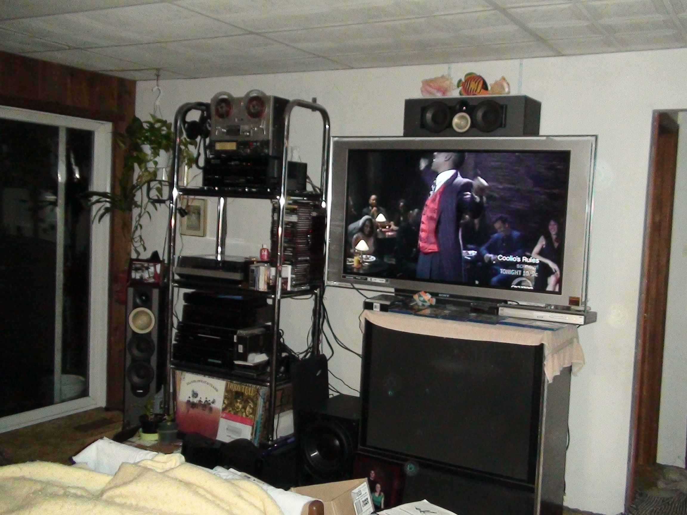

Here's my mounting system
I mounted simple shelf brackets (from Lowes) on the wall behind the TV and put the center speaker on a 12" wide shelf at the top, aligned with the top of the TV. In my case it's a Paradigm CC-290. That sucker weighs 32 lbs, so having a sturdy mount was not trivial! I have the speaker moved out form the wall by about 1" to allow the bass ports some room to breathe. I actually have 2 other 10" wide shelves below the one holding the speaker to store accessories, like the missing speaker grilles and boxes containing cables, etc. and all the system paperwork. The total investment for brackets and pre-fab shelves was about $20. A wife/S.O. would totally disagree with this kind of arrangement, but at present I don't have one! Any future acquisition will have to "get with the plan"...!
(Note the "redneck TV stand"...!! I still have to find the ultimate piece to help consolidate my equipment and mount the TV. I might have to have a custom piece built...once I design it...)

I put simple shelf brackets on the wall behind the TV and put the center speaker on a 12" wide shelf at the top, aligned with the top of the TV.
Does it bother you that the mains have their tweeters significantly lower than the center? I used to have the opposite problem where the mains were higher than the center and it drove me nuts when the sound panned across the speakers and you heard that vertical dip.
To be honest, I haven't really taken notice! Maybe my speakers aren't quite as directional. I suppose I could angle the center down if it ever bothered me. As it is, when I'm hearing the voices from the center channel, I perceive them to be coming from where the image is, and in that respect there's little difference as far as imaging goes whether I have the sound coming from the system or from the TV's speakers. But I never claimed to be an audiophile!
The problem you mentioned would be the same for any center speaker high arrangement, more or less depending on the height difference vs. the fronts. I suppose one solution could be to raise the fronts. If I ever do build my ideal cabinet I'll lower the TV and thus the CS as well...

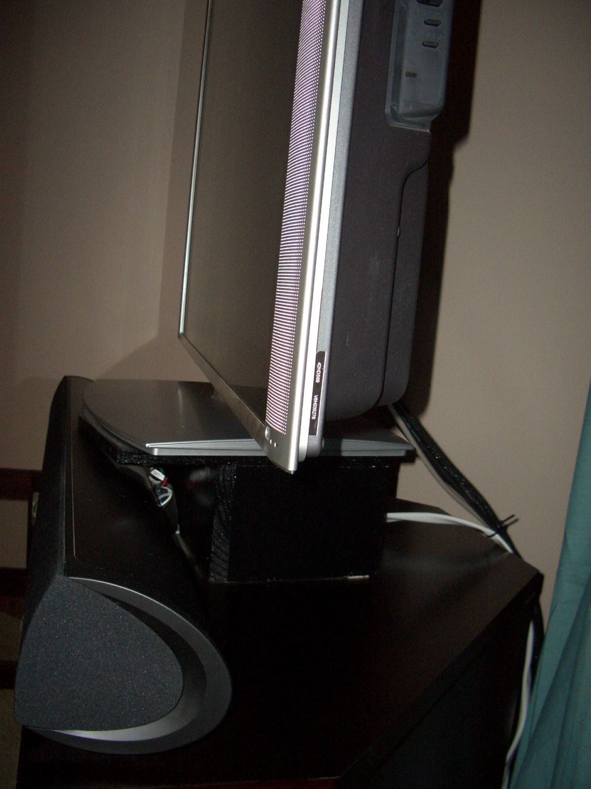

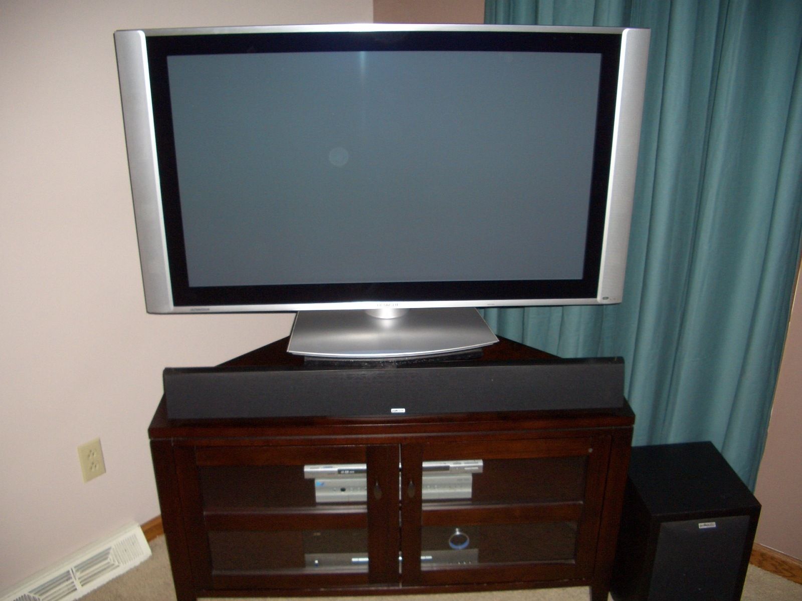

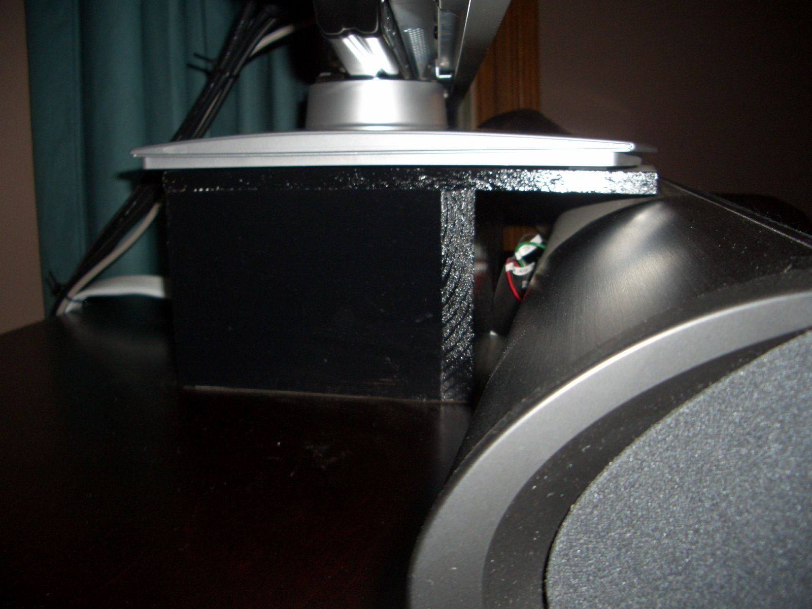

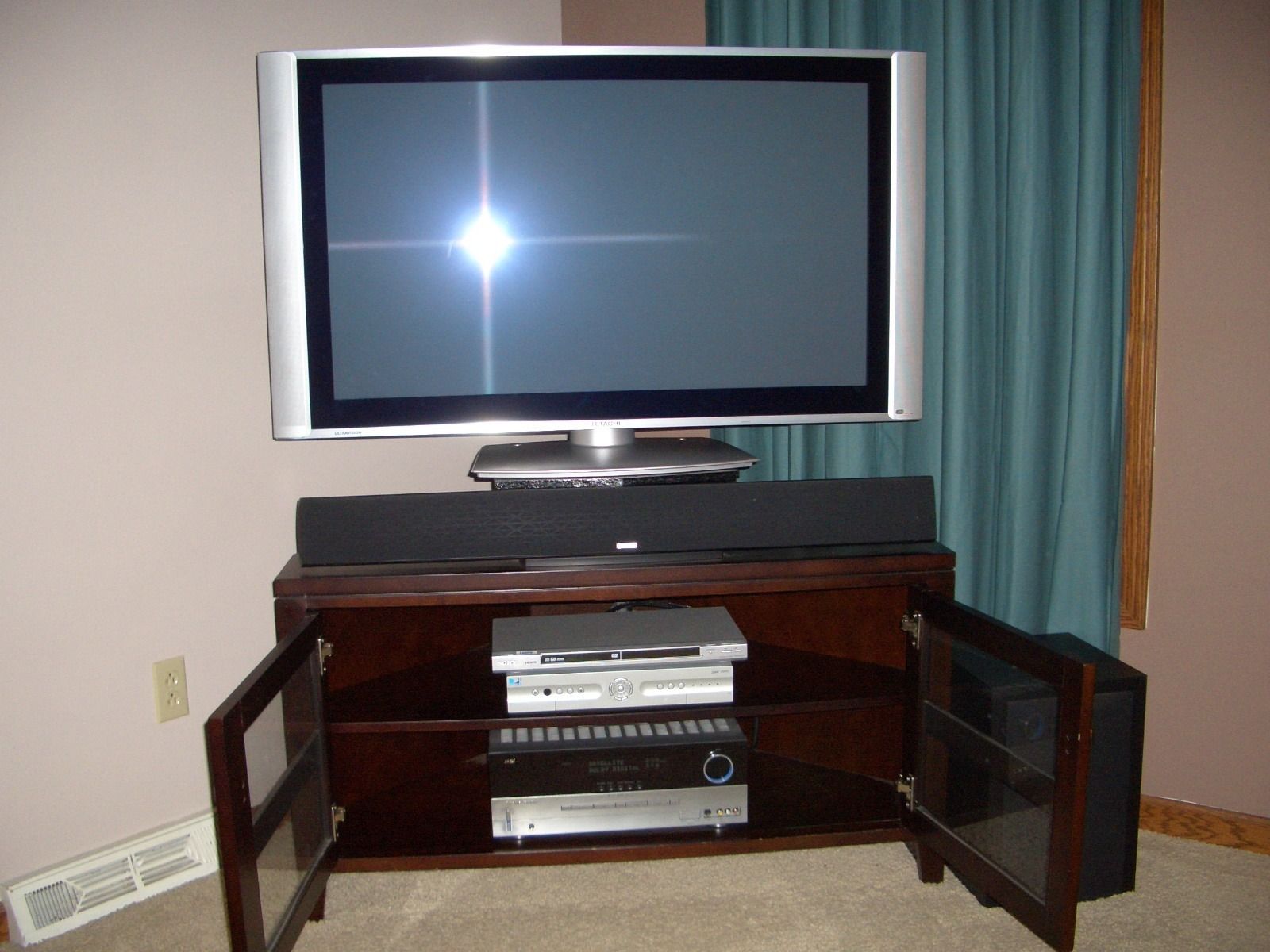

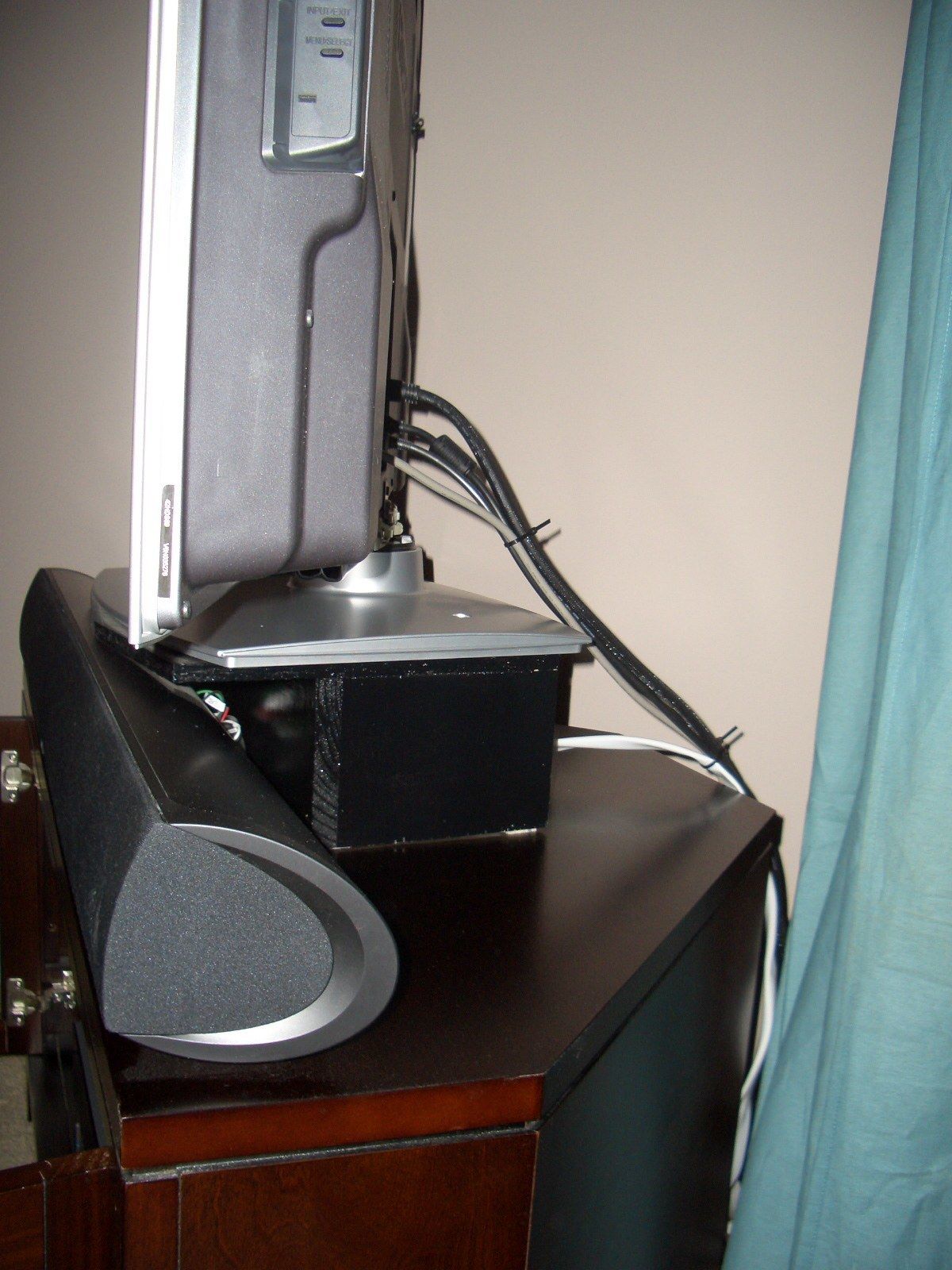

Ok, here's my living room setup. I built this L-Shaped box to elevate my Hitachi Plasma above my Polk SurroundBar. Before I built this lift, the speaker would sit infront of the TV and block the bottom of the TV border. Not anymore.....

I like the mount you built, whole thing looks clean.
