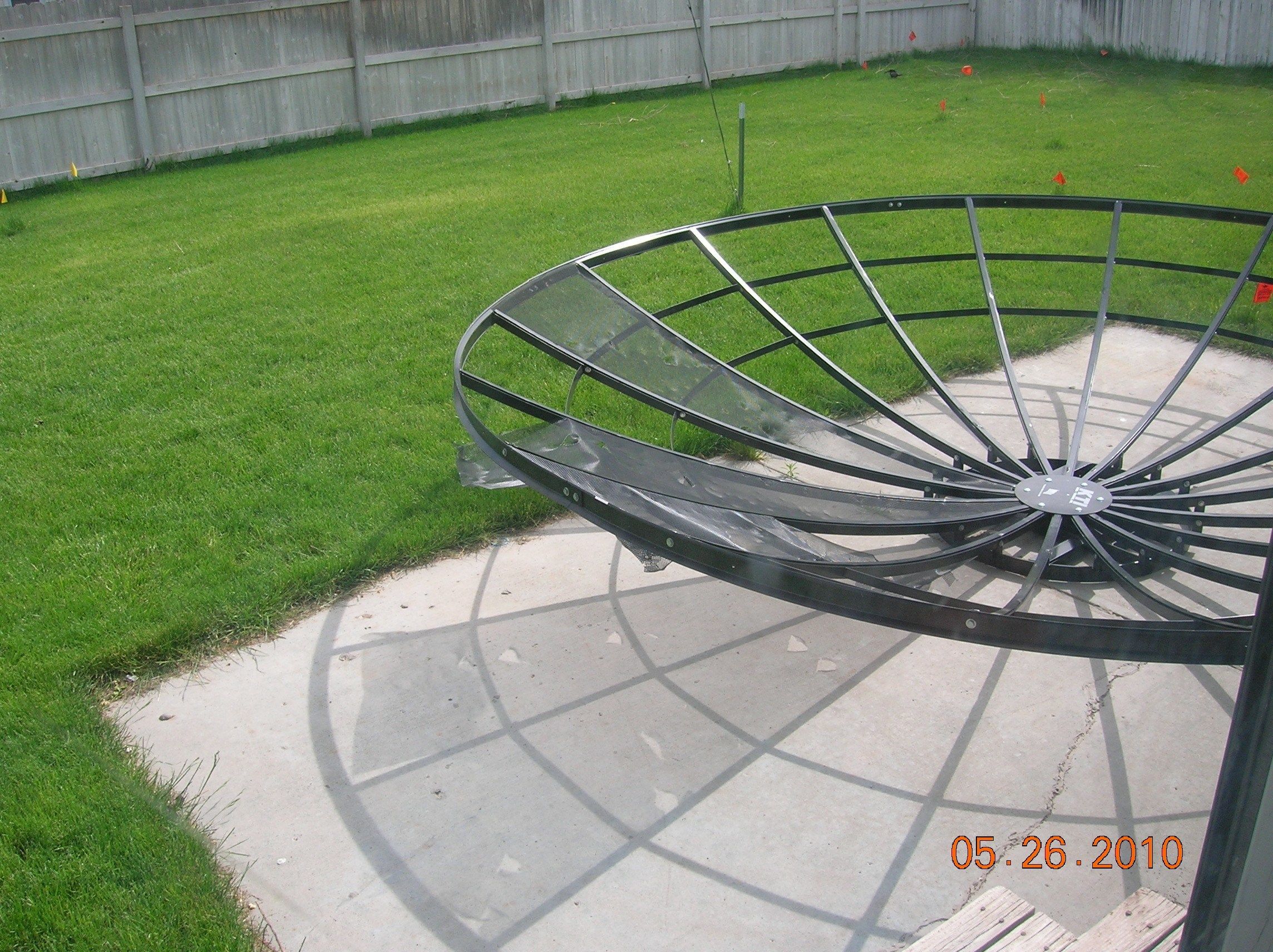

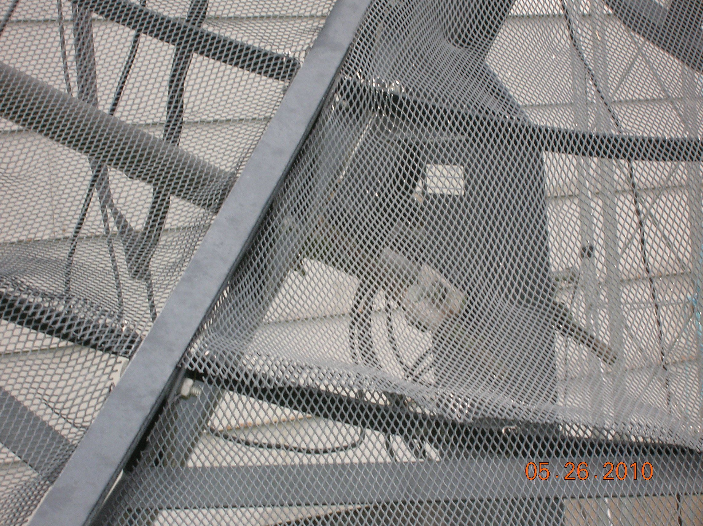

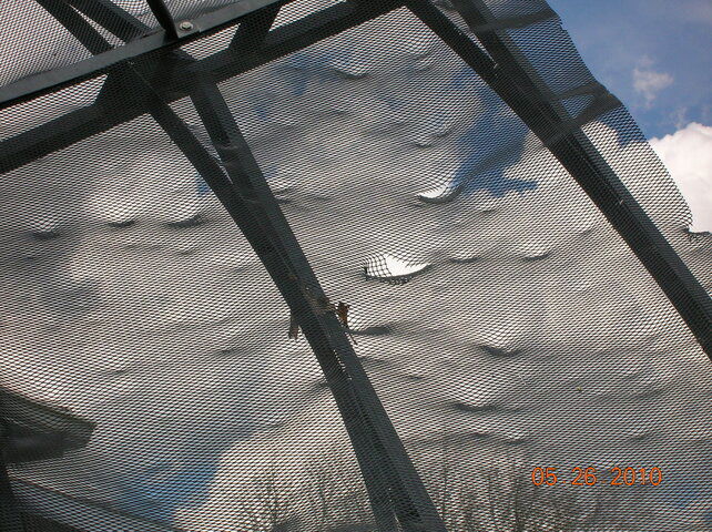

Had a major hail storm today with golf ball size hail that ripped thru my already hail damaged Paraclipse and I had 4 panels in the new antenna that the hail ripped thru. Plus the winds were 60+ MPH which added to the damage. So, no TV for awhile. And I can't get pre-cut mesh for either the Paraclipse or the KTI since they're both out of business. I can get mesh sheets from Skyvision but I doubt that I can cut a straight enough line. Any suggestions for cutting mesh accurately?

Post some pics of your paraclipse. If you take your time you can straighten out mesh, I did it with mine. Holes can just be worked back in as good as you can, if the mesh isn't gone completely. I did mine with a plastic faced hammer. :)
I'll have to get the dish off the mount to try that. A lot of the retaining clips for the mesh are gone also.
Turns out that I'll have to replace the new KTI in it's entirety. After closer inspection, the arms were smashed by the hail also. Skyvision is selling Samis (sp?) now. Anyone know about Prodelins or Patriot dishes?

Clips are easy to make, and even easier to replace. If the dish is accessible, a pair of dykes and 5 minutes, I can take a mesh panel off. Have a look at my Paraclipse thread...I did it all...even made a two piece patch panel from Winegard mesh... :D
I am the self-proclaimed KING of low-buck. Cheap if you must...I prefer economically-challenged. Post pics of ya Para, if it can be fixed, we can figure it out.

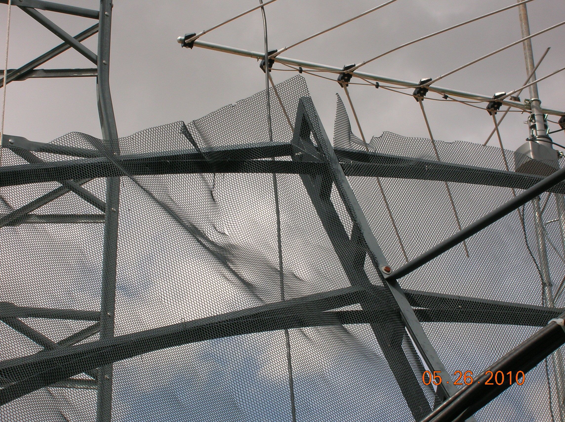

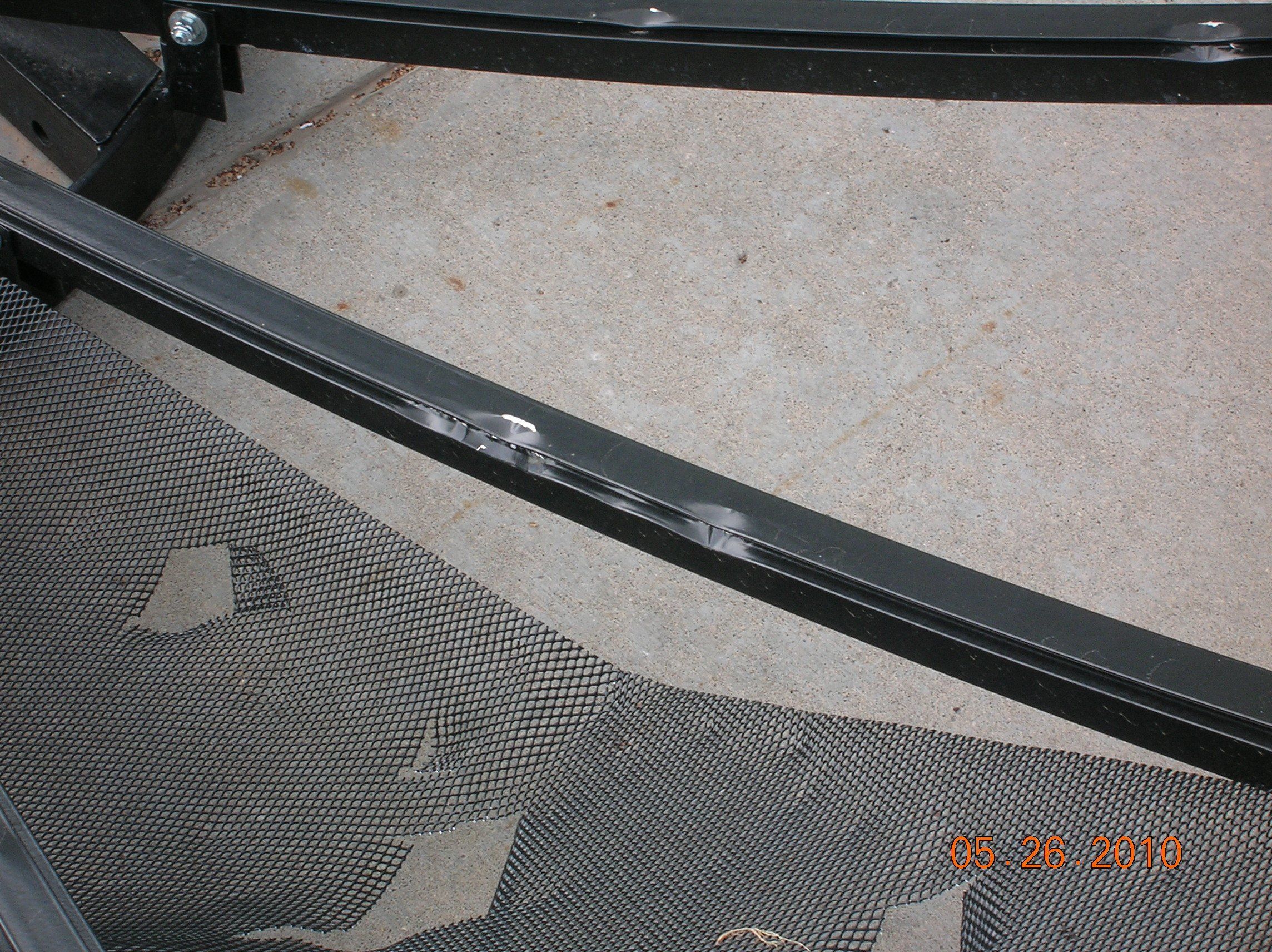

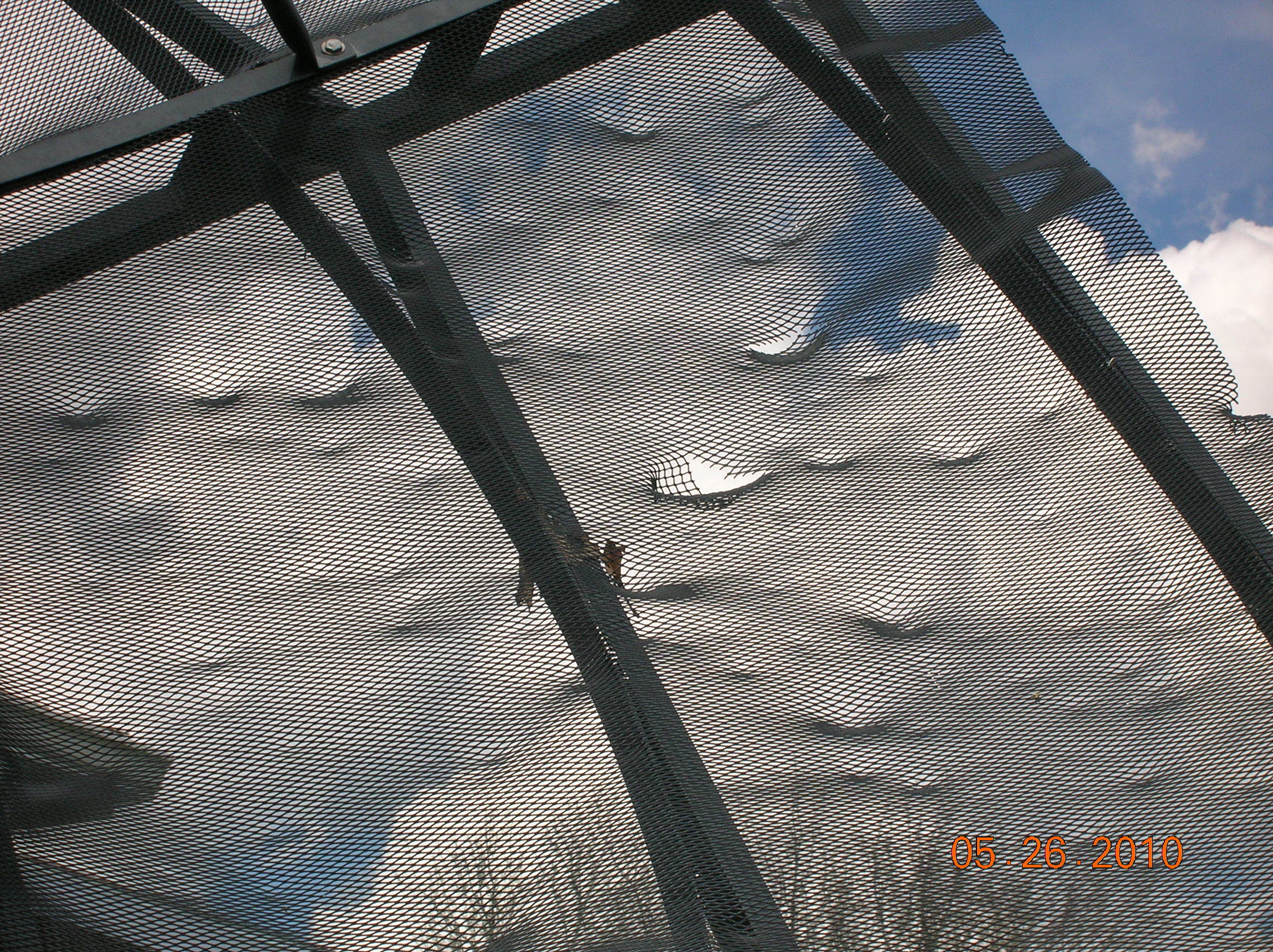

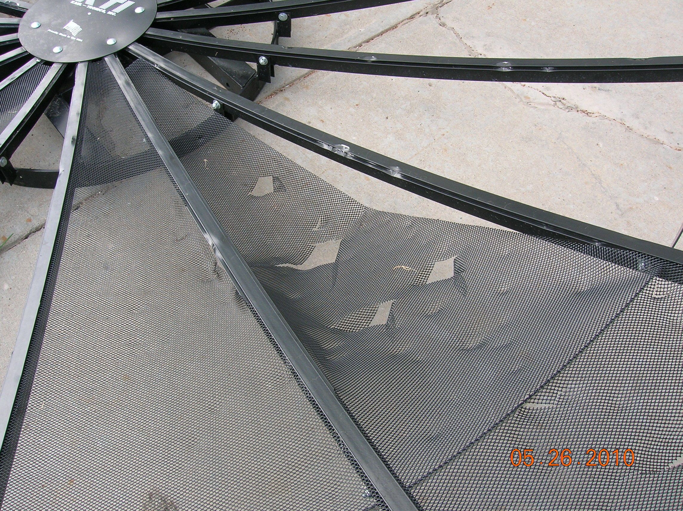

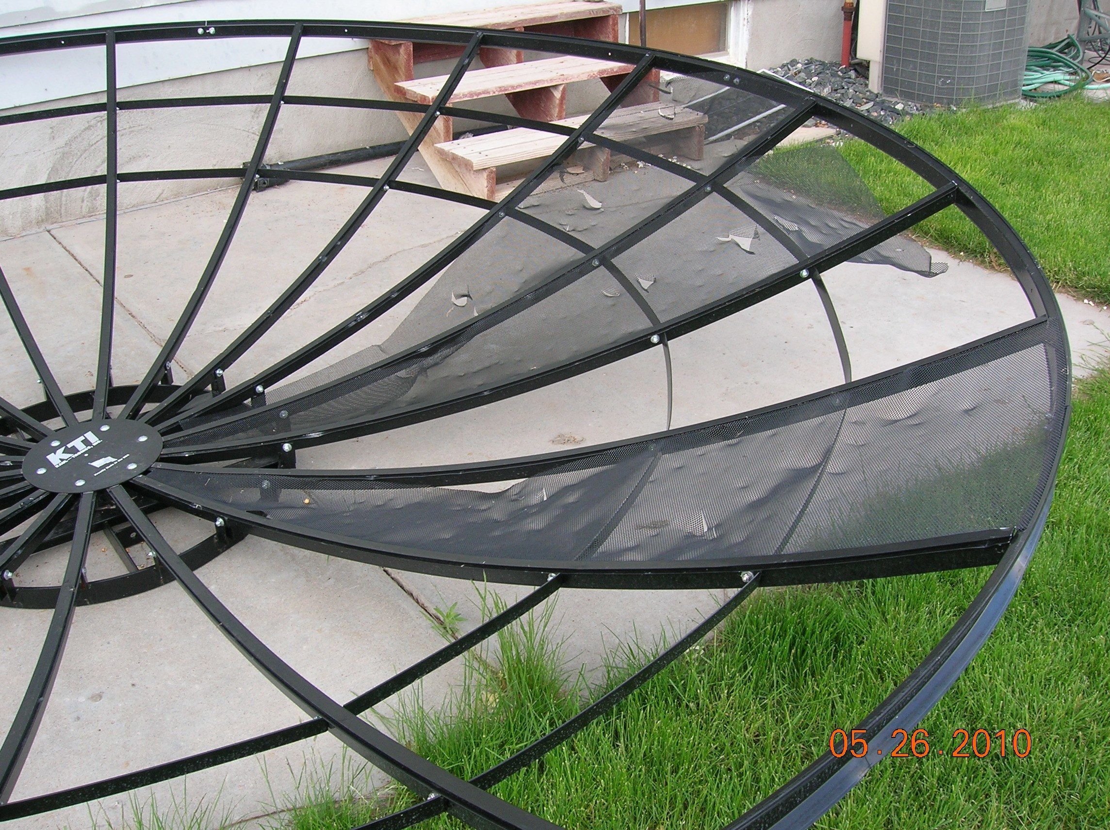

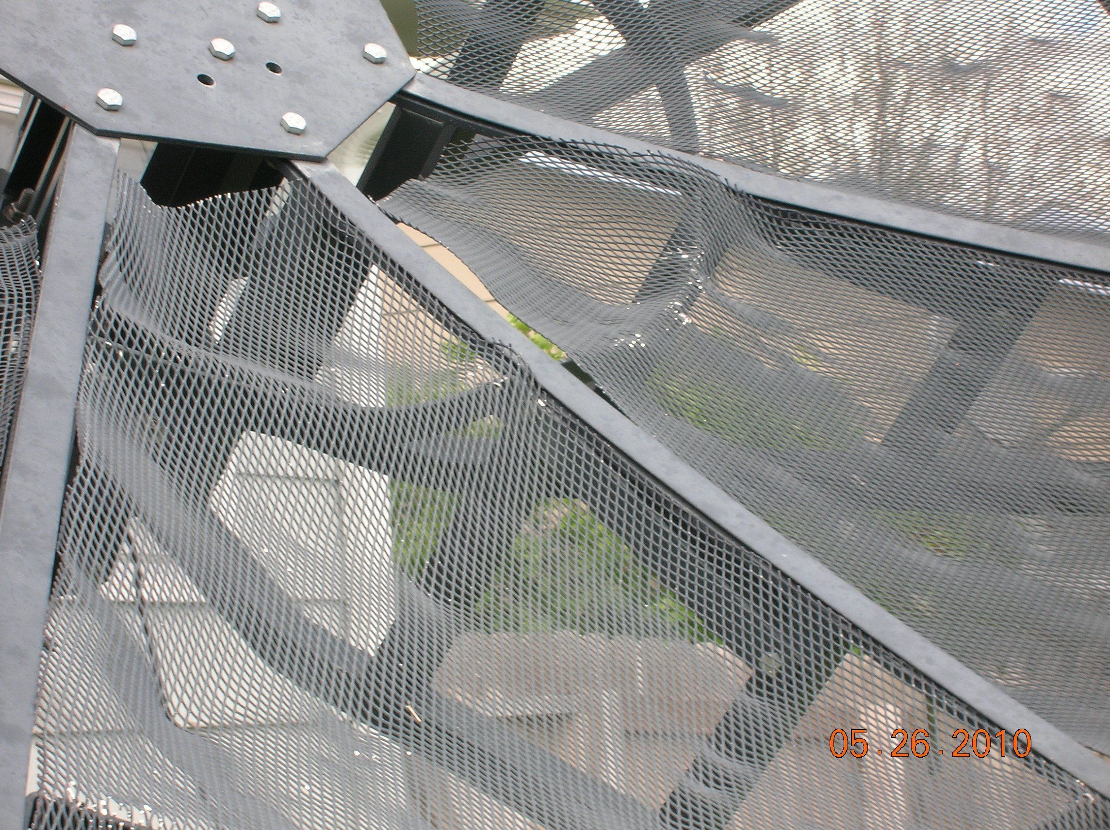

hail damage photos
You guys asked for these photos. Here they are. The dish on the ground was the new KTI dish. These are high resolution images.

I read an old thread the kills this idea. Anyway, I ordered a 90 cm dish + motor + Ku LNBF from WSI this afternoon. I still still plan on replacing the BUD for C-band but I'm undecided as to whether to get another 12 footer or the cheaper 10 footer. Apparently, some people in the forum really like their 10' Sami dish. If I do order one, I hope it really is as easy to assemble as they say. I was told that the Paraclipse and the KTI were easy assemblies but I didn't find them to be so. I'm also concerned about the comment from Skyvision that Sami isn't doing too well.......
Wow. I think I'd sit down and cry. :(
That being said, I think, given some time, you could salvage the paraclipse dish. It will take more time than money, but it can be done. If I were you there's no way I'd buy a new dish, not if hail is that big of a problem....
