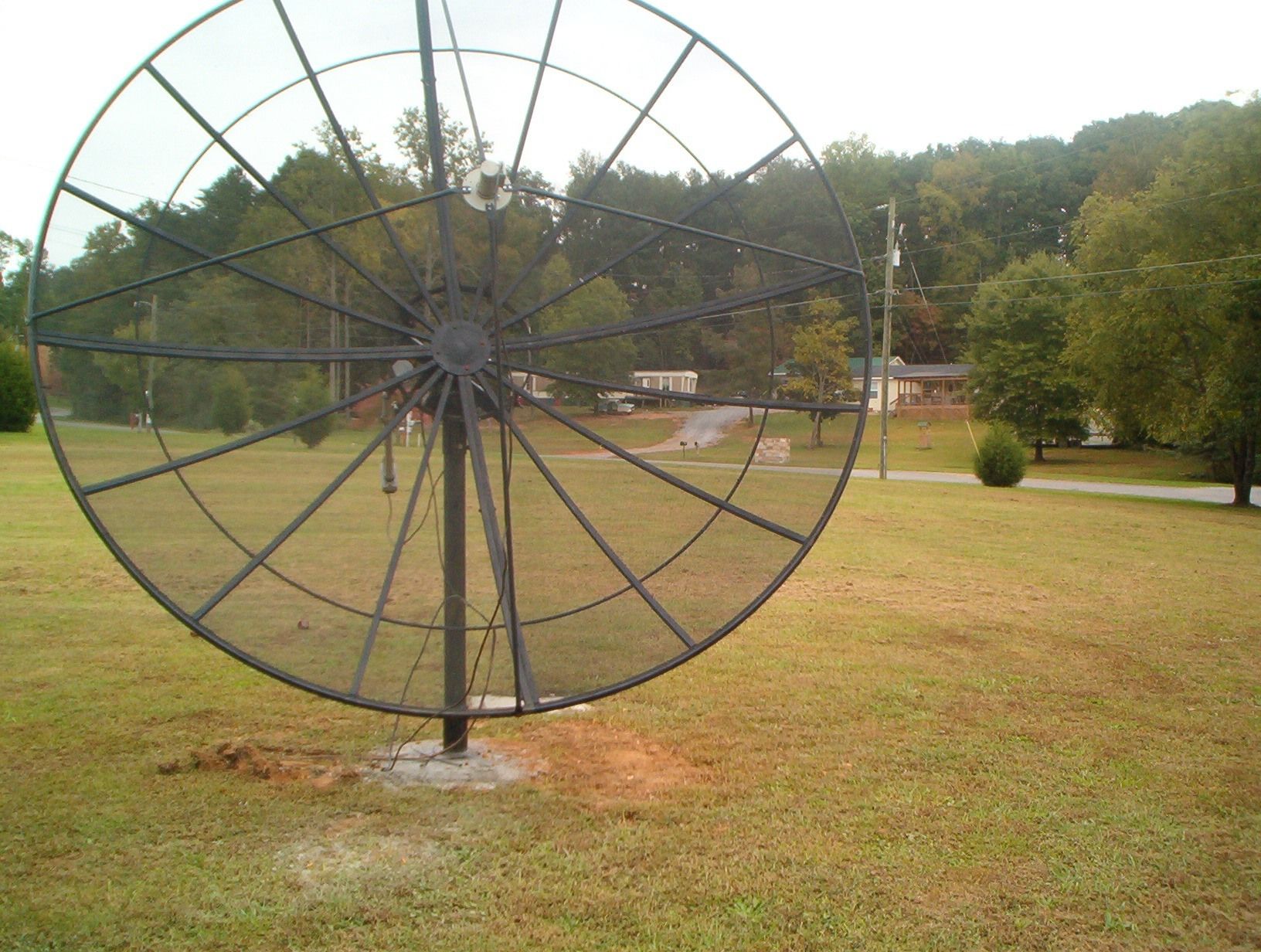

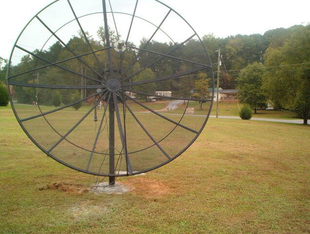

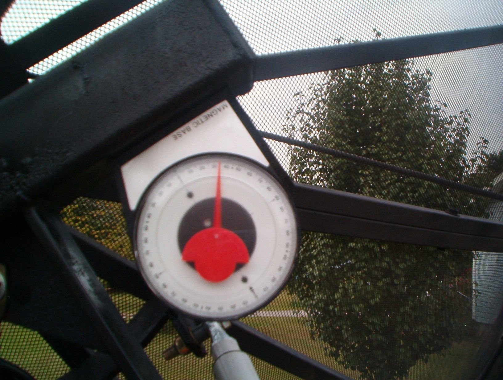

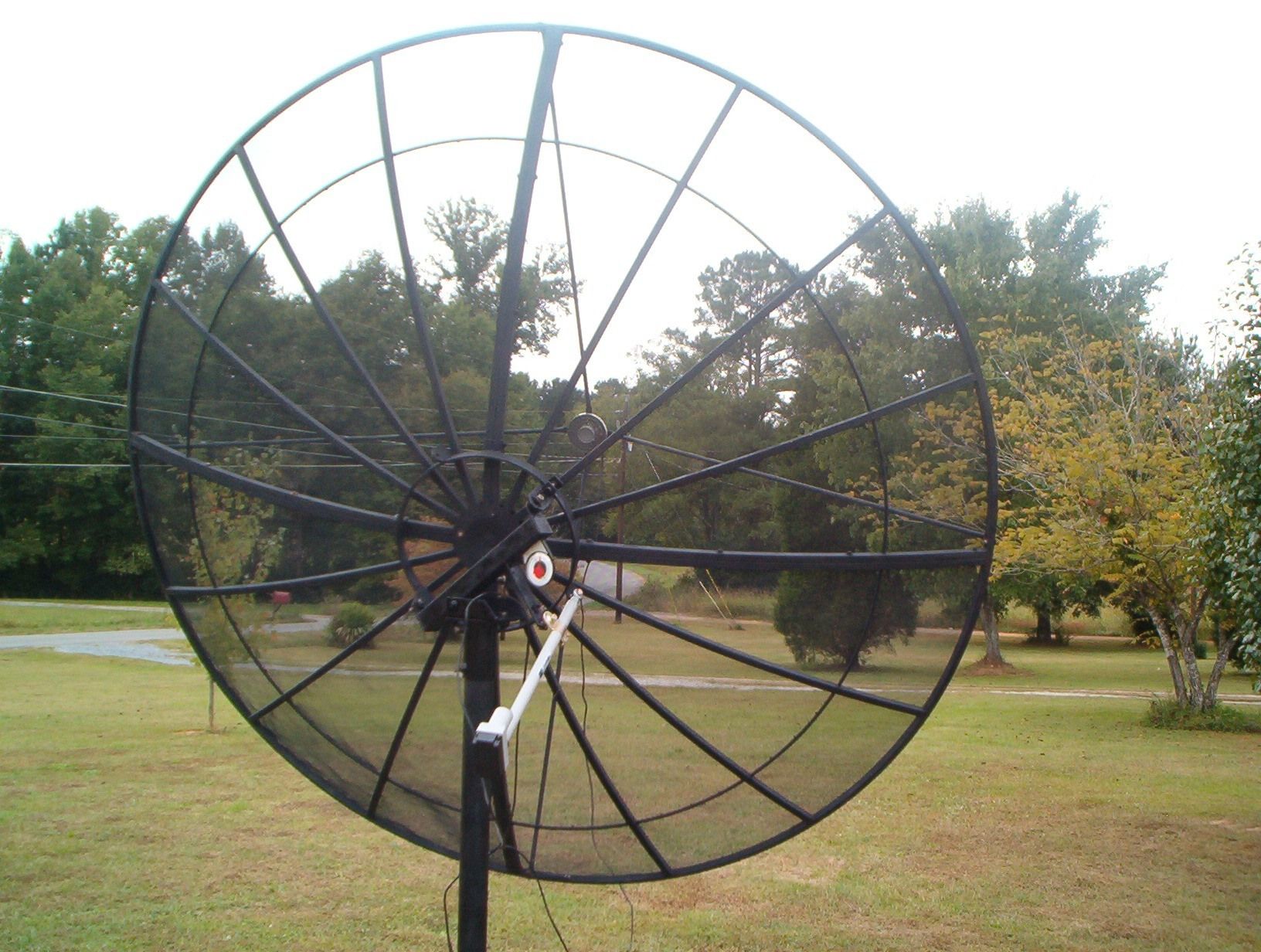

i took down my 6 ft dish and put up my 10 ft channel master. i only moved this dish 6 miles so ele and dec was already set.i had no problem when i set up my 6 footer getting signal but i cannot get nothing on this one no signal at all using a sathawk 4000 meter.it had a chaparral feed horn on it and was set at 46"from dish i am using a dmx741 i set at 46" also to start but i have moved it in and out trying to get signal. is a 10 ft dish harder to set up than a 6 ft dish. ialso ajusted my elevation up and down trying to get a signal i donot know what to do next.:confused:
here is pictures of dish

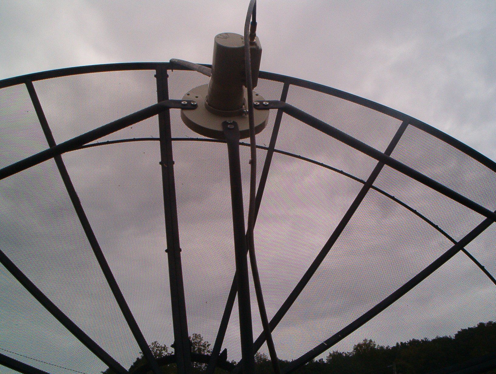

The LNB in the Pic does not look like a "DMX741" C/Ku Combo LNBF, looks like a C Band only LNBF.
Did you properly set the LNBF's Skew?
If your in Georgia, picture 005.JPG makes it look like your elevation is low to the horizon.
That must not be your true south satellite, it looks like the dish is swung to the west.
yea it a dmx241 the same lnbf that was on the 6 footer.
elevation was set when i moved it but i have double checked it and it is right on.

In your picture 002.JPG Your lnbf is not skewed to zero, on a motorized dish it should be set that way, use the marks on the lnbf to put the zero straight up.
Also it looks to me your dish is swung all the way west, you can't properly set the elevation that way.
Your actuator is fully contracted, it should be mid travel for your true south sat.
