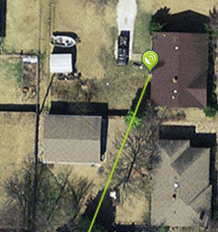

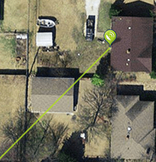

The installer may be correct about a possible LOS issue where the current Dish is at now. E* vs D*
The first image is D* that slightly goes through the tree. The image is over three years old so that tree has grown. The second image is E* and doesn't touch the tree yet, but is slowly approaching the LOS.
This is assuming I need 99, 101 & 103 for D*.

99, 101 and 103 are the main ones you definitely want.
Don't forget, the sat signal comes in MUCH higher than you would think.
It hits the reflector much higher and bounces into the LNB, not the other way around.
What I'm getting at is the angle that the LNB arm points is WAY low for where the signal comes in, alot of people look at the arm for height.
I might purchase the dishpointer app on my wifes iphone and take a gander.
