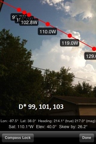

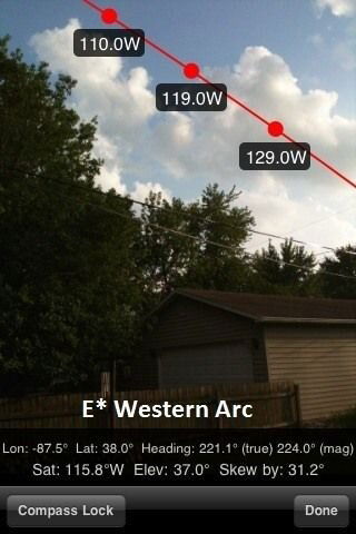

I finally got around to downloading the dishpointer app on my wife's iphone. The installer said one satellite came directly through a tree where my current dish is at. I believe he is wrong as all three are above the tree.
I have attached some pictures of the app for both my current satellites with E* and D* 99, 101 & 103 which I think are the satellites I will need LOS for. Would I possibly need a different satellite in place of one of those? It's obvious at some point the trees will be an issue, but I think it should be ok for two years if they put the dish on the roof.
Any idea what the clearance over the trees is? D* says 5 degrees of separation between LOS and any obstructions (up/down/left/right) . Local HSP wants 10 degrees.
No, I haven't a clue. Hoping its enough to get service.
Hmm do you have a chainsaw?? :)
Yup. Pretty sweet little application Dish pointer made
I was just wondering, because when the dish is set up, if you look at the LNB arm, you'll find that the sat signal comes in MUCH higher than the arm.
But if thats accurate, then I would think that it is taking in the difference.
