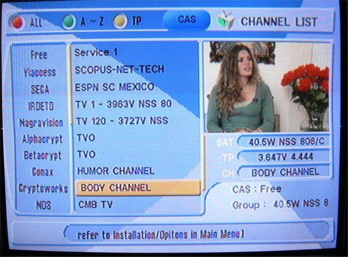

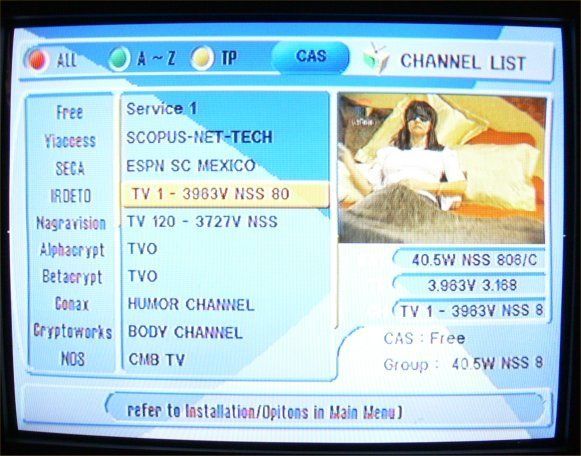

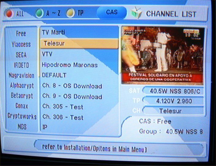

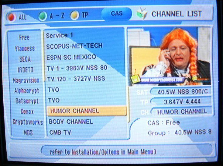

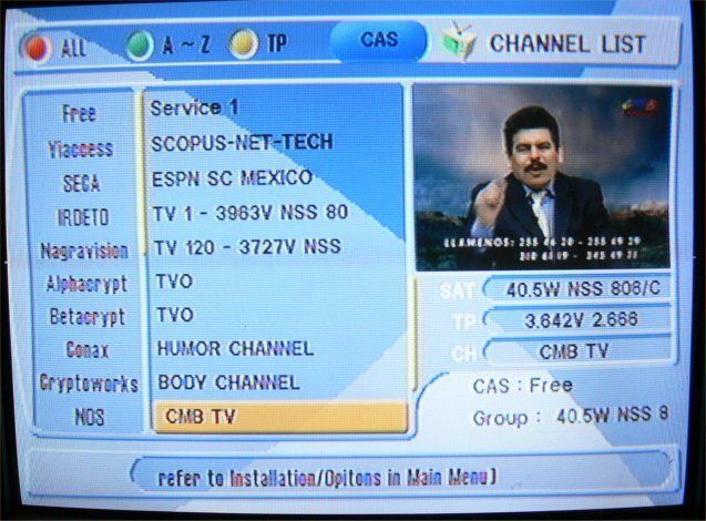

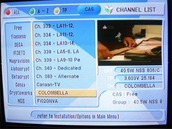

I have a 6.0 ft Winegard mash dish on NSS 806 .
A C-Band feed horne with a dielectric plate and it works good.

I hope the OP found some of the channels he was looking for in the small group I posted.
