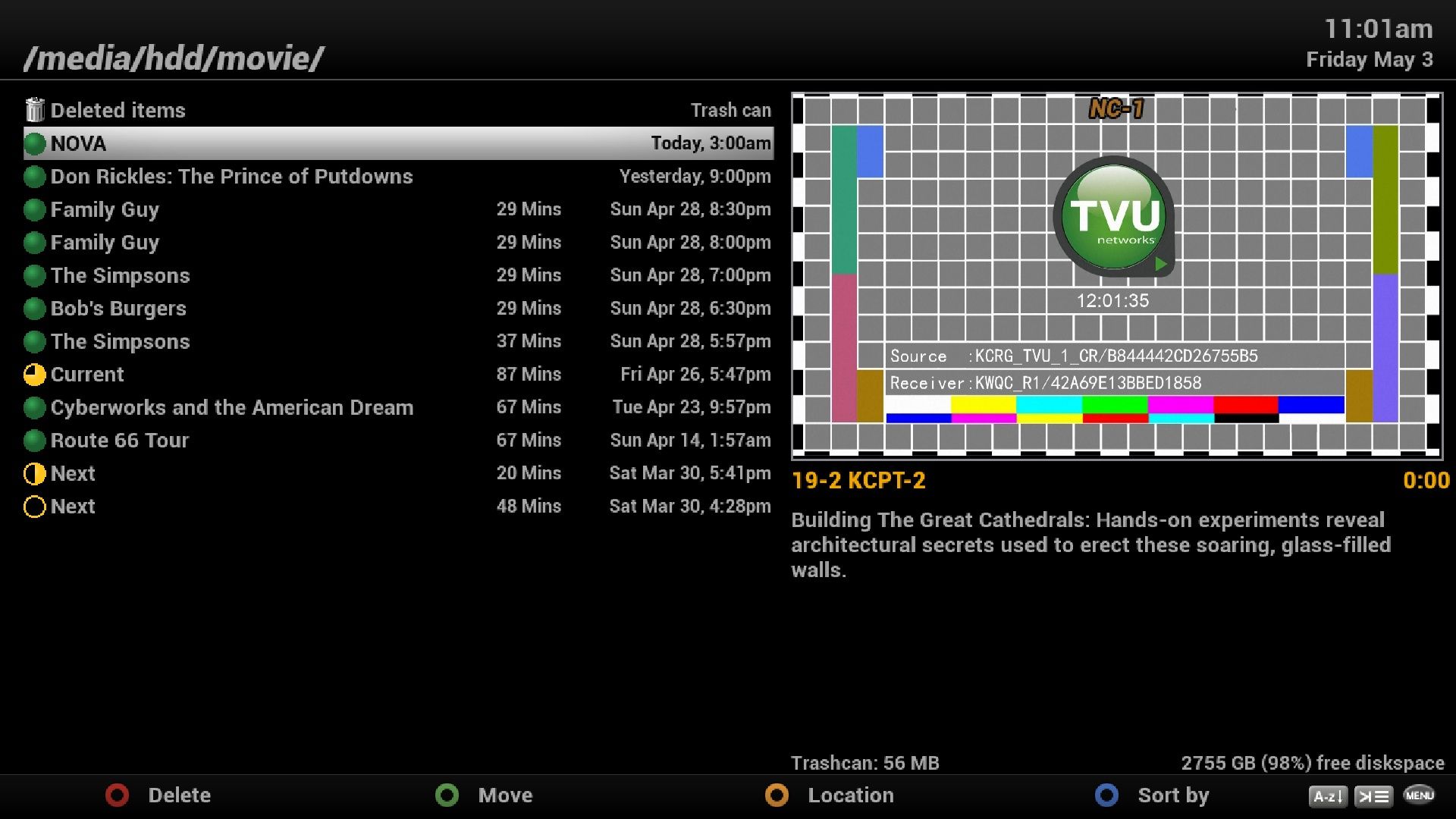

Currently running the latest version of OpenVIX. For the past few days, timers I've set show that a program was recorded, and it appears in the PVR menu, but the event is empty. No minutes were recorded. You can see by the attached screenshot that previous recordings show the length in minutes, where these recent recordings don't show any time information. The other odd thing is that I watched the display during the recording from 9:00-10:00 PM last night and it said REC and acted like it was recording, but the event is actually empty. Anybody have any suggestions?
You set both START and END times? Did you do it via the WebIF, or directly on the receiver? I set mine all by WebIF, though in NA SDGR image.
Not sure, I haven't done any recordings with that image as of yet. However, I'd try TWO things if it was me:
1: Do a FULL box restart
2: THEN when it comes back up, do JUST the Enigma2 restart.
See what happens after those.
If they don't work, my next step would be to post a thread on the OpenVix forum site and ask them.
