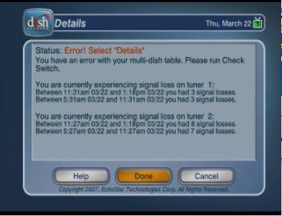

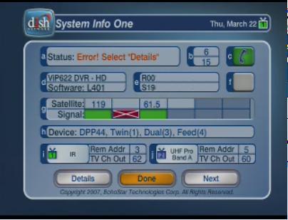

Ok another update sent to the beta team.
Just a further update, I went into the system info screen again (to see if there was anything new in the screens) and this time I got an ERROR message which I did not get the last handful of times I went in earlier. (see bug4.jpg and bug5.jpg)
However running check switch it is still not showing 110 on port 2.
My wife has left the house for another meeting, however I will leave my office early and will go home and will do the following…
1) Unplug power from the 622 for 5 minutes
2) I will check if 110 is working on the other receivers
3) I will check the Dish with my Birddog meter and re-peak if needed.
4) If 110 is working on other receivers I will take the 622 and place it where the other receiver is, this will check if it's a cable or DPP separator issue.
I will then report my findings to you when I have them. I will leave my office at 3:45pm eastern time.
Weather here in Connecticut is currently slightly overcast and the temperature is 39 degrees.
Scott out. :)
