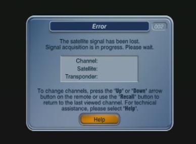

The screen went black and a few seconds later I saw a searching for signal screen, it checked different transponders and different satellites looking for a signal (I have 61.5, 110 and 119 using a DPP 44 switch with a DPP Separator to my 622)
After that I got an 002 screen, but the odd part of this screen was that the Channel, satellite and transponder information were BLANK (see the attached bug.jpg.)
Now trying to watch TV and I was getting a check switch error screen. However if I go back into the guide and select another channel I do get a picture. Once this happens all is well again and I can watch TV from any satellite or transponder.

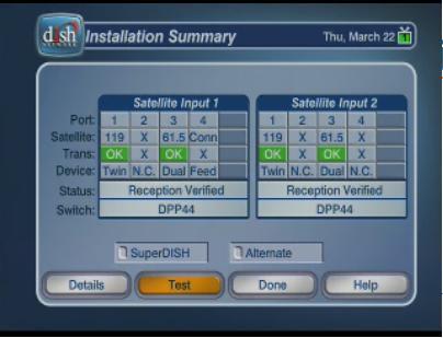

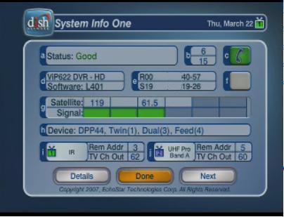

After this happening a few times I did go and did a check switch and now satellite 110 is missing, saying NC. Before doing the check switch I had 110 and in checking the strength on a few 110 transponders signals were in the high 80's (119 were all around 120) looks like my dish needs a slight tweak to 110) (see bug2.jpg attached) If I go into system info, I do see GREEN where the 110 connection should be. (see bug3.jpg attached)
Why is it green where 110 should be when it's not there? I also noticed without 110 (after running) check switch the customer service application is grayed out and I no longer have the Dish On Demand screen when hitting the DVR button instead I am taken directly into my DVR recordings.

the thing thats strange is on the 625 in the same room the system info screen shows it as GOOD and is showing 61.5 110 and 119 from the same switch.
When I get home I will also swap the 622 and 625 around and see if I have the same issue.
