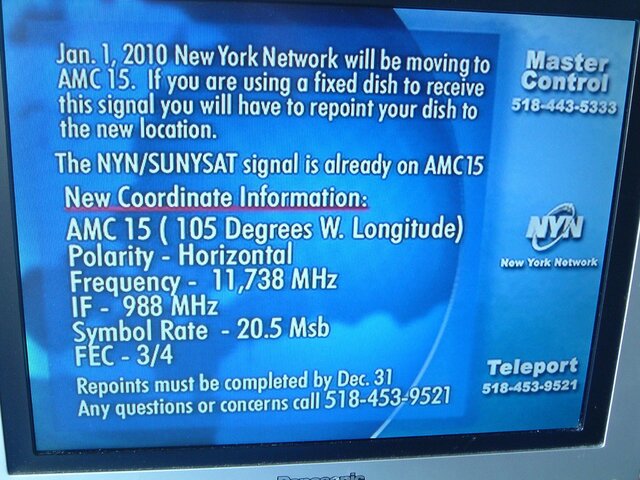

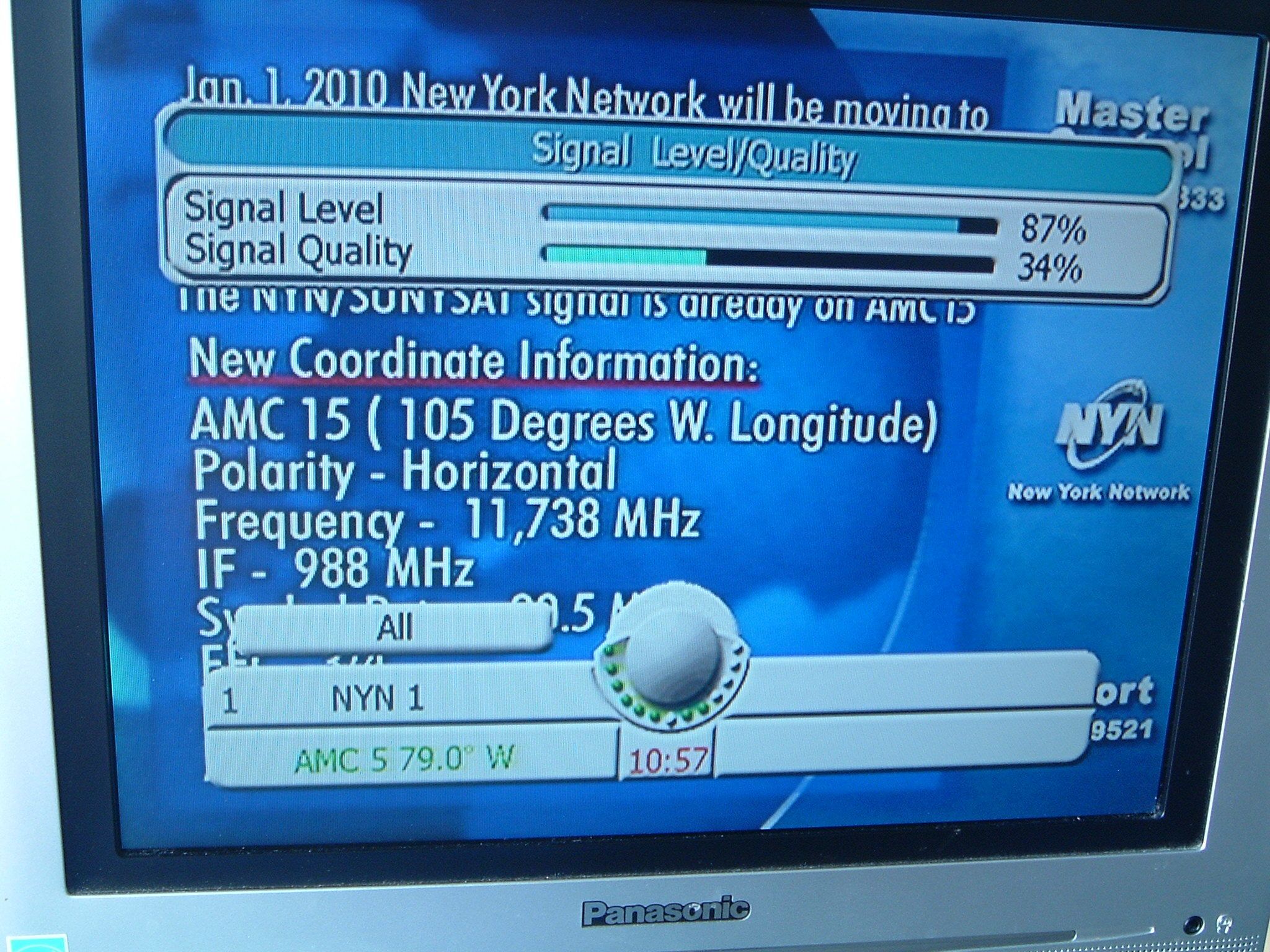

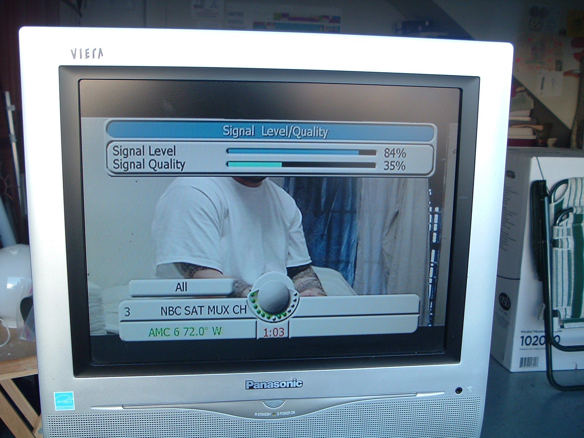

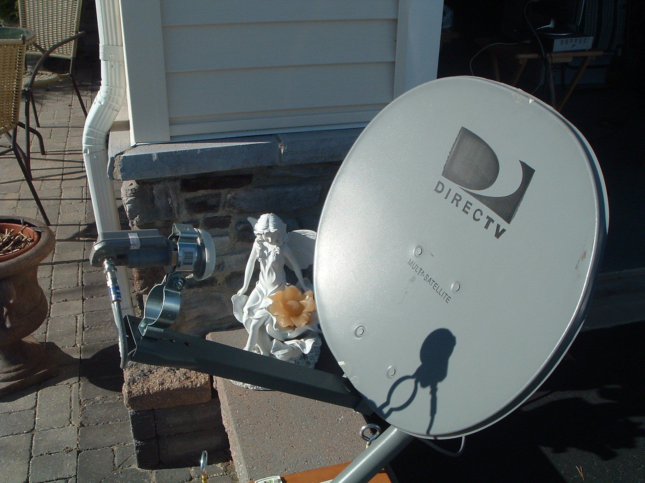

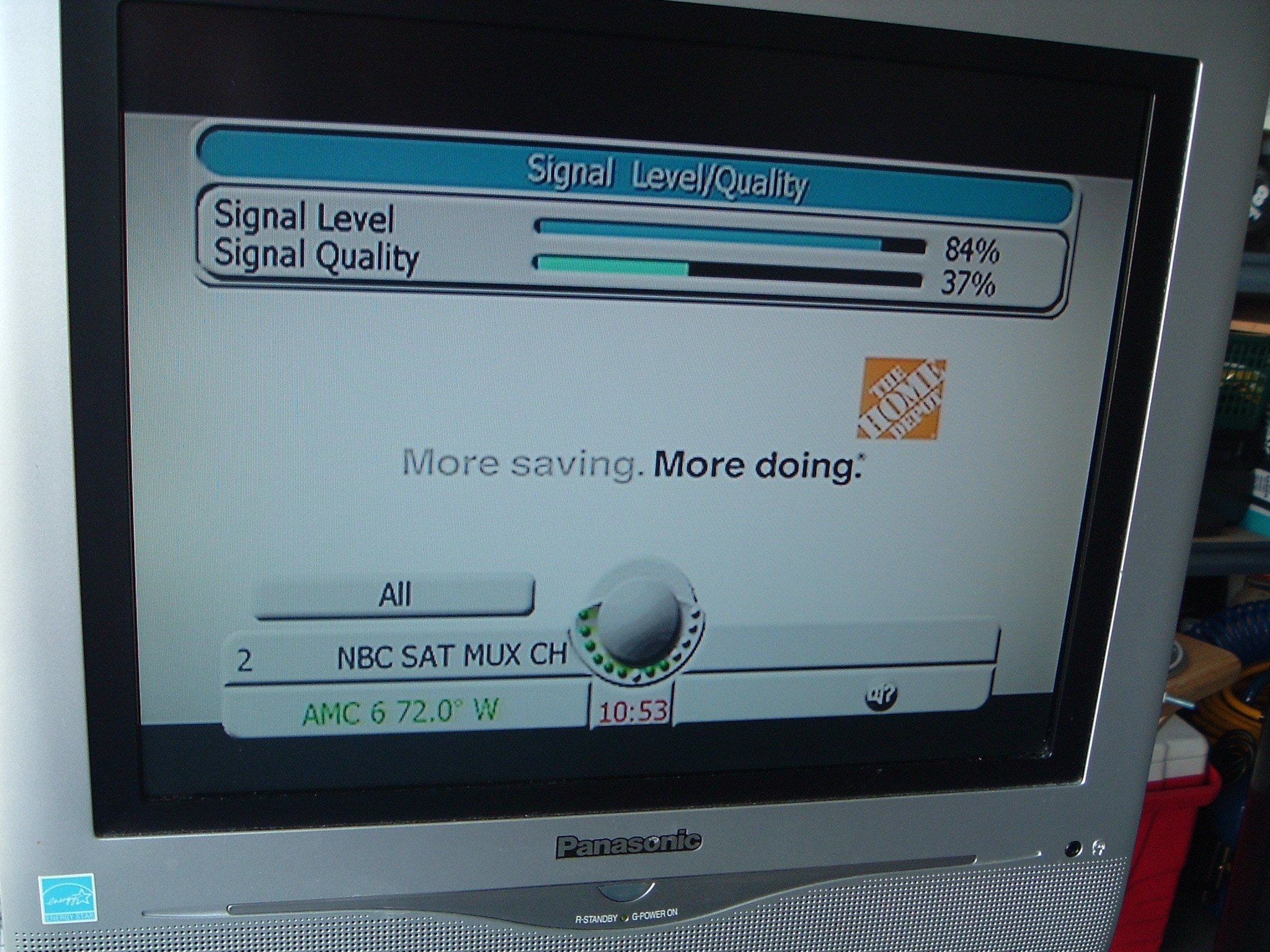

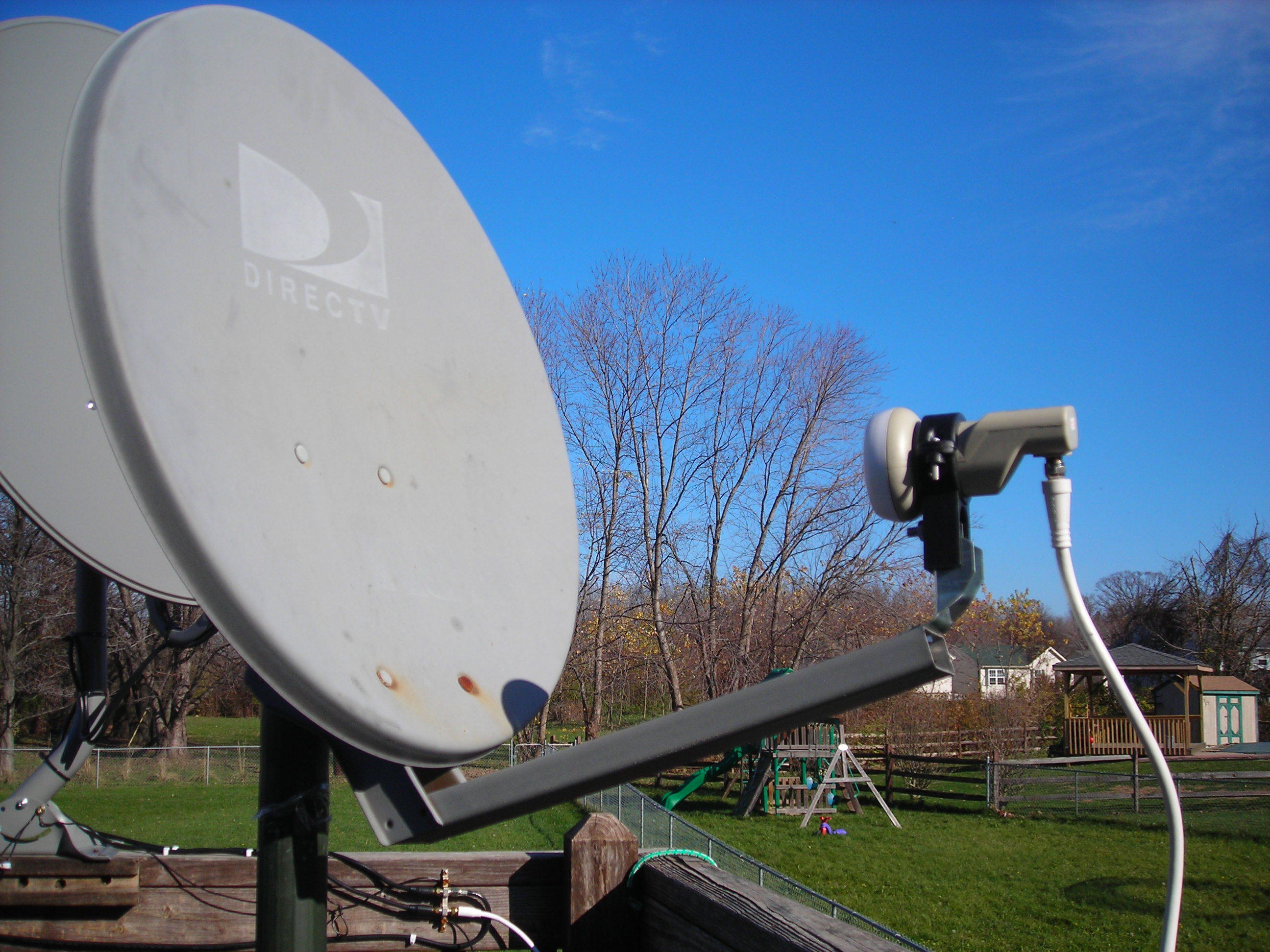

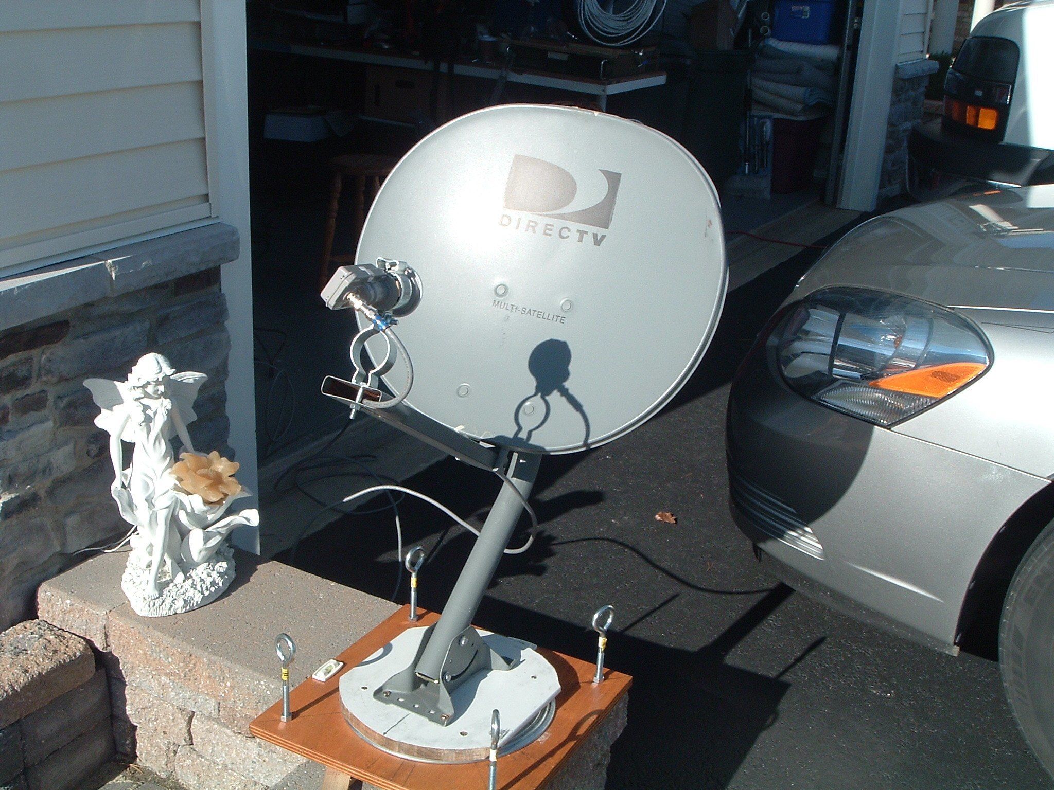

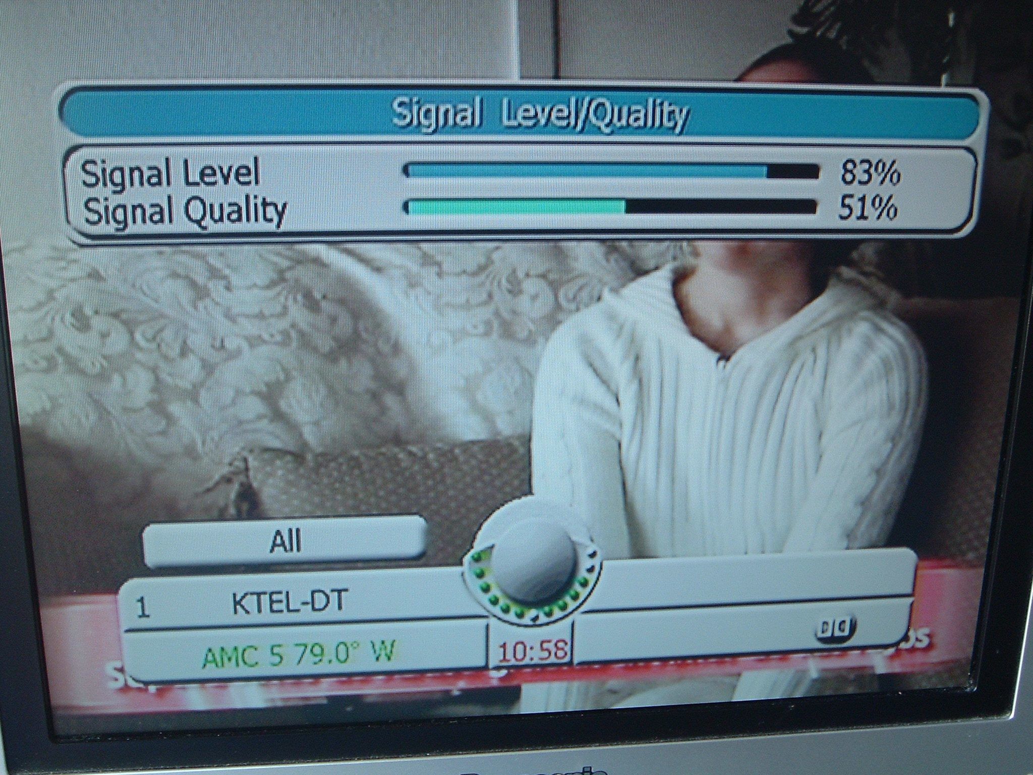

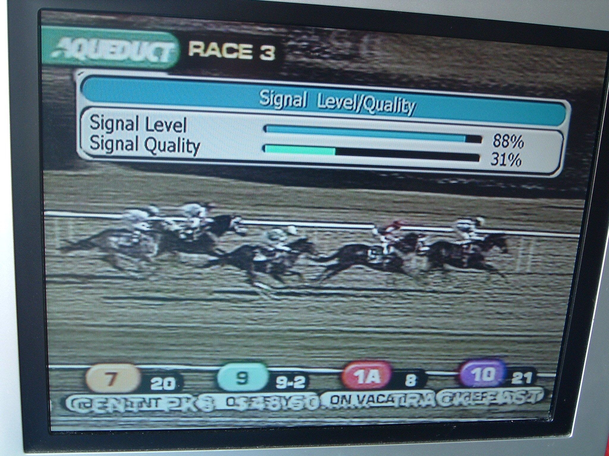

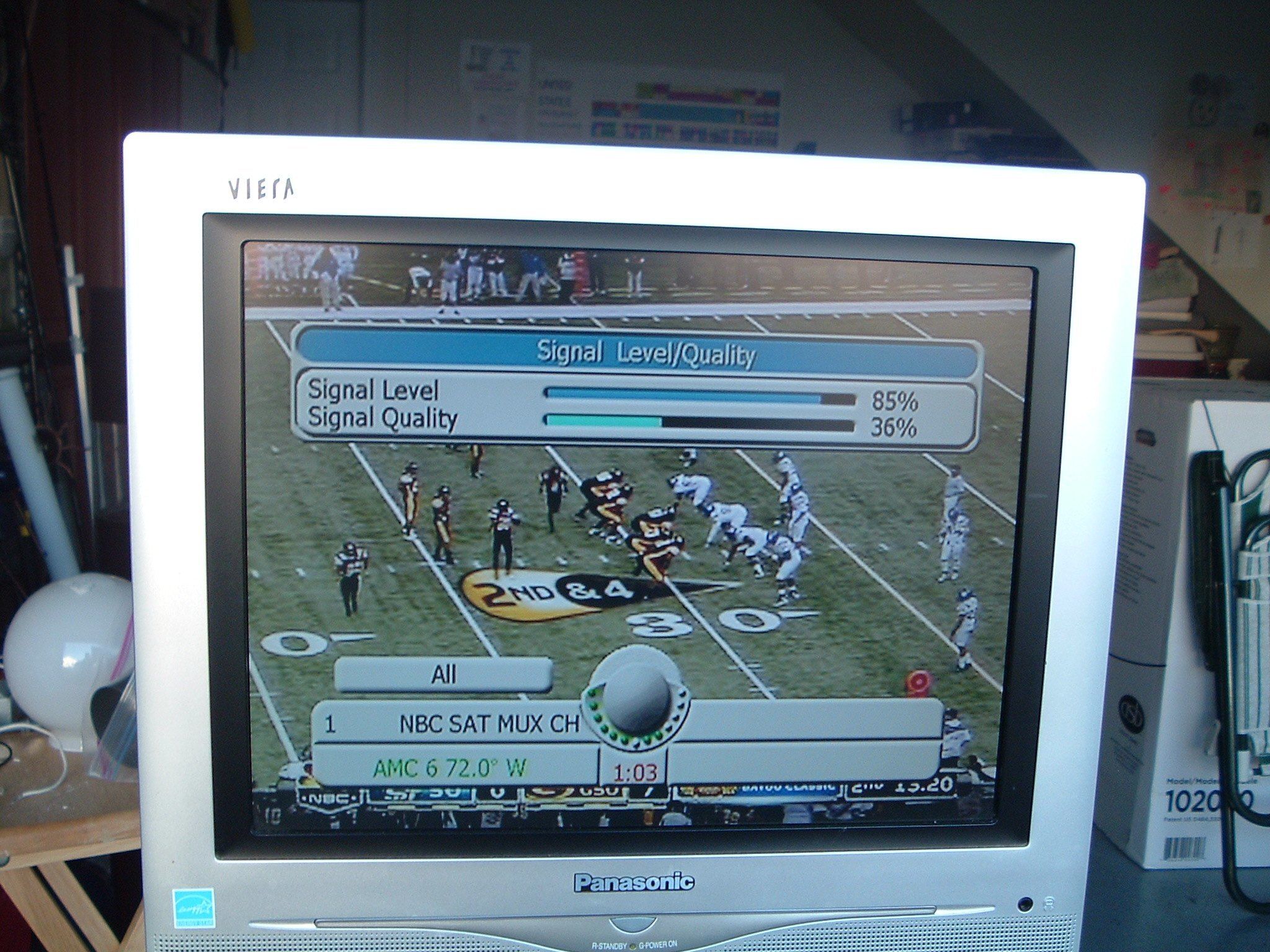

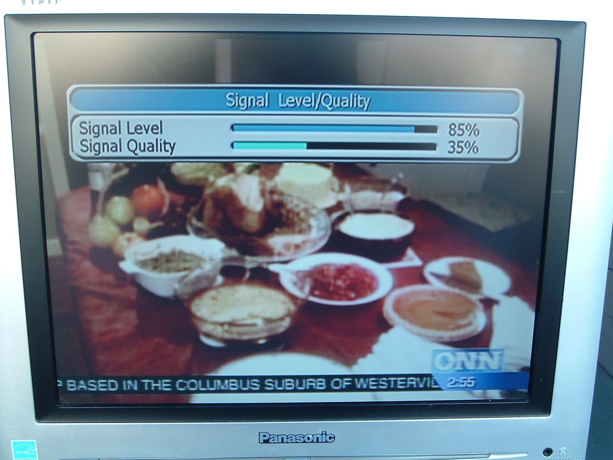

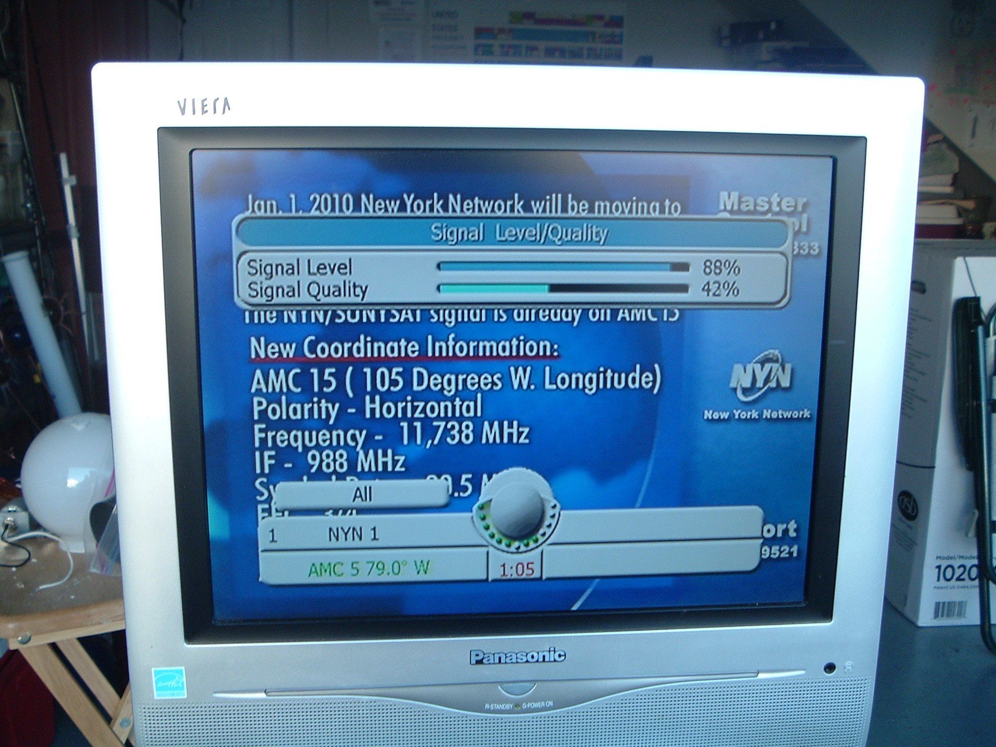

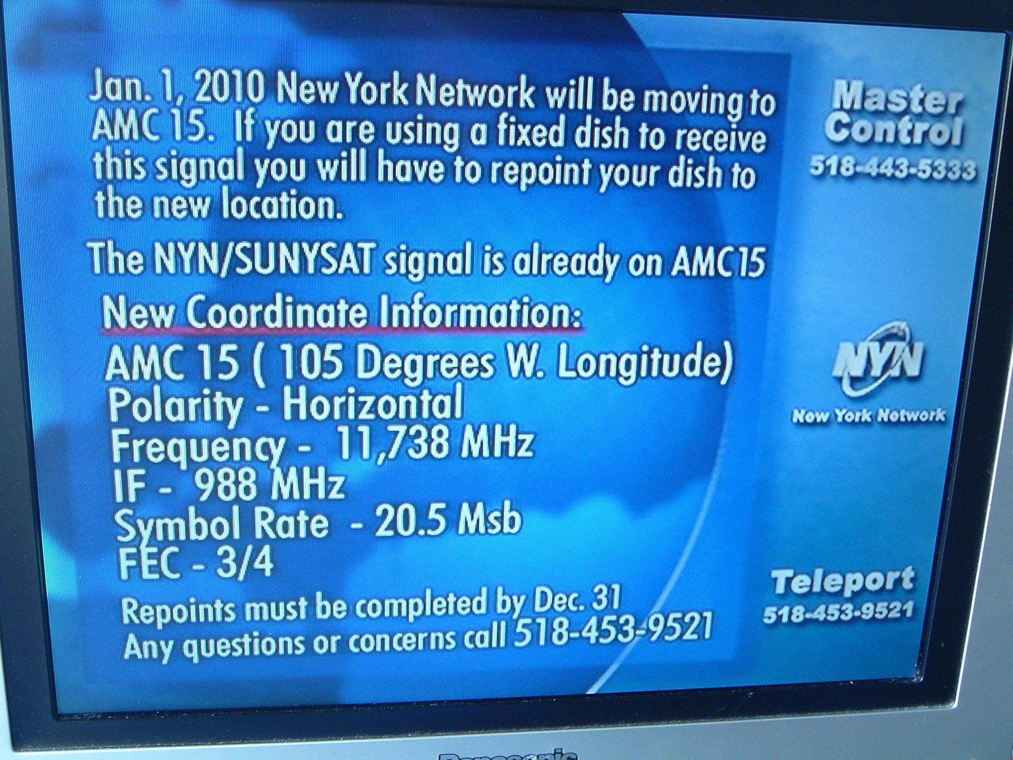

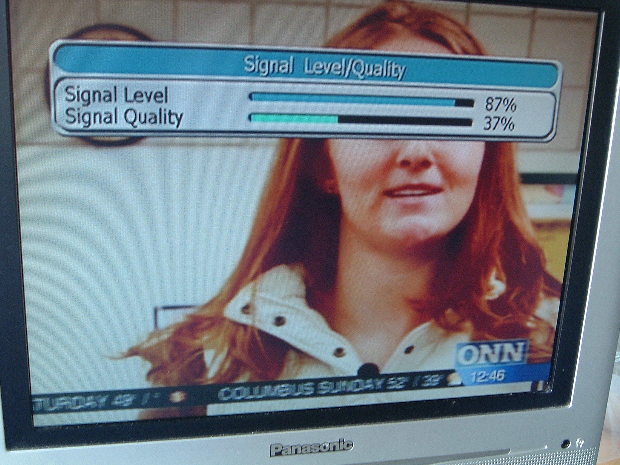

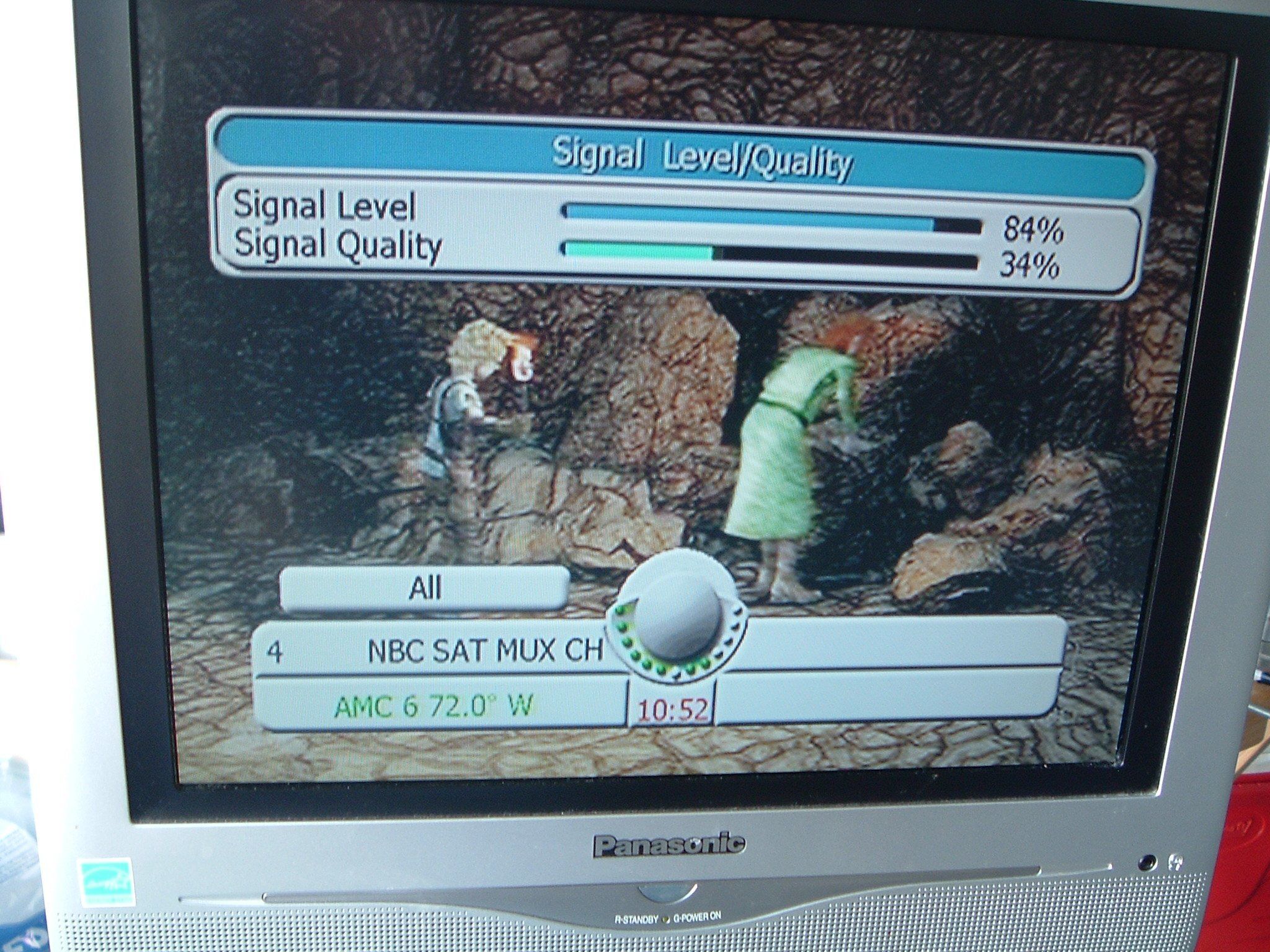

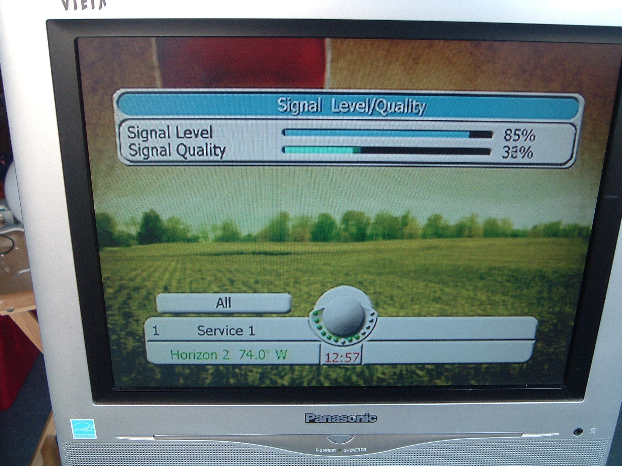

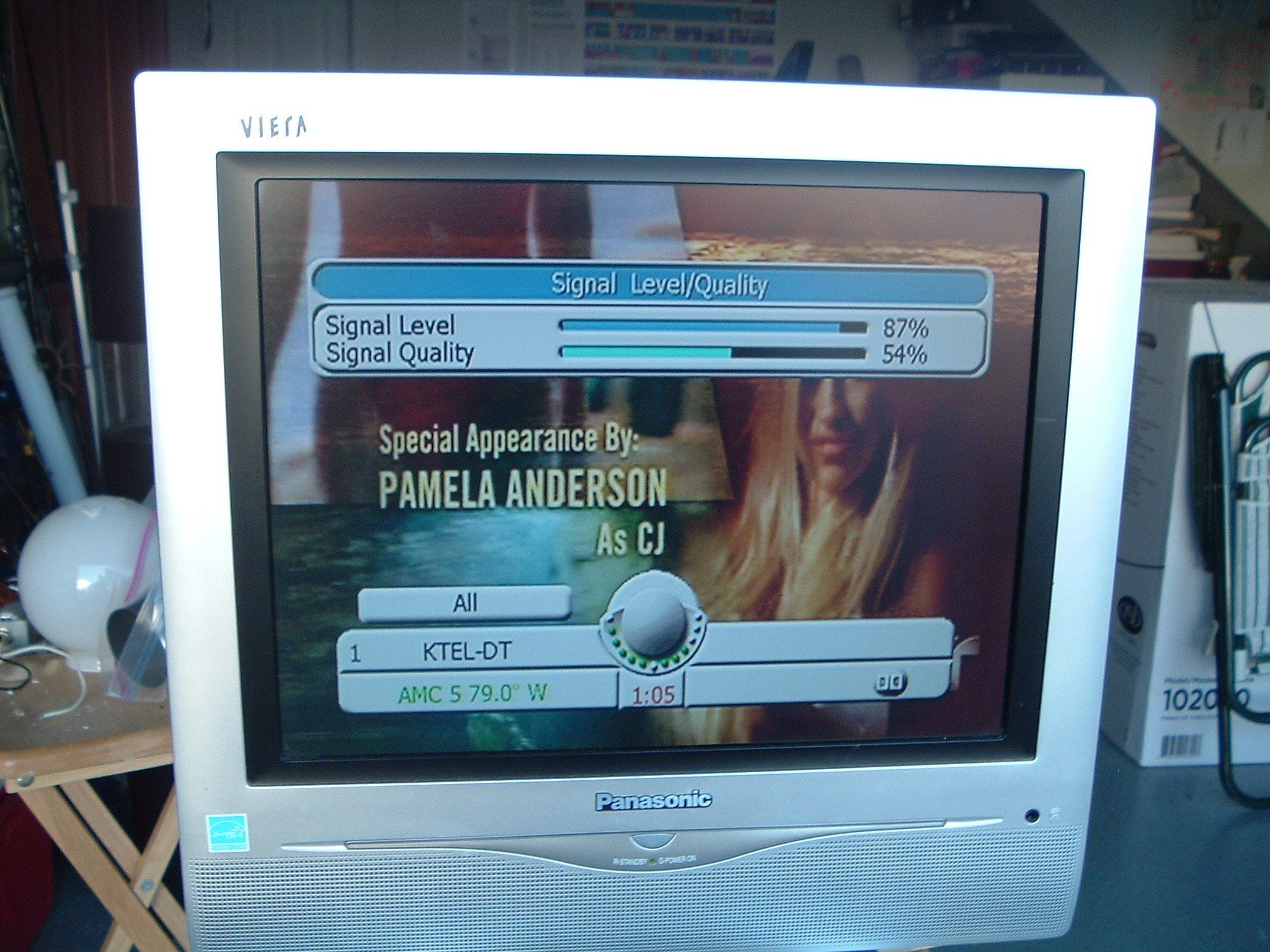

The weather was sunny and in the low 50ths here in lovely south New Jersey and I decided to break out the old 18x20 direct tv dish and see what I can get. I used the dish a Chapparral LNB and the receiver is the Fortec Dynamic. My TS sat is 74 west. Here are pics of the dish and SQ for 72, 74 and 79W.

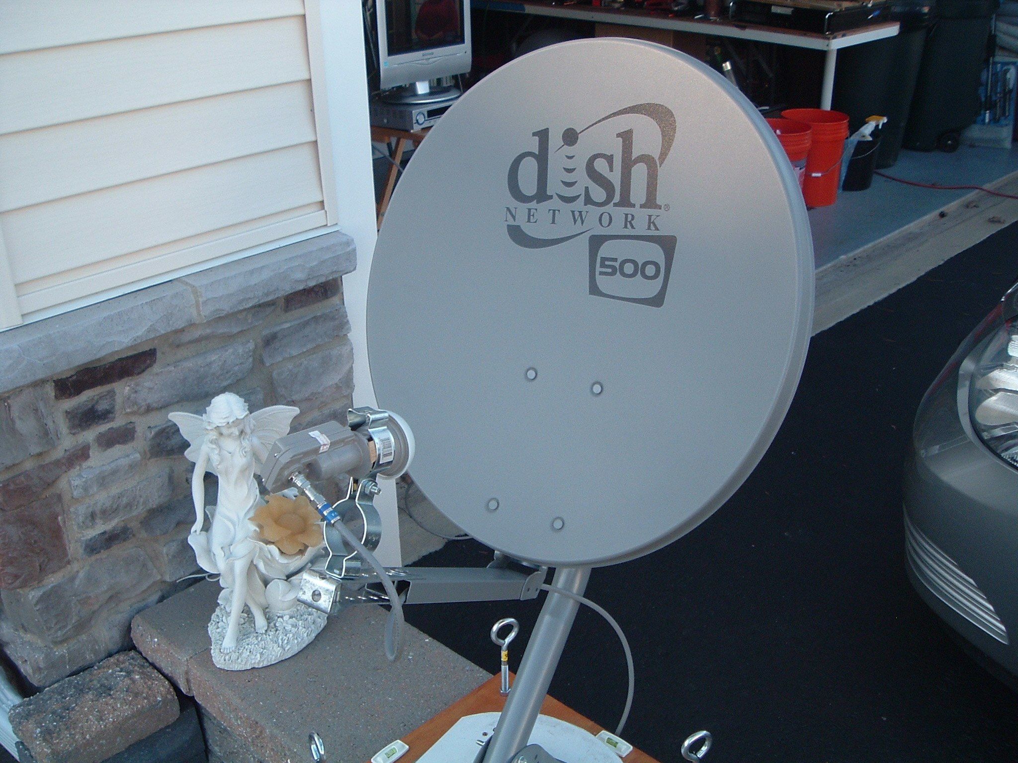

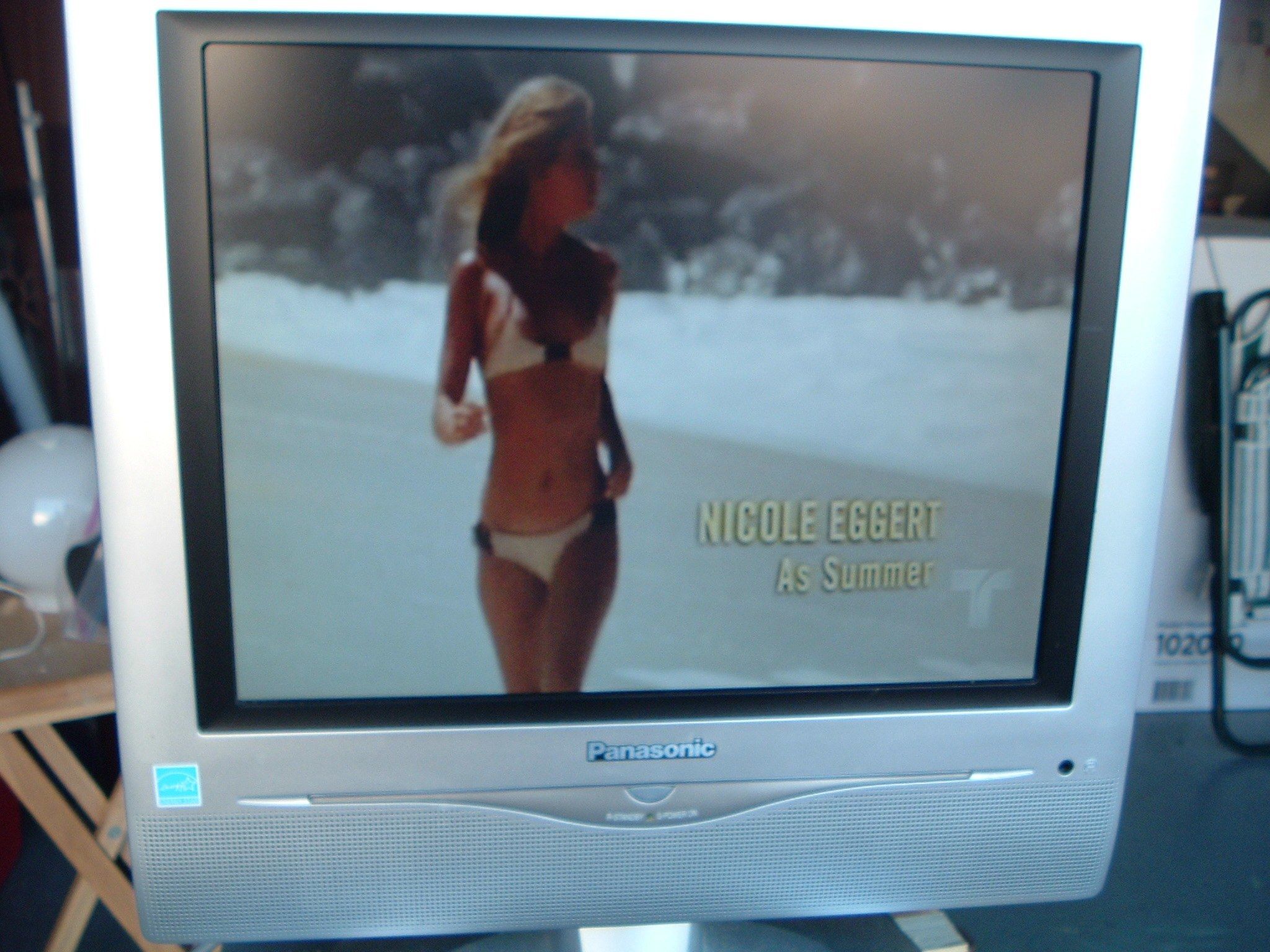

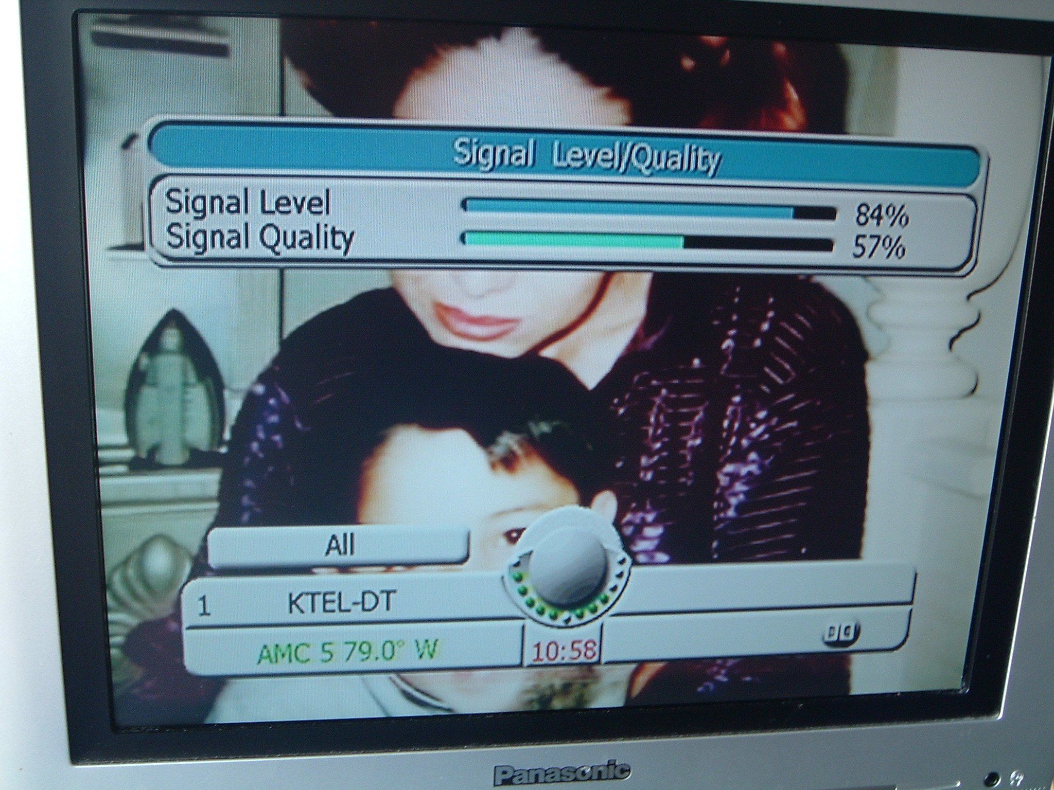

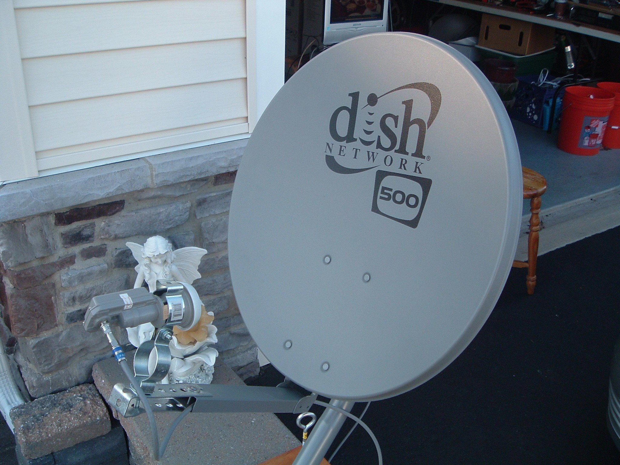

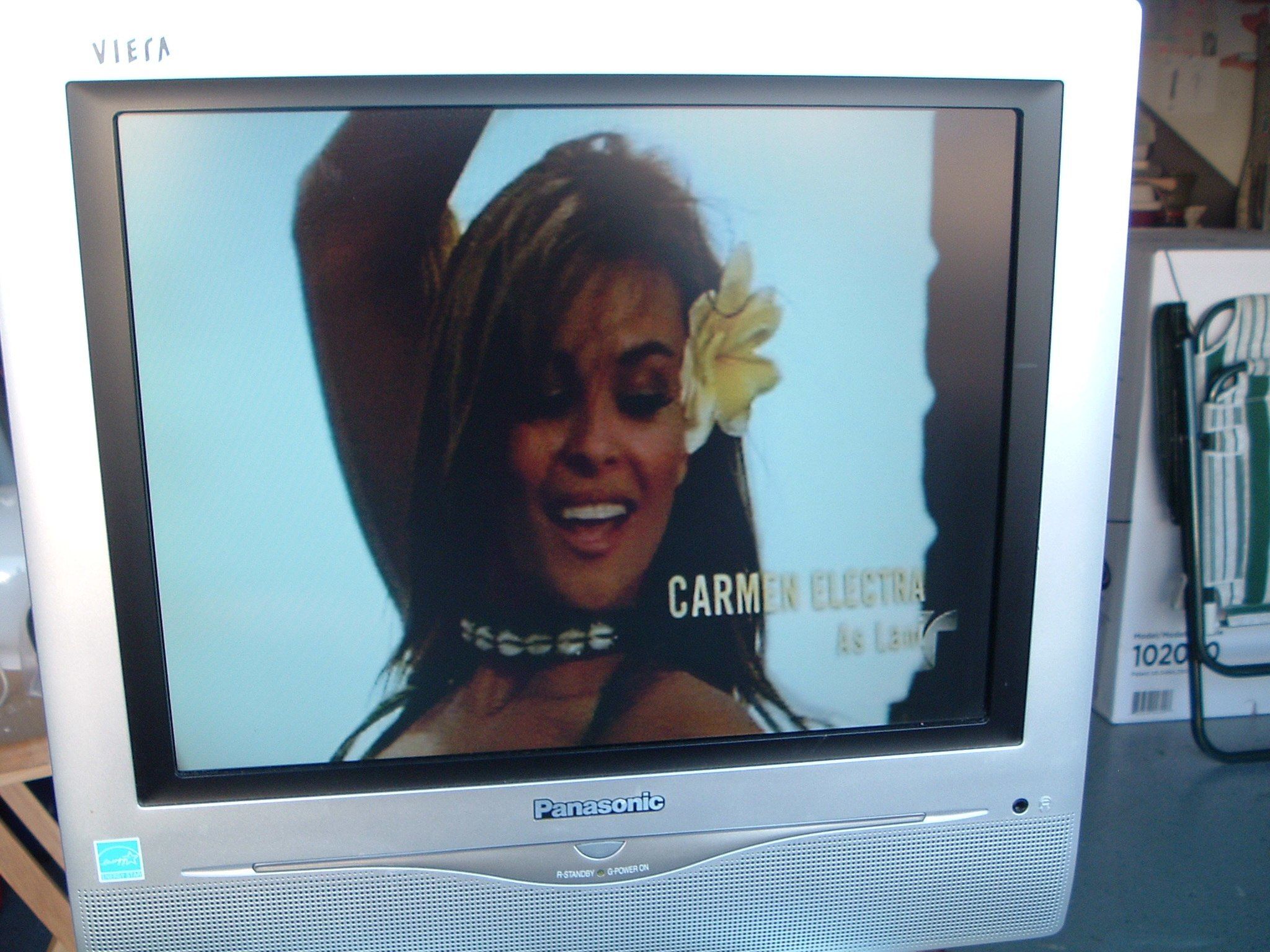

Here is the same setup using a 500 Dish.
Can you guess what program is on KTEL?

ICE, your the man, It is Baywatch the Hawaiian Reunion, the whole intro was in English, when the program started they spoke in Spanish.
Mike, thanks for GREAT pictures of the setup and reception with the two dishes.
Is the Dish 500 larger than 18"?
I been experimenting with a old 18" Direct TV dish with a Linear LNB and a bracket.
I see the bracket you are using seems higher up than the one I am using. I could do some modifications and push the LNB higher.
Does that make a difference?
