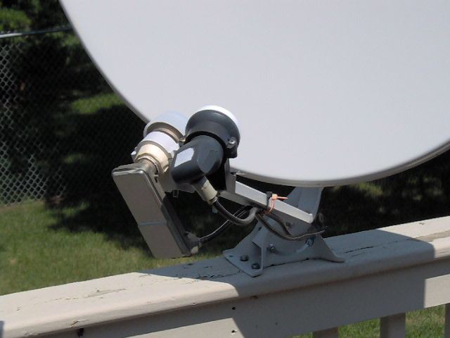

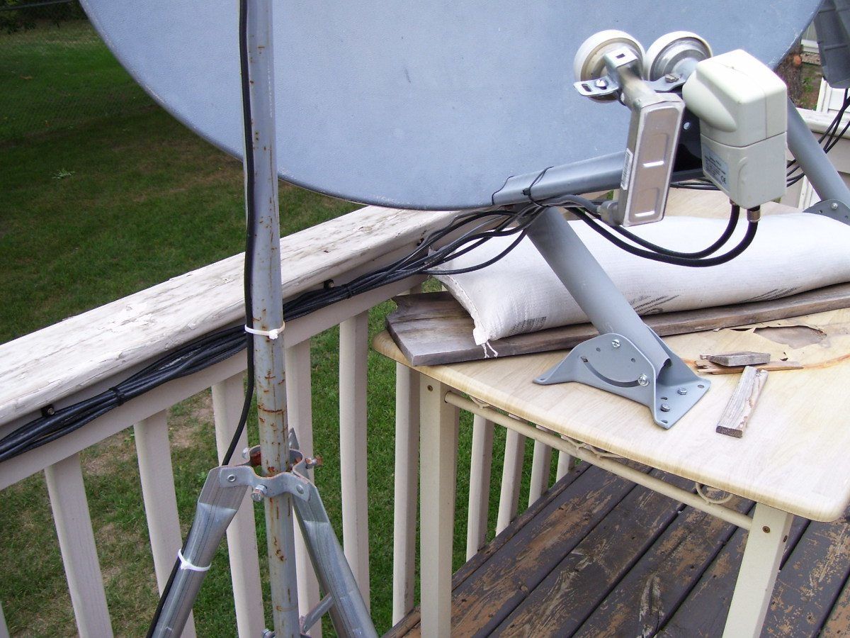

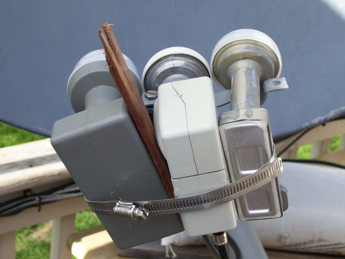

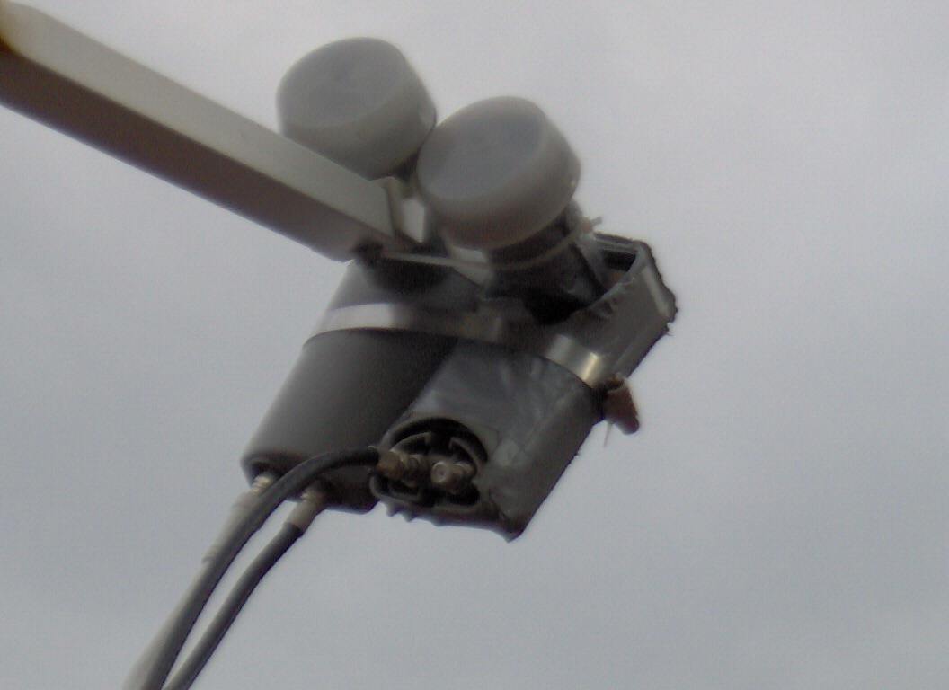

some various pics
1. 119/123/129
rest are various 119/123 setups I've had

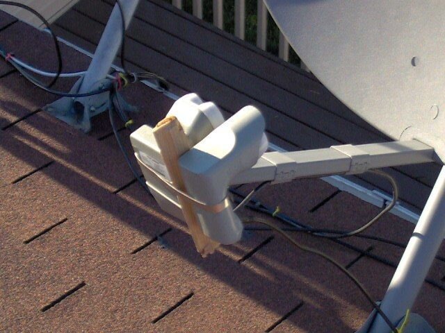

here was another one
119 LNB added to a Starchoice (107.3/111.1 dish)...with piece of wood as a spacer
wood & hose clamps are my specialty :D
