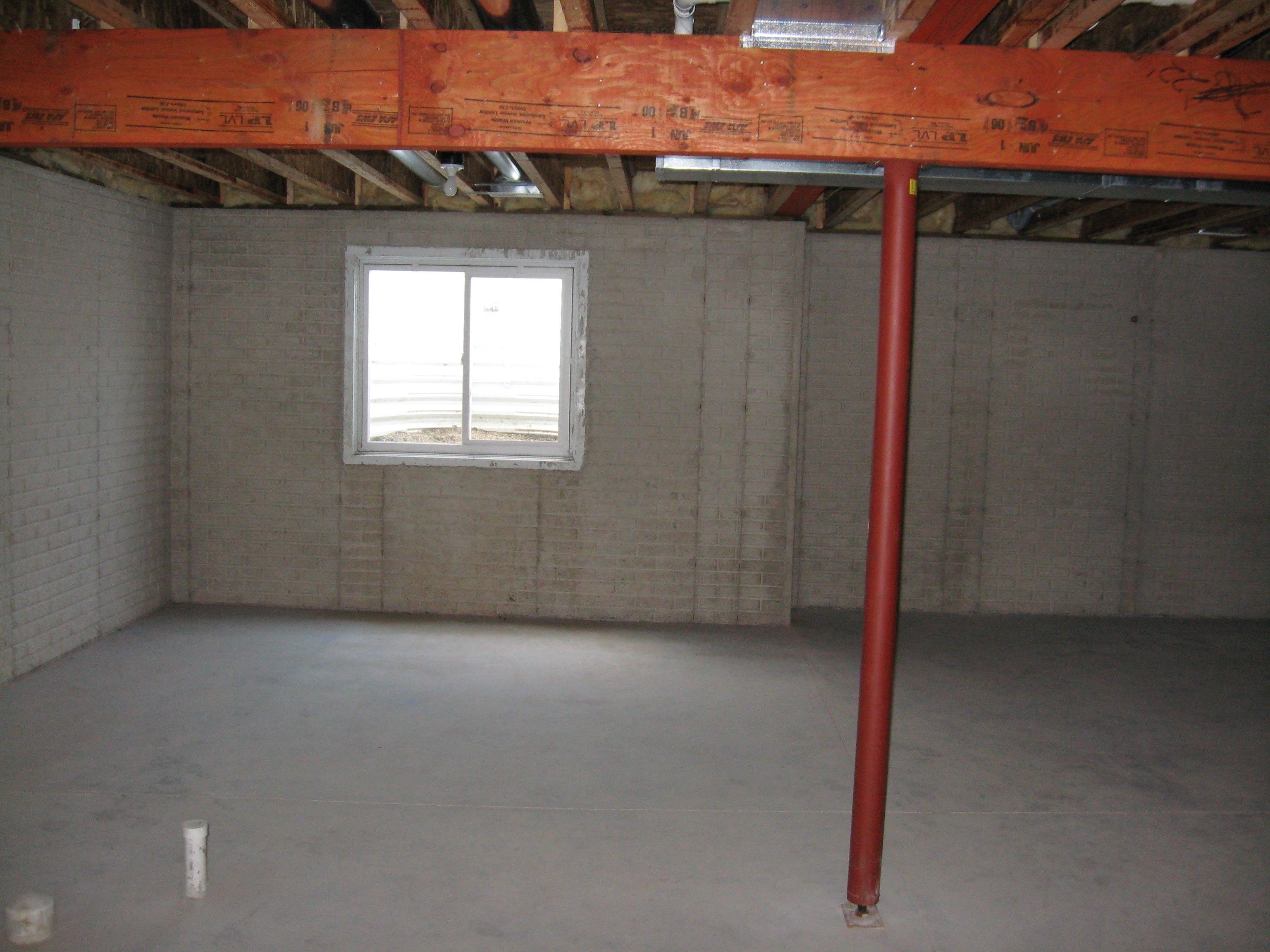

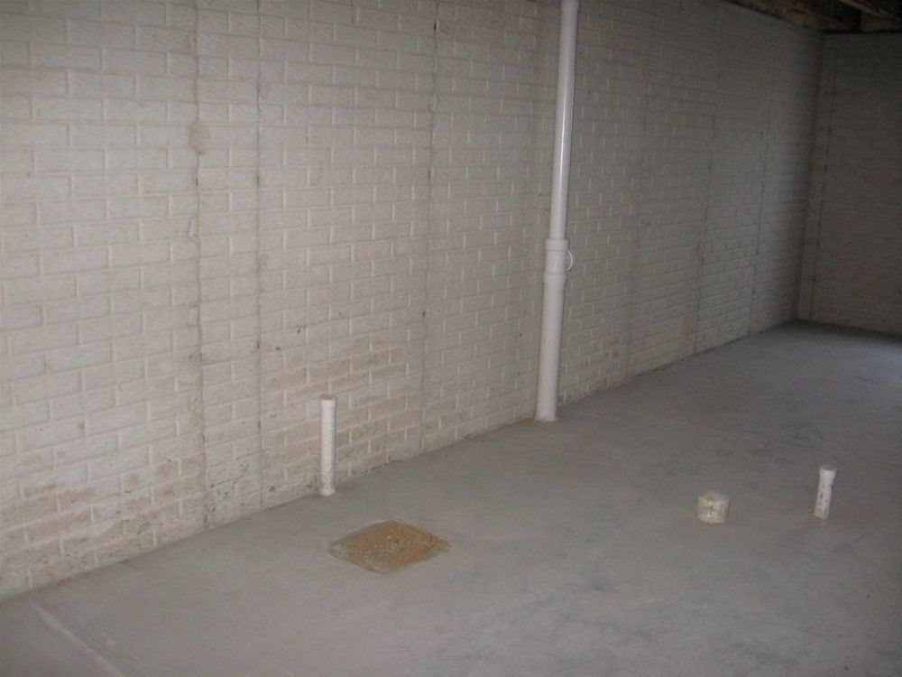

I am staring at these plans and struggling to see how I could get 25x11 given the need to have the bathroom somewhat near the middle. I only have two photos of part of the basement right now; I am attaching them. it shows the rough-in for the shower and the bathroom stuff. It looks like the bathroom PVC is about in the middle, and thus the wall of the bathroom could be just on the other side of that, and push towards the future room.
But if I did that, would that be big enough for the theater?
I wish the rough in for the bathroom was NOT where it is. It makes design more difficult.

I am staring at these plans and struggling to see how I could get 25x11...
That was an estimate assuming you can move it completely into the corner, where the bedroom is now.
BTW, this isn't too hard.
I did move mine about 6 feet: opening the cement floor (about 1-2" thick), attach sewer pipes, patch the floor. Took one weekend, doing alone.
Yours will be twice as long. Don't know your basement building codes, could be different from Canadian.
But from the picture it looks just like our basement when unfinished.

You have the bath shifted all the way into the future bdrm but if you shift it just halfway, enough to give you 3 more feet in the theater room, then bring the theater/bath wall out to the stairs and put a door in near the stairs, although odd shaped at the stairs end, you would have a room 12 feet or so wide and the triangular corner behind the stairs would give you an area to put your media shelves and equipment. Put your seats up by the stairs with their backs to the stairs facing the wall that is labelled 15' 1/4".
