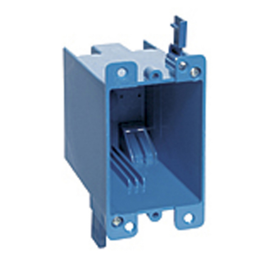

To do it 'right', you need to rip out a section of wallboard, nail in a new box, drill a hole in the floor, wire it and then re-drywall, spackle and paint.
However, they do make a junction box that is designed to go into existing drywall. You cut a rectangular hole, drill the hole in the floor, string the wire, and then place the junction box in from the front. The two mounting screws let wings expand and tighten down the box from behind. Here is a picture. Note the wing and the screw in the upper right. http://images.lowes.com/product/034481/034481124030.jpg
