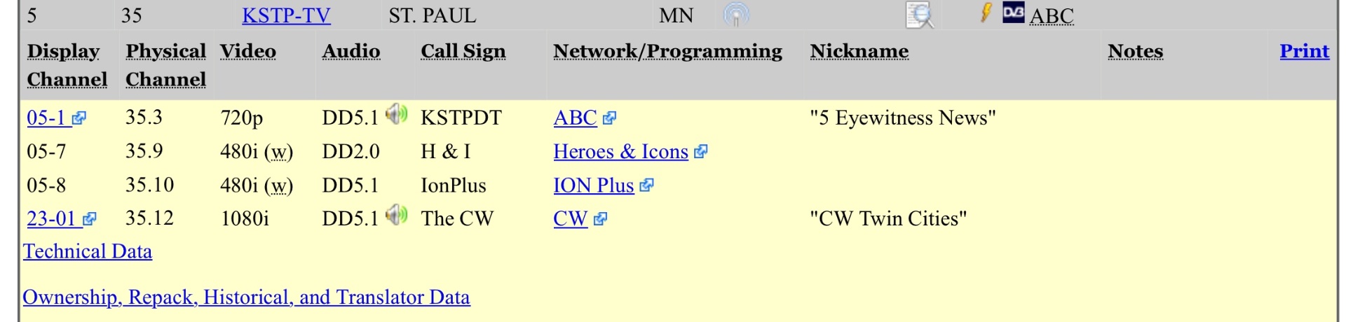

That started when Sinclair decided to use WUCW's OTA signal for ATSC 3.0 so a couple years ago.
The stations that were on that station got broken up to other OTA stations in Minneapolis. CW (WUCW) is on KSTP's signal (RF 35). Sounds like dish needs to remap it to the correct channel portion (35.12) and not the main station (35.3)

looking at rabbitears site I see what happened
WTTK 29 (the RF station) is ATSC 3.0 so the stations that were carried on there before ATSC 3.0 had to be split across other stations.
29-1 is on the same RF station as 59-1. So what it sounds like Dish is doing is mapping it to the wrong RF info. So for CBS it should be "mapped" (on the Dish internal side) as 22.7 but if its the same info as FOX they're mapping it to 22.3

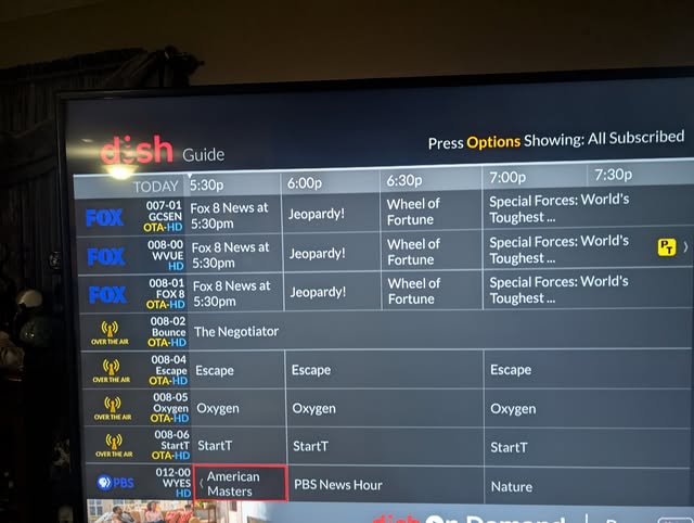

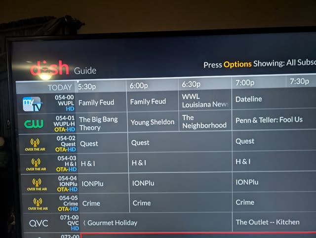

Dish's whole ota guide listings are terrible. Here in new Orleans, we have On channel 007-01 The gulf coast sports entertainment network shows the guide info for 008-01 Fox 8 WVUE. Also 054-01 WUPL ( MYNETWORK TV ) is showing the guide data for 038-01 WNOL THE CW . If i disconnect my antenna and plug it straight into the TV, my TV has the correct psip data on both, so it is a problem somewhere on dish's end? There are other mismatched problems but these are the 2 main ones.
