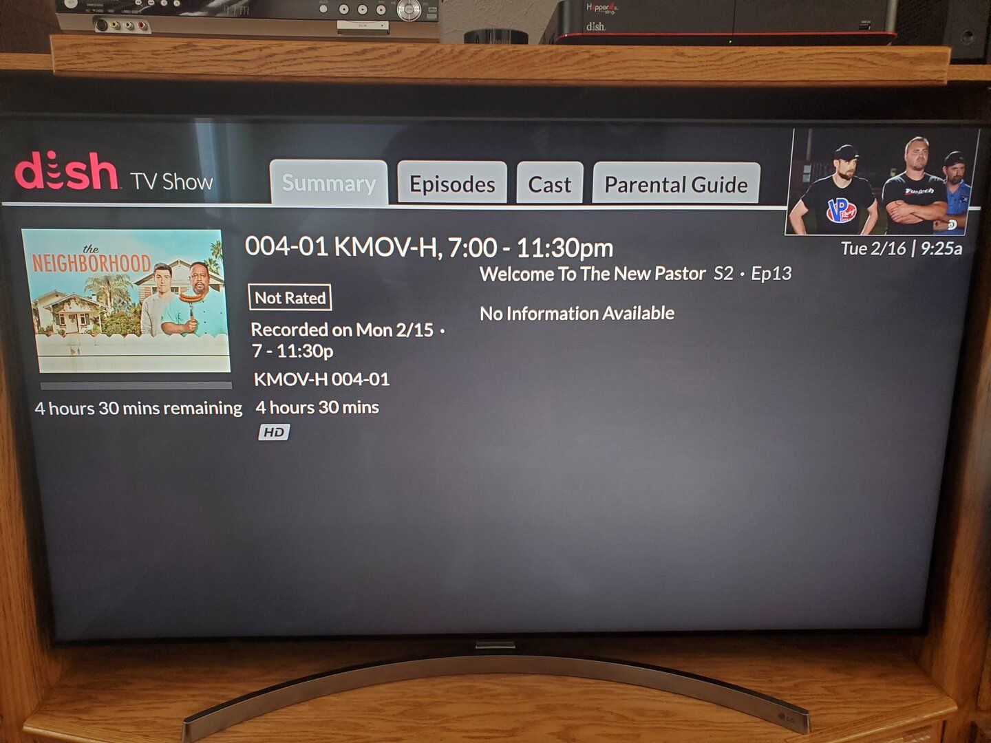

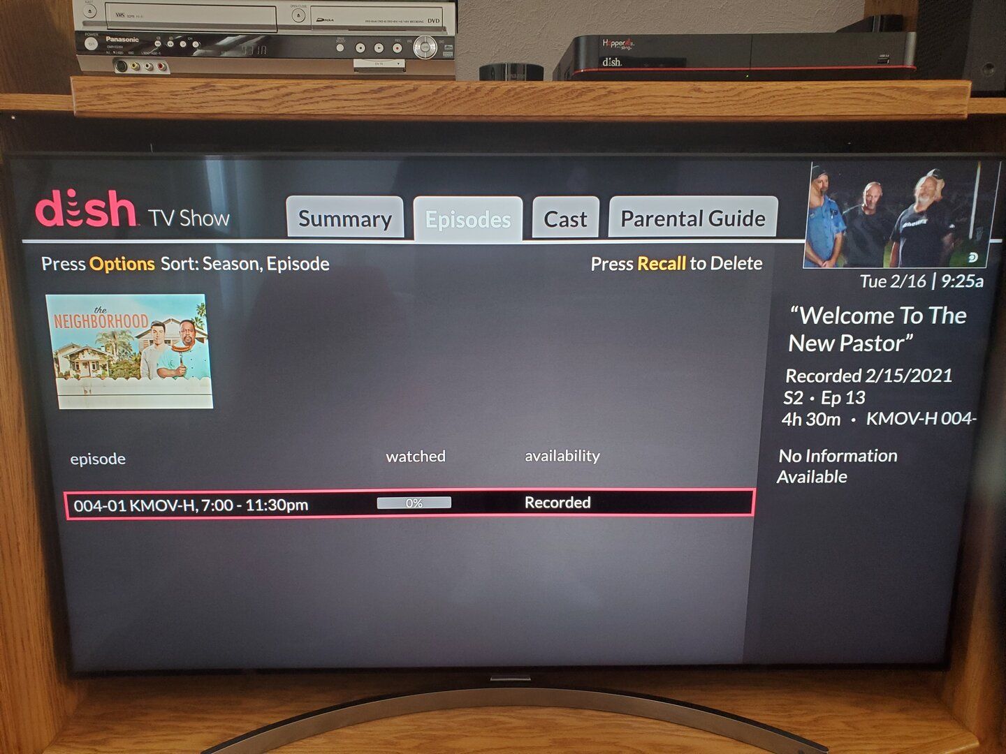

I have OTA created timers that will not play. When I select the recording in my Recordings folder I do not get a play button. This started happening a couple of weeks ago for a created timer and I thought it was a one-time issue. Then Sunday I created an OTA timer for the Daytona race and it happened again. So I set up several test OTA created timers in both my Hopper 3s and it happened several times in both DVRs. Some test did work. Performed a pull the cord reboot and still have issue. Anyone have an idea what is going on?

I also did the manual timer for Daytona via local OTA Fox and ran into the same thing as you when I tried to select it to play it. In my case, hitting the play button on the remote did start the recording, though. Been so long since I did a manual timer, I thought perhaps that was a normal "glitch" that I had forgotten about.
I rechecked my OTA created timer programs that don't work and I can't get the play button to work too. So that is good yours are half A-- working DWS44. I have several OTA manual timers set for this evening. I will report back in the morning on how goes it. I am checking the odd ball channels too. It appears for now, the issue is happening on the FOX and CBS channels only. Really strange. Makes me wonder how that could happen! Secret bugs from the affiliates!! LOL

Thanks dweber. Can you run two more test? One for OTA FOX and one for OTA CBS. I rarely use the manual timer too. When I see a racing event having weather issues I will use a manual timer and stretch it out a long time. When I checked in on the NASCAR Daytona race Sunday it was having weather issues. So I set a manual timer up. Good thing I checked in on the timer later on and discovered it was acting up. So I just went into the guide and set bunches of timers for about 6 hours of programs so we wouldn't miss the race.

Maybe PTAT has something to do with it. My timers did not fail to record or at least they were in my Recordings folder. But CBS and FOX recordings there was no way to play them. There was no play button when the recording was selected. Also pressing the play button on the remote control did not work too. I will post my test tomorrow.
