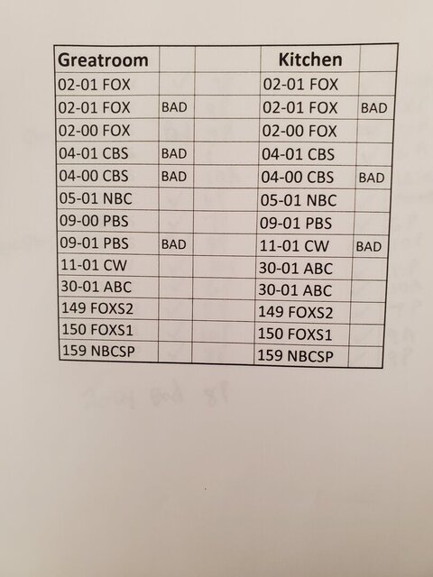

Performed a manual timer test for my two Hopper 3s. Did a blend of local and Sat channels. All the timer recordings showed up in my Recordings folder. Total of 7 recordings had no watch button when the recording was selected. However, 3 of them I was able to hit the Play button on the remote control and they then would play. As you can tell the issue is with the local channels, both OTA and Sat and not all PTAT. The issue is intermittent. Go figure. Let me know if you want any more test done. Wife is teaching school by Zoom so both Hopper 3s can be tested all day.
Are they the CBS and Fox that will not play or others also? Since it is both Sat and OTA if it is only CBS and FOX still that are having the problems it makes it sound like an encoding problem from them although I others are seeing it too. I would say it is something wrong with the delay they put in to be able to HOP channels or something?

If you look at my spreadsheet there is a PBS and a CW channel that had the issues too. I have an EHD connected to both Hopper 3s but I have already deleted the recordings. I will do some more test and the programs that are acting up I will move to the EHD to see how goes it.
I couldn't open the spreadsheet - my browser problem not your post....
