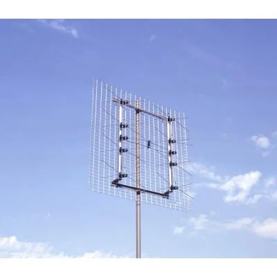

i found this one good if your hD is UHF range up to 60 miles and it's not so big or noticible on the roof
I'm glad you went back to your old avitar.
