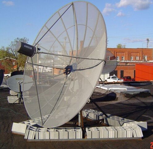

Out with the bad, in with the hopefully better. :)
I took the spun aluminum down yesterday, and it is ready for the recycler.
A friend came down this afternoon, and we put up the 10" Perfect 10 dish (sorry Al). It went up pretty smoothly considering we put it together from scratch.
I didn't paint it or even clean it. I just used all the new parts that I had and threw it up. We strung it in several places, and everything is perfect.
What a change when setting the F/D and Focal length. I set the F/D at .38 (specs say .375). The Focal Length according to the book I got with it is supposed to be EDIT 44-5/8" measured distance. The book also says the calculated distance is 45", so I am a little confused about the book, but it will be really simple to move it in a little if necessary.
There are a few hail dents in the mesh, but I'm not concerned about that. I can get new mesh panels locally if I want to go to the trouble.
Here is a pic right now. Will take more after getting it tuned in.
Here's hoping for better SQ!

Nice dish! I too am jealous of your roof.

I'm waiting to see a 15+ footer up there!

The building was originally built as a grocery store, so it was pretty much wide open when we got it except for two smaller rooms and a larger room in the very back of the building.
We use about 1200 sq ft for office space for my wife's accounting/tax business, and my computer business. Separate offices/repair room/showroom. :)
We have about 1800 sq ft for our living space. We live where we work, which leaves about 2500 sq ft of warehouse space divided into the rooms mentioned above, plus another 25 x 50 ft room.
It is all ours, so we don't share the roof with anyone. We live in a very small rural town, just a rock throw away from the next county where they have all kinds of zoning, restrictions and other kinds of government annoyances. In our county we don't have the above restrictions, and the town doesn't either, so I can pretty much do whatever I want. :D
Probably won't ever see anything bigger than a 12 footer up there, and maybe nothing bigger than a 10 foot. There are limitations, even for me. :eek:
Fred
