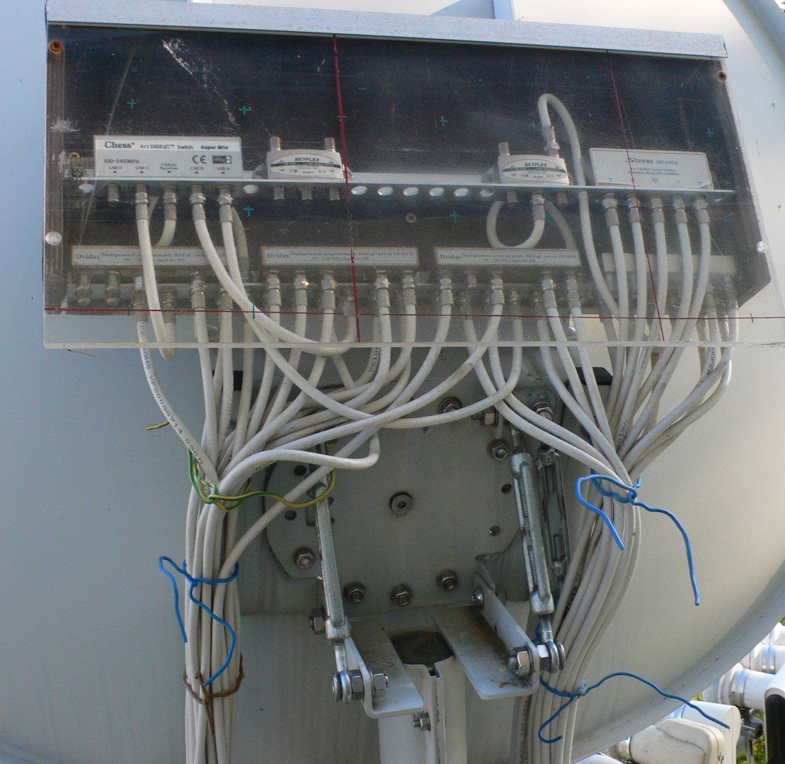

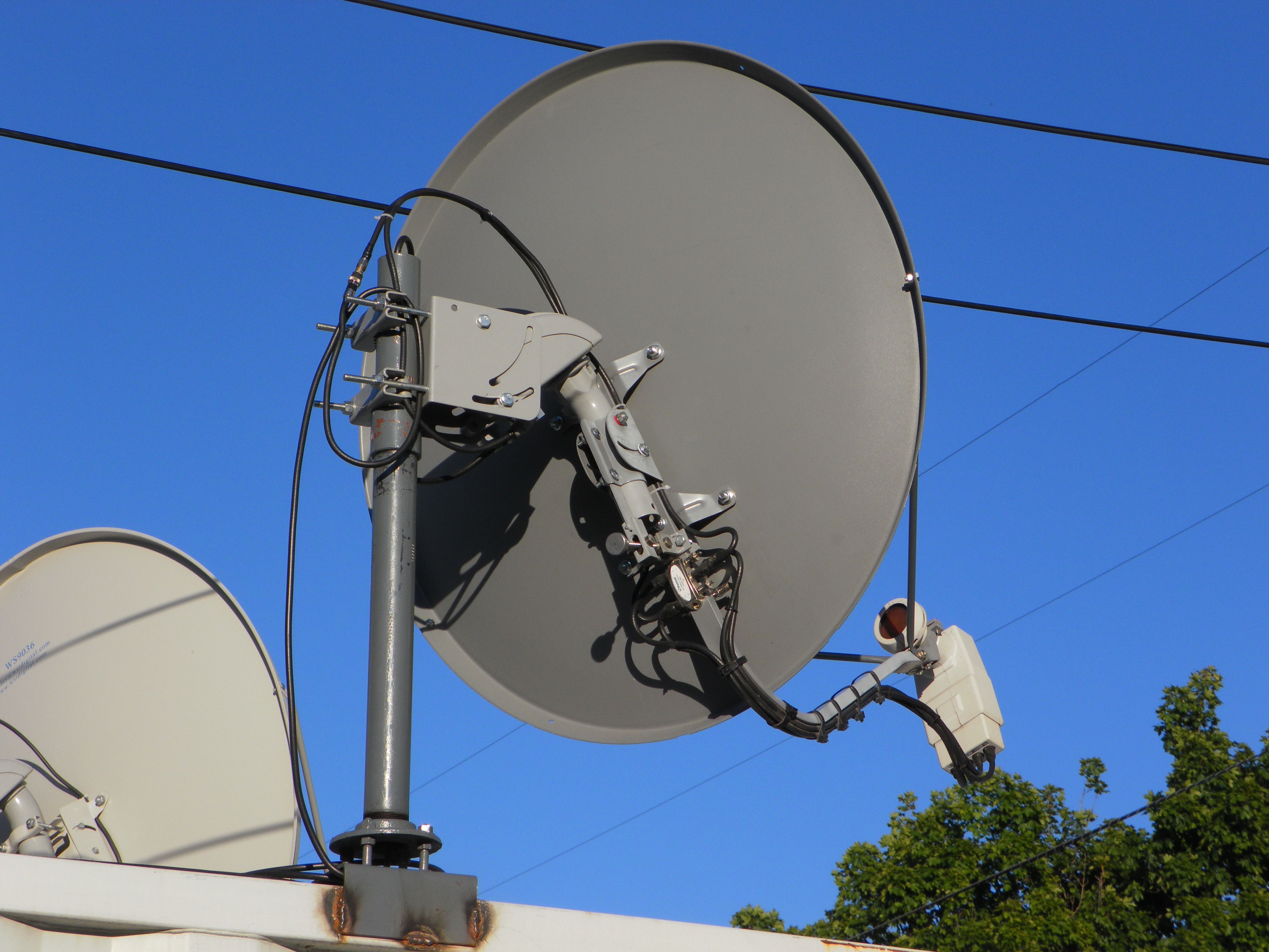

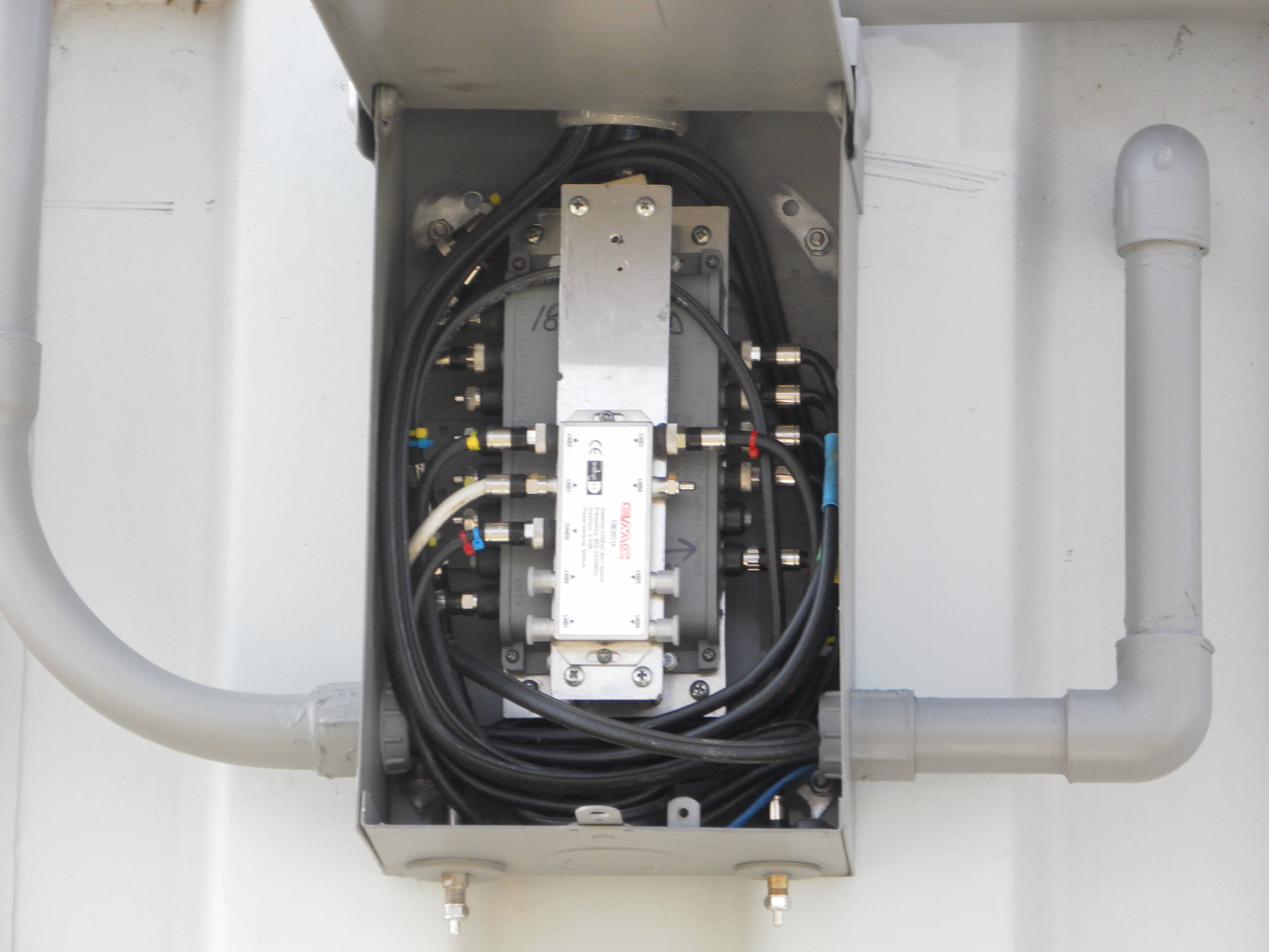

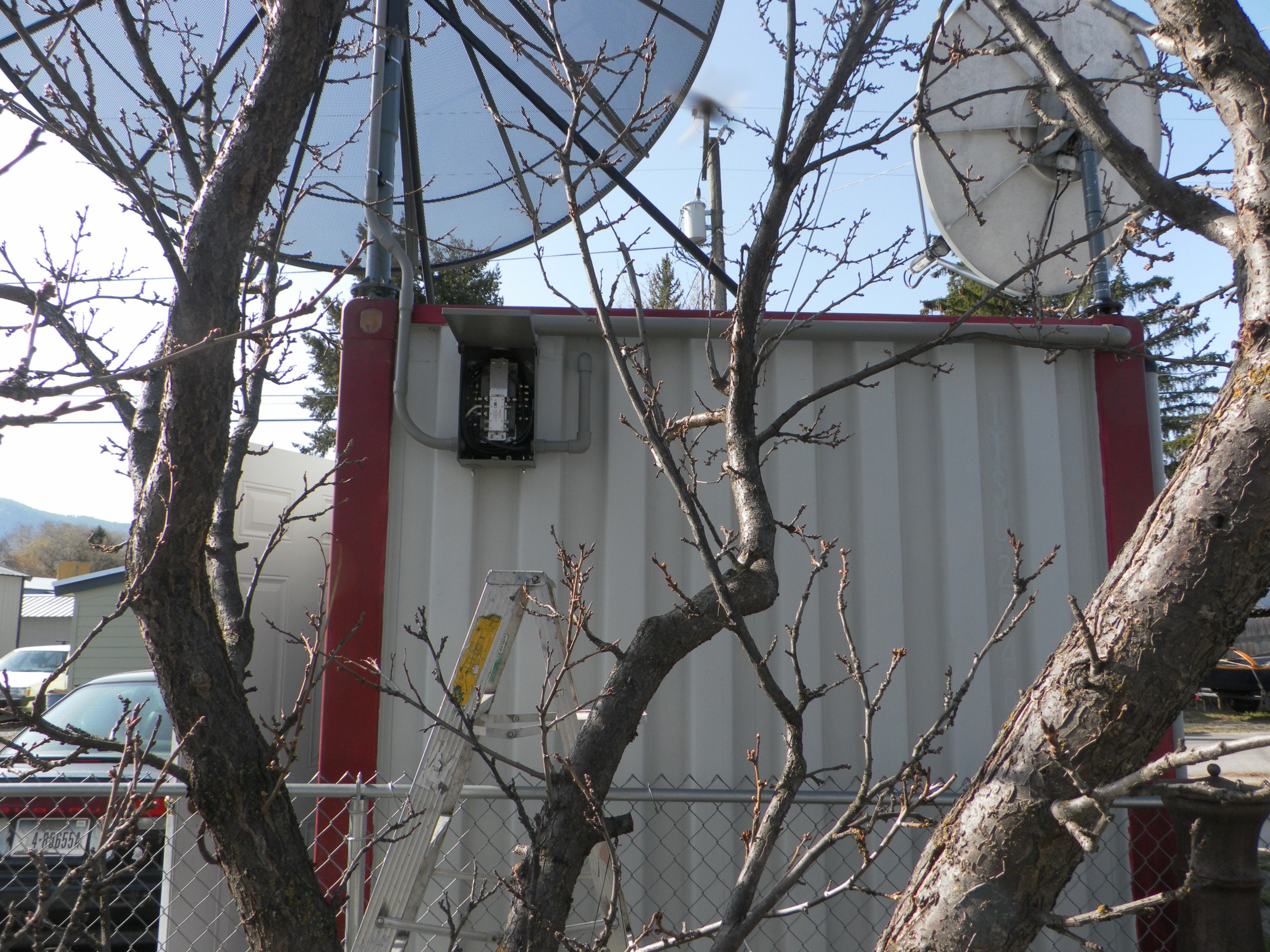

Usually the difference is just a plastic enclosure. Cold shouldn't bother them as much as heat. I have an ocean shipping container for a shed and my dishes on top. I had my switches inside but I suffered a loss to the extreme heat inside on hot days. I moved them outside the container in a circuit breaker box to keep them dry. April2014 010.JPG April2014 008.JPG
If you seal the connections and mount/driploop properly either works outside. If you do either type wrong they won't last long. Like Magic Static I prefer to mount switches in an enclosure for good measure and to keep things neat.

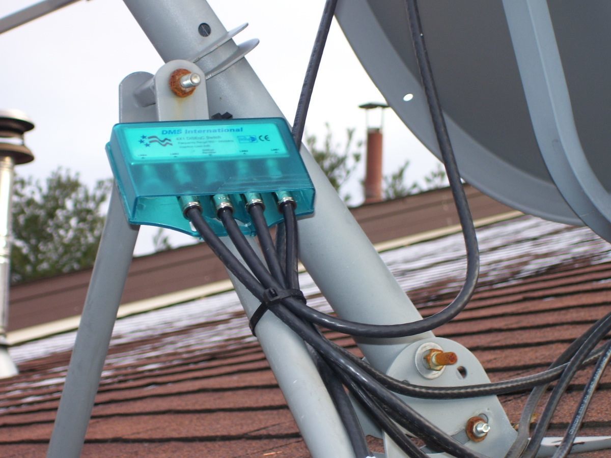

I had a "indoor" DMSI switch outside for a few years here in Minnesota....no issues
Hey iceberg, that is DMSI's Outdoor switch in your picture. :)
I could have sworn those older ones were indoor

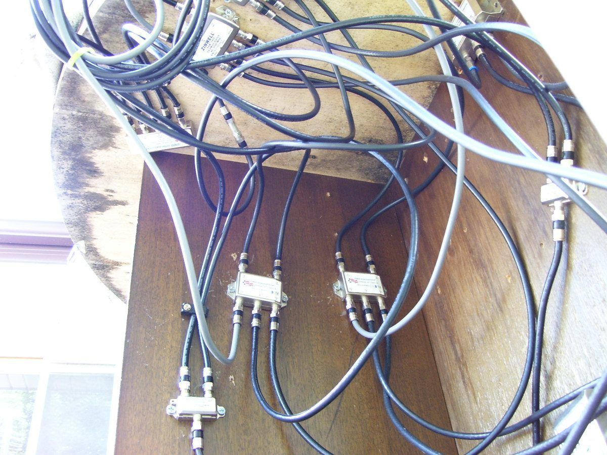

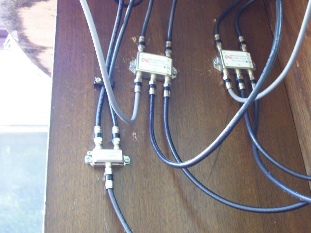

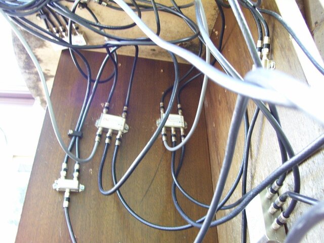

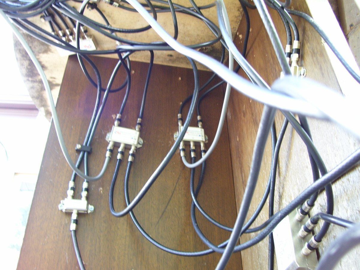

I know previously I had indoor switches mounted underneath the table that the T90 dish was on
