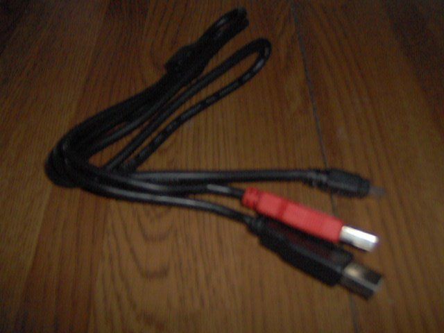

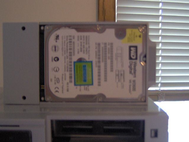

here is a picture of the cord and the hard drive when its removed

Yikes!

That's not just ugly... It's real ugly.
Why you would leave the drive in the receiver is beyond me.... Why put it in a removable tray if you don't remove it to attach it to the PC?

yes the cable hooks up to the drive. Right on front there is a plug like what digital cameras have
If you hook it up solo you really risk nothing.... but if something did go wrong only the HD is attached not the $500 receiver. (Again- The cable does hook up to the drive tray right?)

I did unplug the HD from the unit, hooked up the cord (one USB port) and the computer recognized it as "Drive F" and it did look like I could do some stuff with it. I didnt have anything stored to the HD so I have to do some more work
