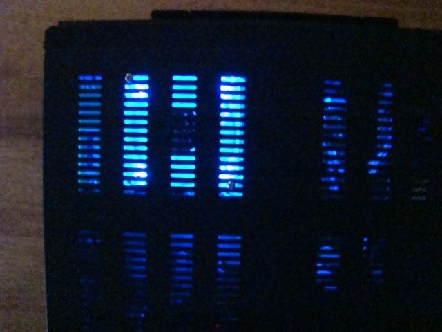

Wow, that is one very crude way to cool the box. My 2yr old son will pour juice on it if i leave it like that. I am tired of rebooting my pansat 9200HD. I guess i will have to put a fan inside. But how should i do it? Someone told me the fan should blow out of the box rather than into the box. How can i do that?
I tried 1 fan first did very little if any good.
2 was better i will add another soon and post pictures.
might be a week or 2.

added the first fan below pic 1 & 2
this did not fix it.

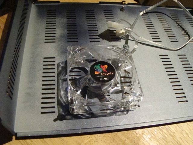

this is how i have it now in pic 3
works better with the 2 but only <> 75% of how well it did with that 12in fan and open case.

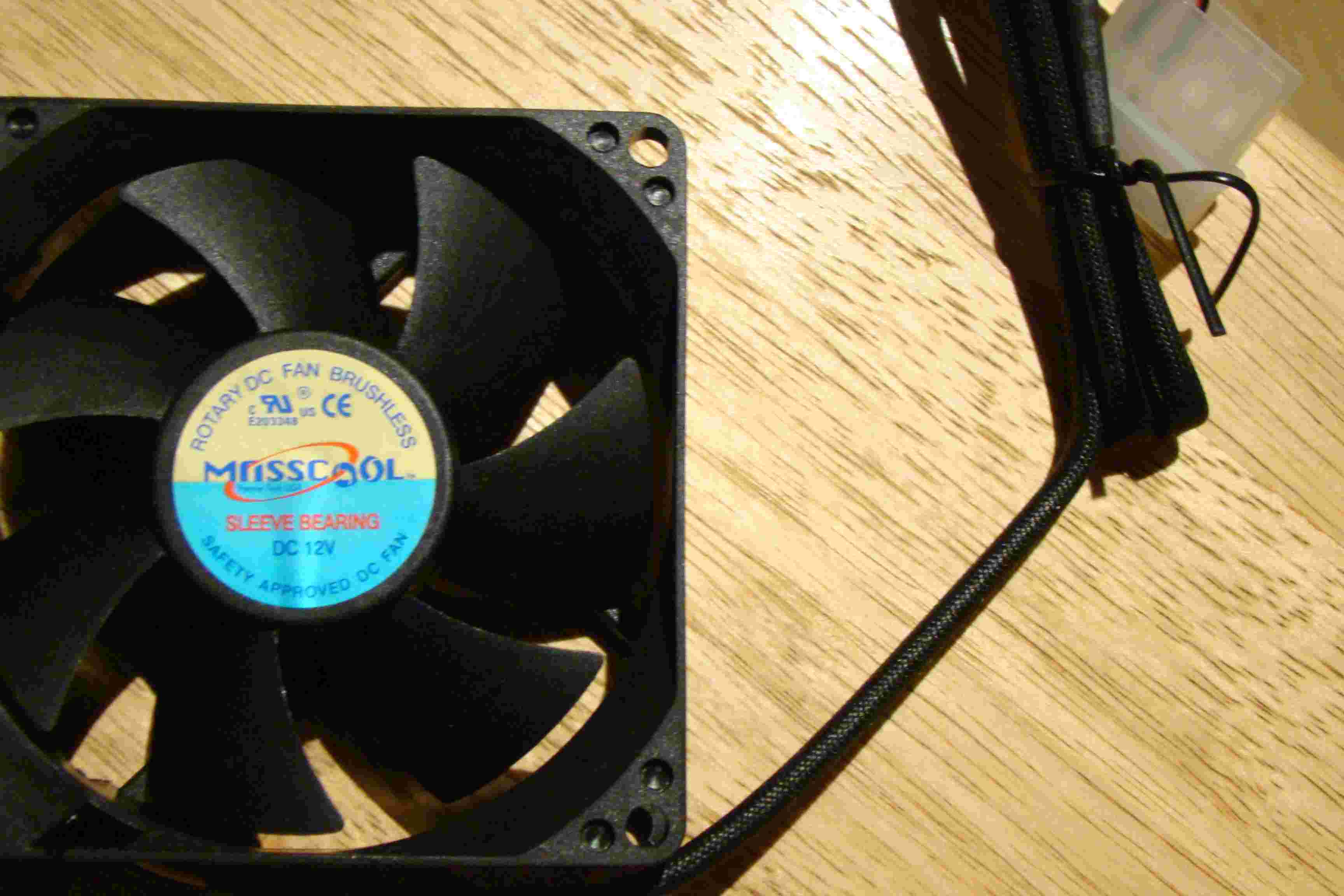

remoded my 9200
remoded my 9200 did not have any smaller fans. had just bought 12 80mm x 80mm x 25mm before Hermitman post lol.
took out the pretty blue one (pictures above post #69)put in one of these it works great too. but it is too loud was told it was 26db sounds like 40.
have wanted to add a resistor before reporting back but no time yet to do it.
turned the new one around blowing in as is the other one. they are very close to the positions as Hermitman has his.
and other than being a signal hog(needing lots of signal) the box works good. not a everyday box for me just for S-2 scaning and recording hi-bit feeds. have not tried the pvr/timer recording not needed at this time.
am i happy with it no but i'm ok it adds the 2 things above i did not have.
