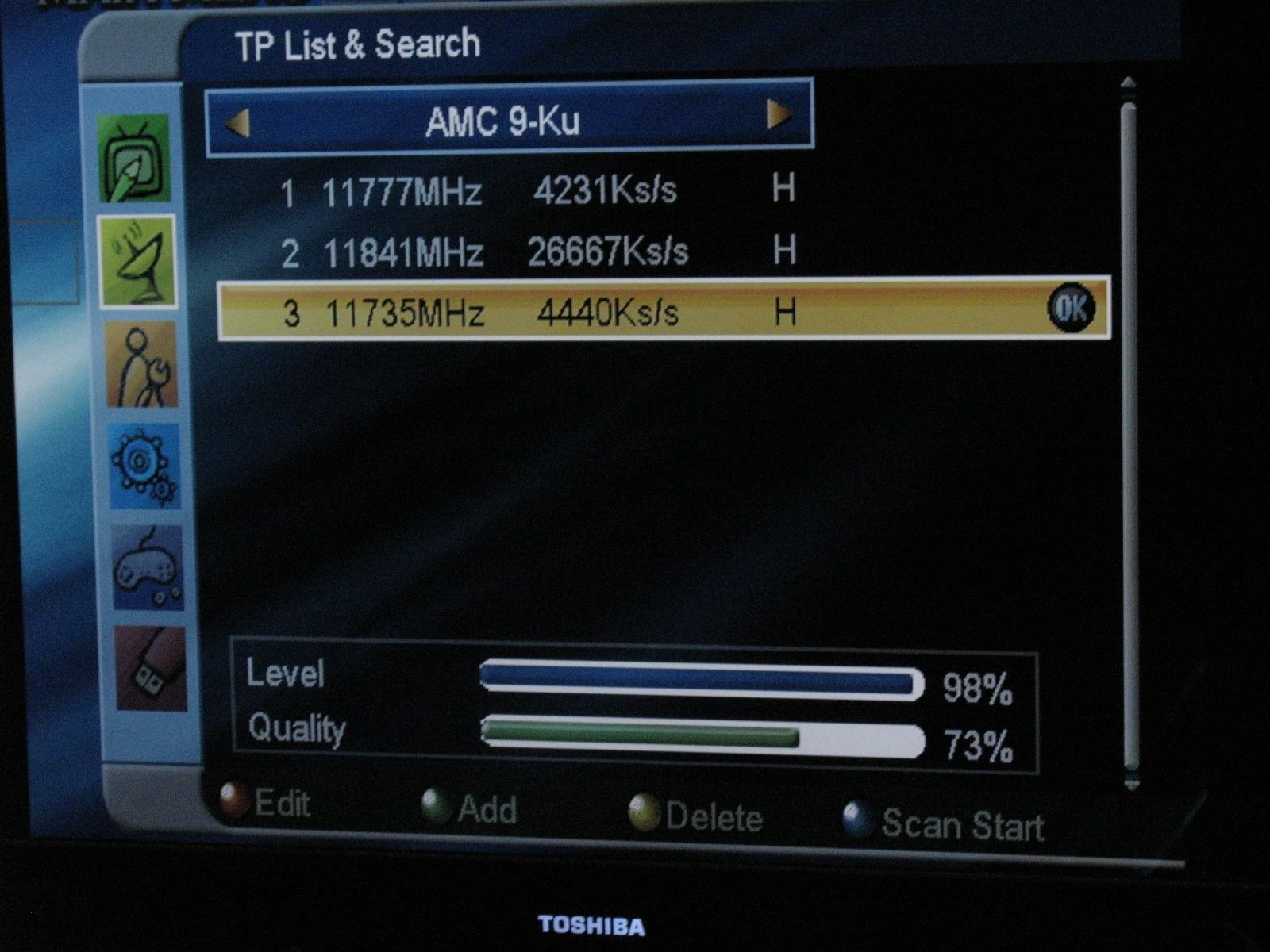

Although this new stb has been discussed elsewhere I thought I'd start a review here.
Here's what has been discussed before now & credit goes out to those members: http://www.satelliteguys.us/free-air-fta-discussion/262556-new-pansat-9500hdx.html
When I first set this stb up for myself I had it connected thus: stb>DG380 HtoH motor>1.0DiseqC switch>Port 1 to 4x8 multiswitch>dual output Ku DMX522 LNBF on a WSI 36" Ku dish
>Port 2 to 2nd 4x8 multiswitch> dual output C DMX242 LNBF on a Orbitron 10ft dish

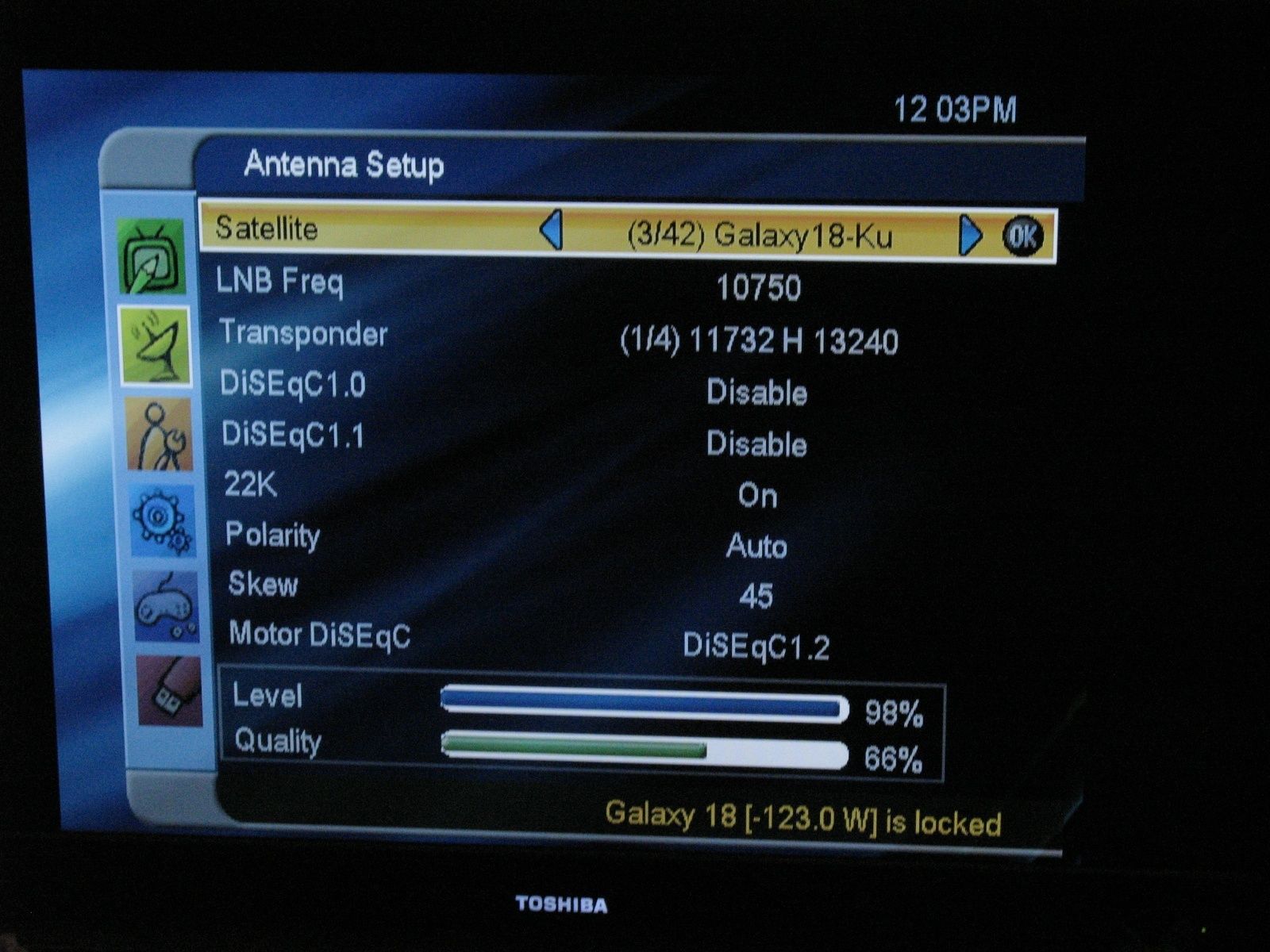

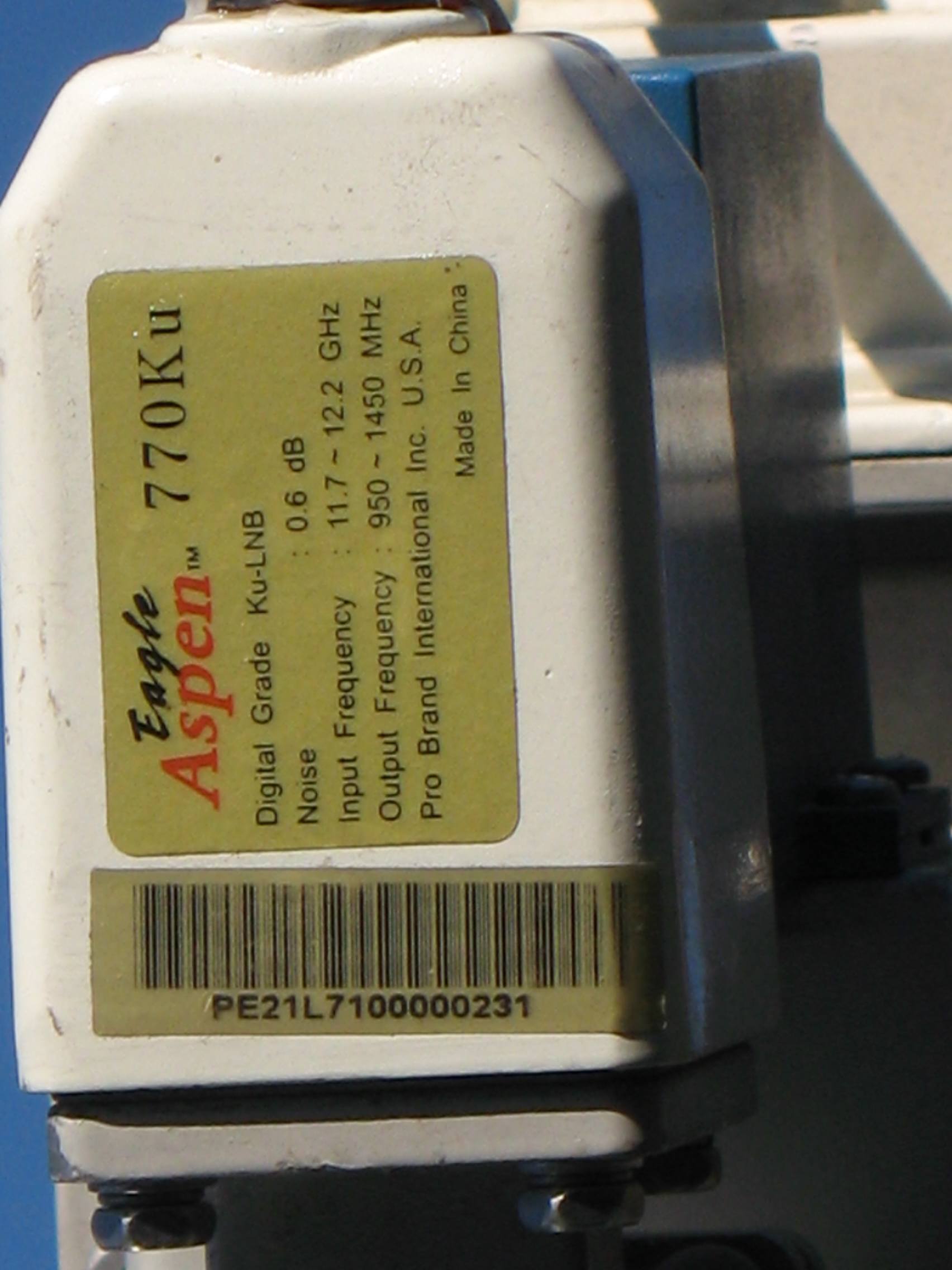

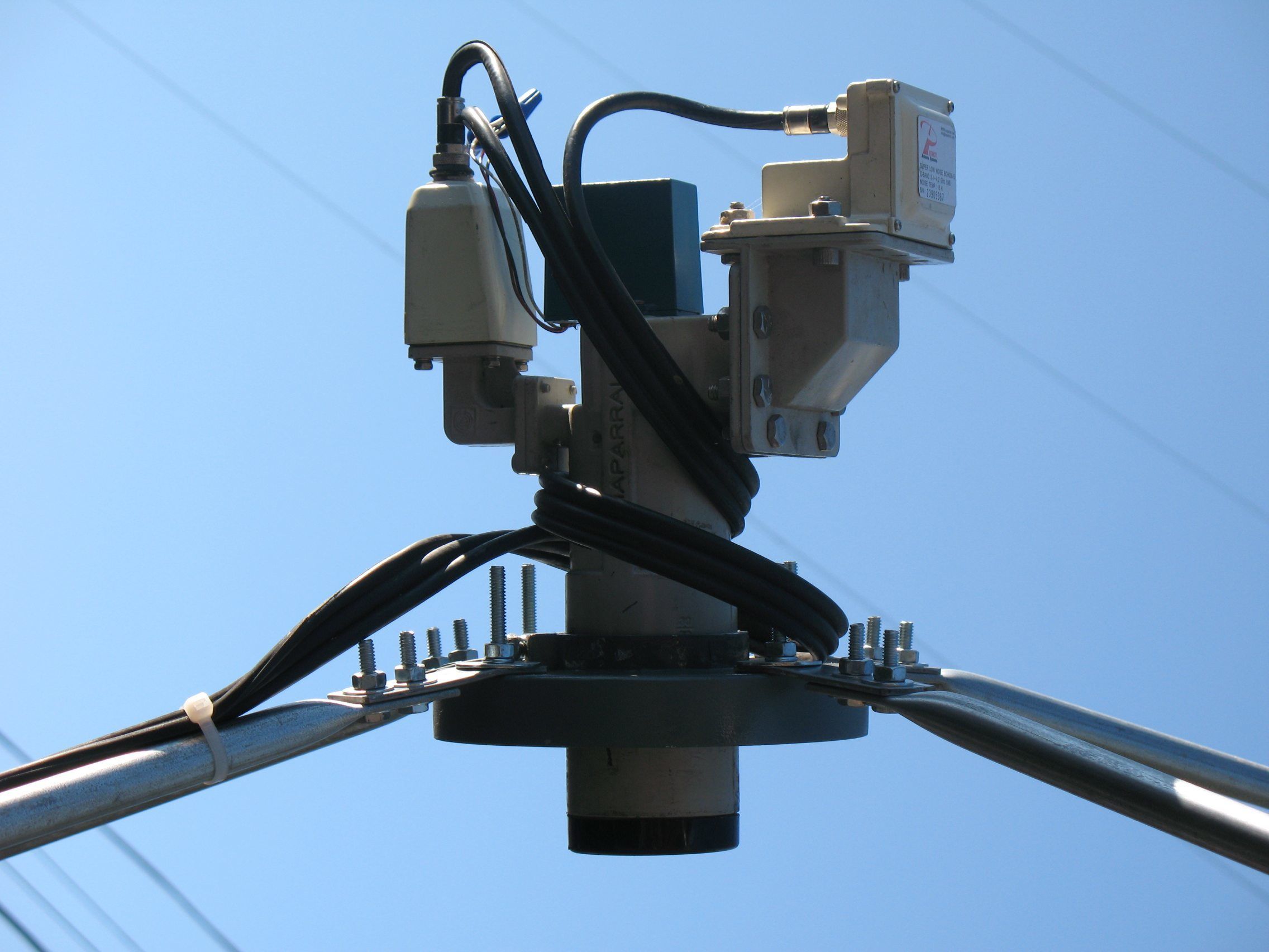

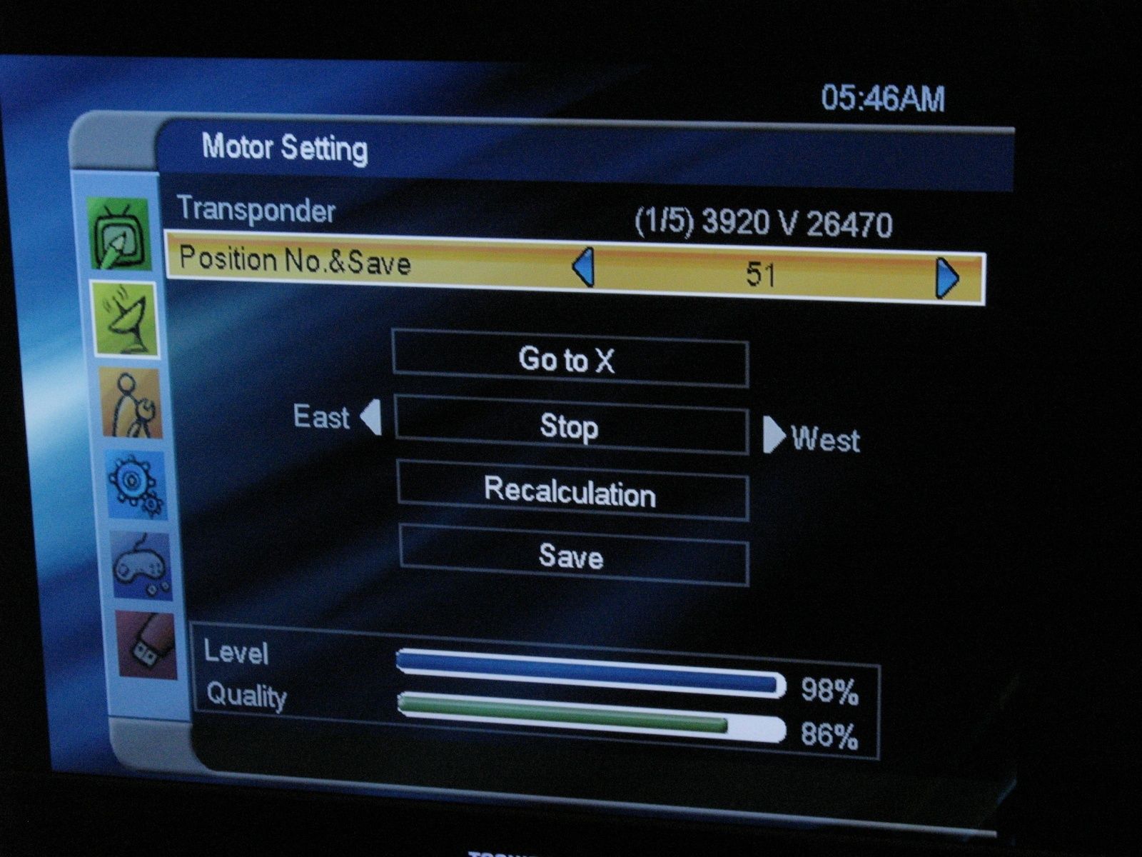

Second trial was set up thus: stb>V-Box 6 1.2DiseqC positioner>Ecoda 22kHz switch>22kHz port to Eagle Aspen 770 Ku-band 0.6 dB LNB, 10750 L.O. on Chaparral Corotor feedhorn set @ 0.30 f/D
>0 kHz port to Eagle Aspen C-band SLT+ 15*K, 5150 L.O. on same Chaparral Corotor feedhorn

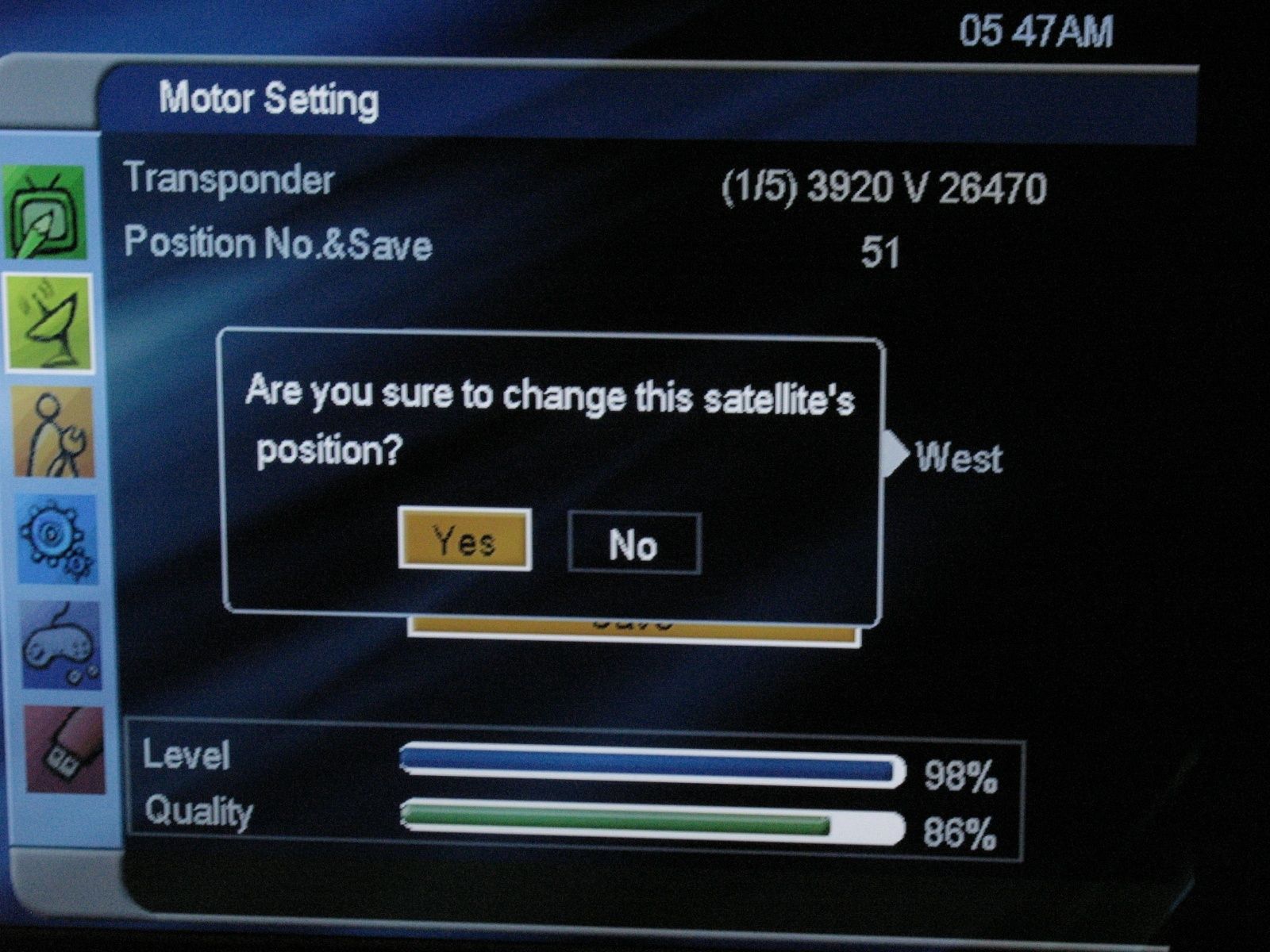

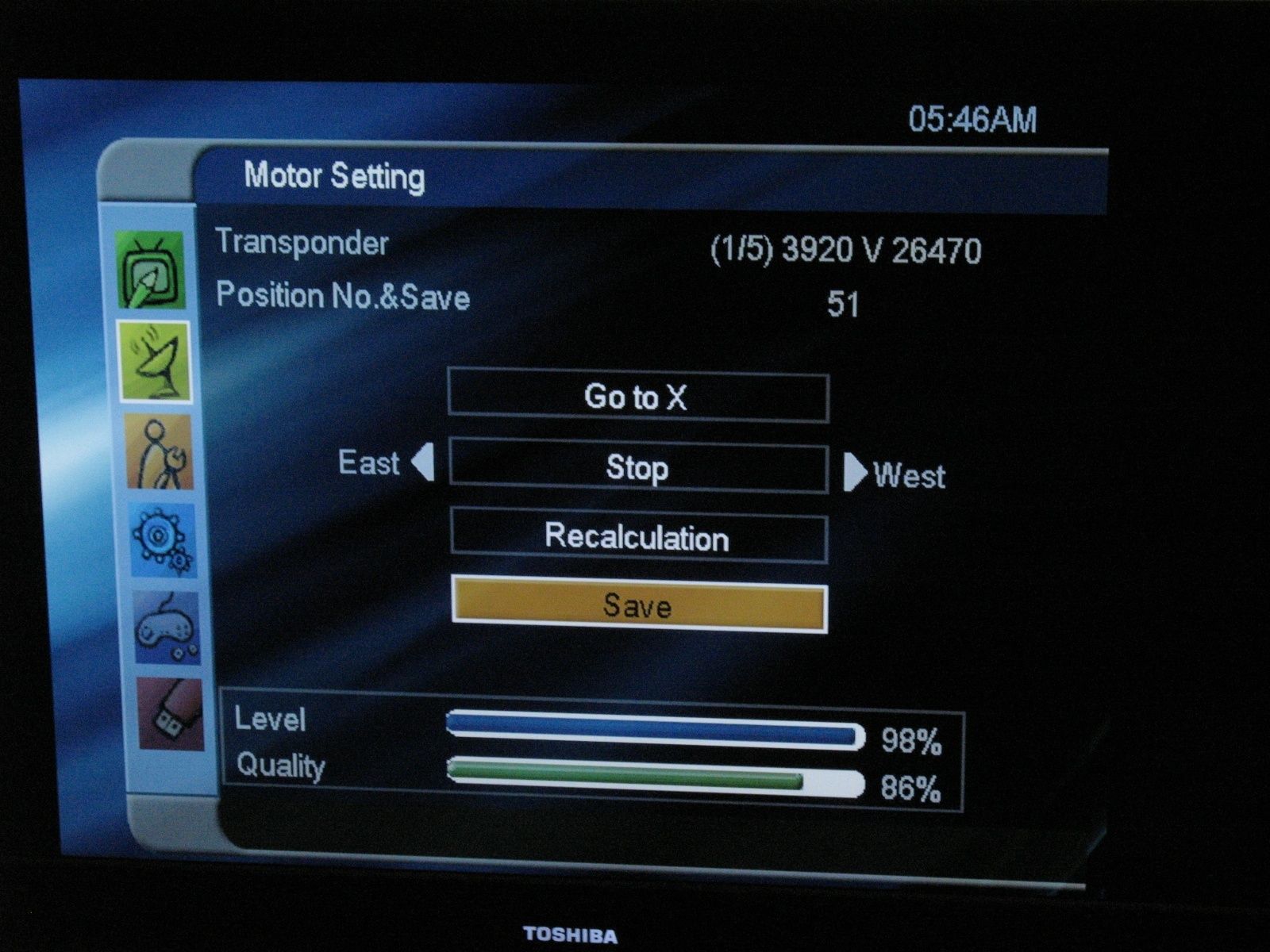

Chaparral servo motor connected to Pansat 9500 for polarity control & V-B0x 6 already programmed for satellites from 83*W to 139*W, Positions numbered from 34 to 59.

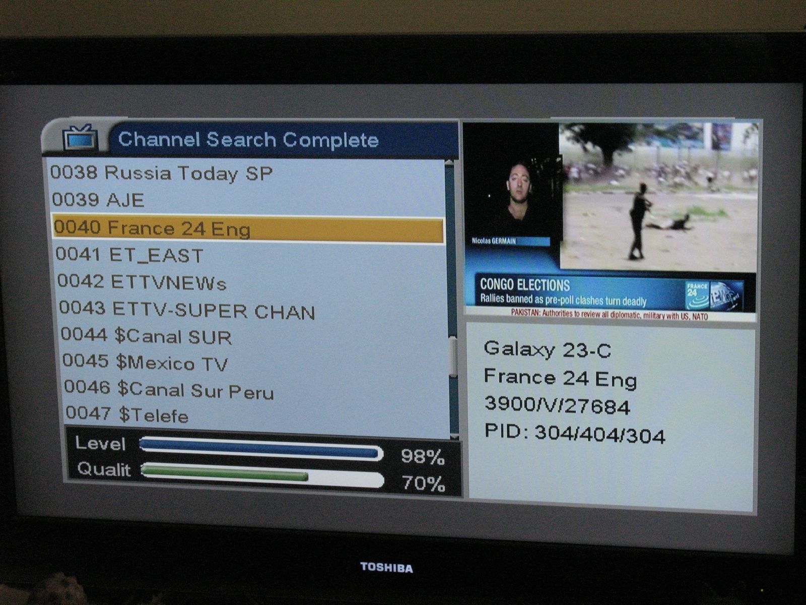

All in all the 1.2 positioning & polarity control of the Pansat 9500 is really quite nice - consistent repeatable results & signal qualities made this experiment worthwhile. Given that the Orbitron dish had been damaged from being blown over on a temporary stand, the Ku captured was pretty darn good: 223 TV & 139 radio channels on Galaxy 19 97W, 5 minutes to blindscan. The "Normal" scan is much faster, provided the TP list is complete of course.
Initially I used an old Patriot C-band LNB, but because the signal quality wasn't up to par swapped it out for the Eagle Aspen SLT+ for the H2H on a DSR-922(loop out through an digital splitter, non-power pass port). Found TPs on 105*W are H only so added a DCII V TP & toggled polarity to watch the H2H sub.;)

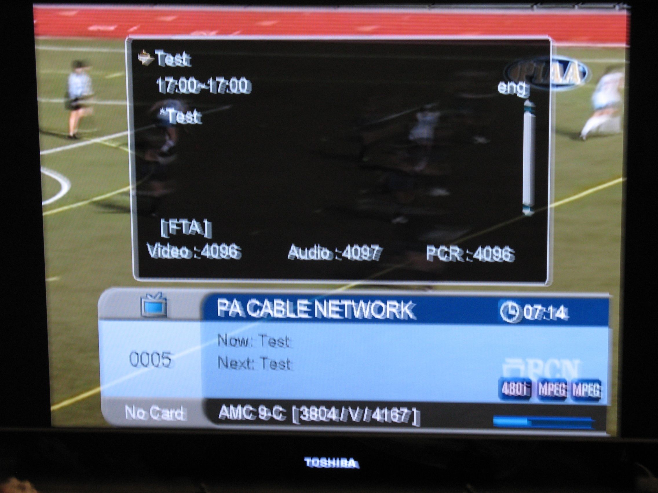

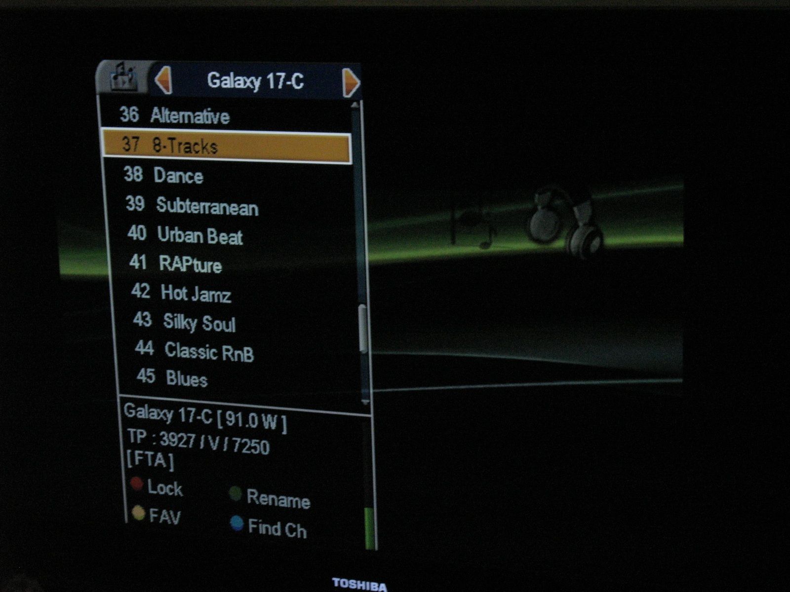

Found that some active TPs for satellites triggered a yellow text indicating that that satellite is locked. Can be confusing because at times the lock indicates the wrong satellite - more than one satellite share the same TPs. Was able to manually add the CWs with PID edit & scan them in - no need to use the Channel Editor here. Will try the 9500HDX Channel Editor listed in downloads on Panarex site one day soon. Or someone else feel free to evaluate?

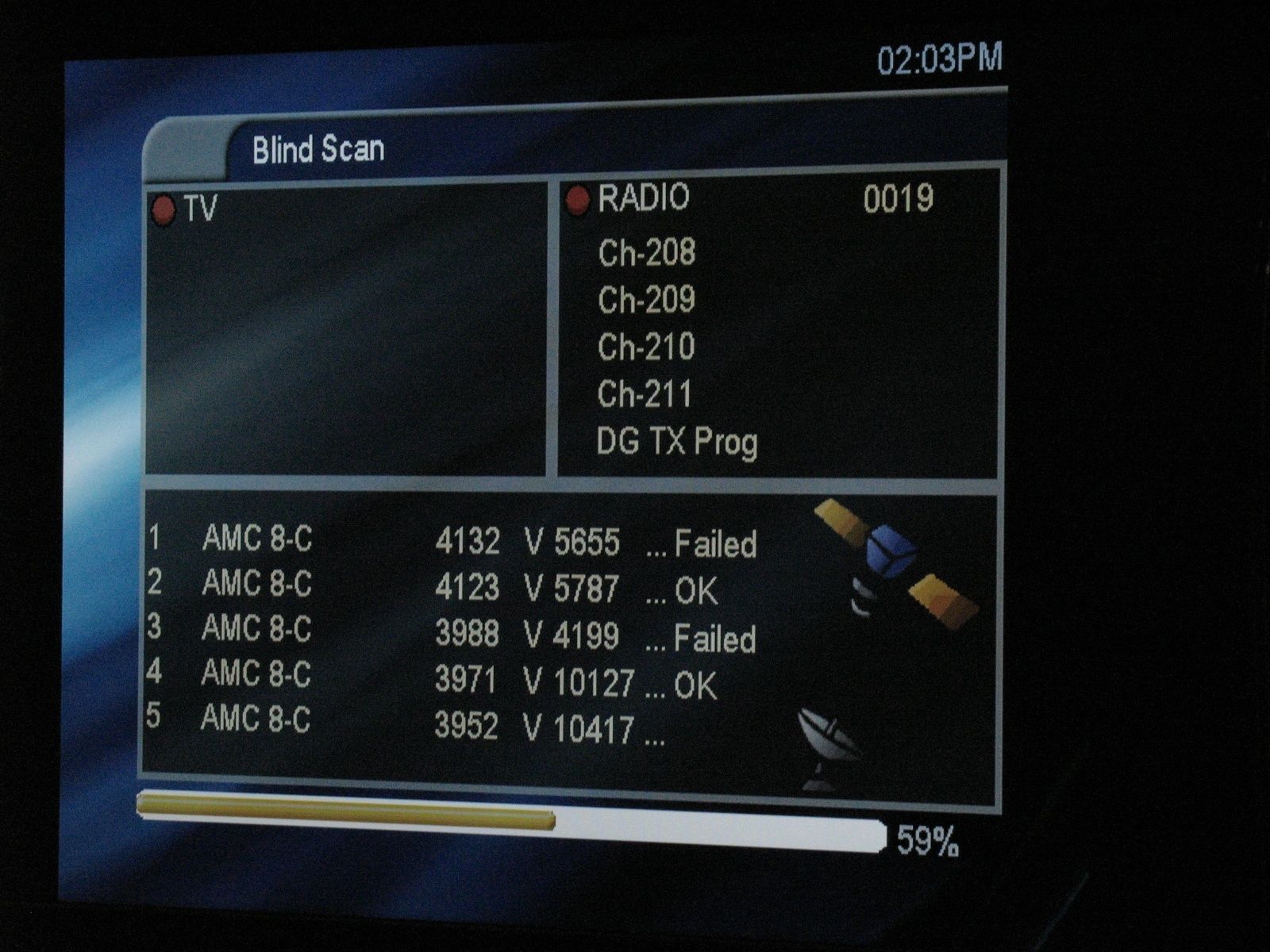

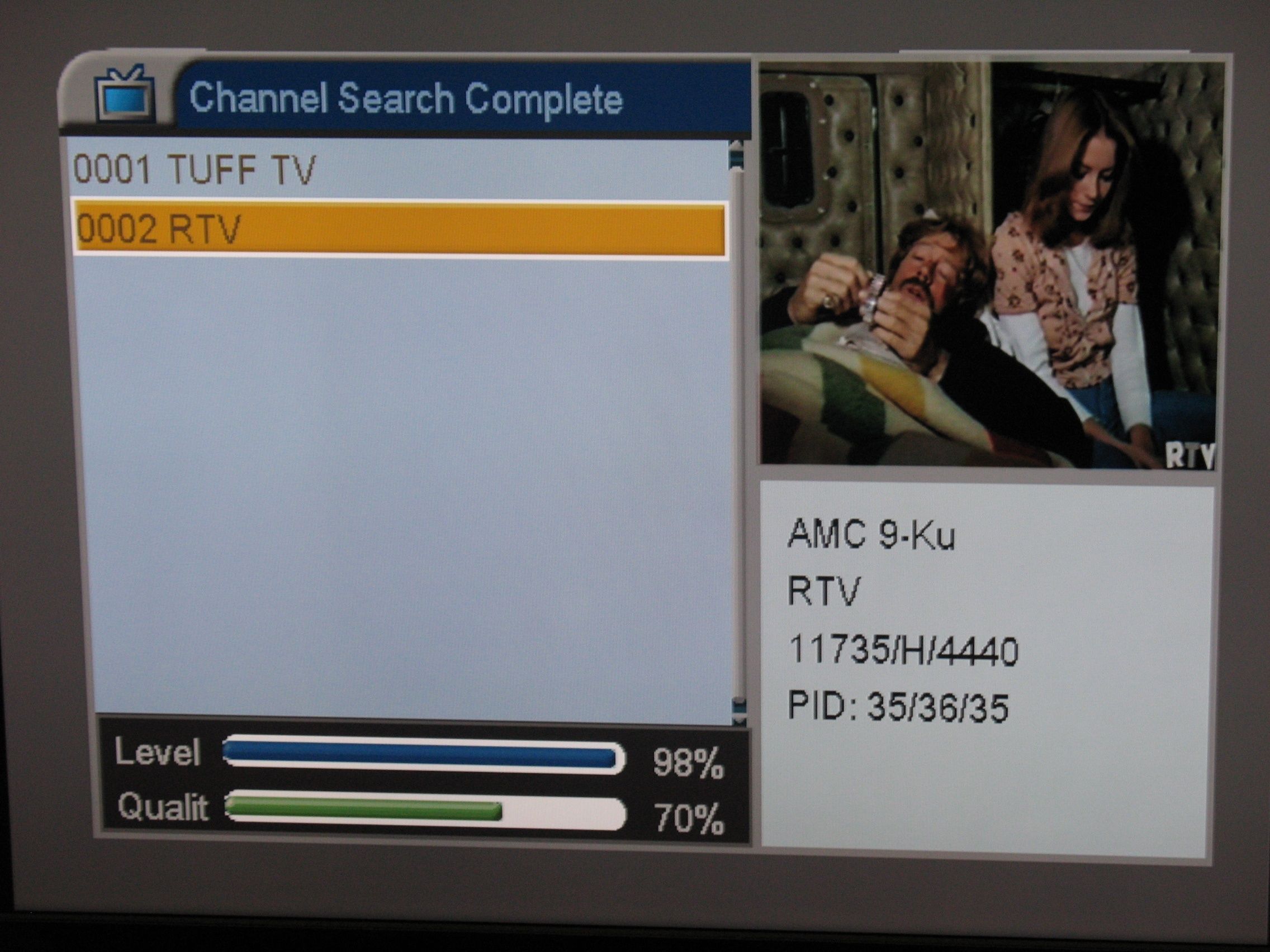

But I tried blind scan anyway and I was so surprise to see it works very well. After the blind scan, the Galaxy 19 is now locked to a new transponder with Signal level of 98% and Quality of 75%. So my problem was using the wrong transponder that not exists on that satellite thus the receiver can not find any signal from that transponder. The new transponder recorded from this blind scan could be the strongest one.
