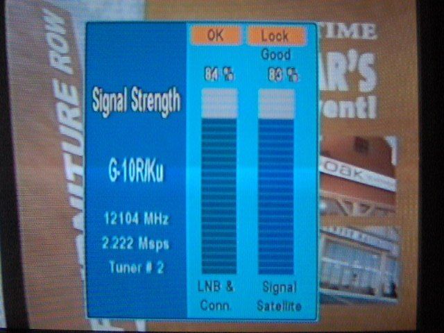

I will be doing the 2 lines from a motorized dish, but due to the weather (it is winter in Minnesota), I cant get to the roof to run a second line. So I went with option 1. Hooked up the cable and used the loop out to tuner 2.
Turned it on and away we went. The manual for once actually is pretty well put. It's a big book and does have how to set it up and operate it. Now since I have worked with Pansat units for almost 2 years, the menus are pretty familiar for me. Went into the setup and selected G10. You can select which tuner this is for. If you leave it on 1&2, then both tuners will work the same. If you had two separate dishes, you would select which tuner (1 or 2). Changed the parameters for my LNB and saved.

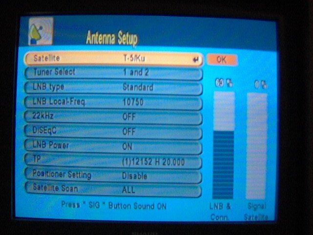

There are many different ways to scan a satellite
-Satellite scan....self explanatory. It scans the frequencies stored in the unit
-TP scan...allows you to scan a specific transponder
-Network scan...this finds frequencies with same symbol rate. Really only used if scanning a DBS satellite
-Advanced scan...allows you to manually put in PIDS
-Smart Scan...blind scan. Allows you to find all the unknown frequencies
-edit TP/satellite...allows you to manually add transponders, delete TP's and rename satellites

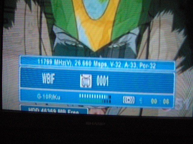

I did a smart scan of G10. The smart scan is about as fast as the Pansat 3500, and an upgrade of my 1500. It does not blind scan as fast as other machines, but it isn't as slow as some I've worked with in the past. Once I did my scan and had G10 logged in, now I really got to see what made this unit fun. The menus are easy to navigate and are simple to understand. I scanned through the channels with ease. At the bottom it gave me the channel name, number, the PIDS and the signal bar. If I hit the signal button, it shows on the screen. Only thing I don't like is there is a really loud high pitch tone to let you know signal strength. Other Pansats I've worked with only do that if you hit it twice. You have the option of viewing two programs at once via the picture in picture. I brought up the PIP and scanned to have two programs on. You can flip them if you want and make the PIP screen bigger. This works well for 2 sporting events. Once you have a channel up for about 30 seconds, you can use the PVR options to go back and create your own replays, scan forward and back, pause live TV. What is cool is if you are watching a program that isn't live (say you're 10 minutes behind the live version), hit PIP and you can see BOTH the live and delayed version.

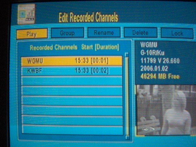

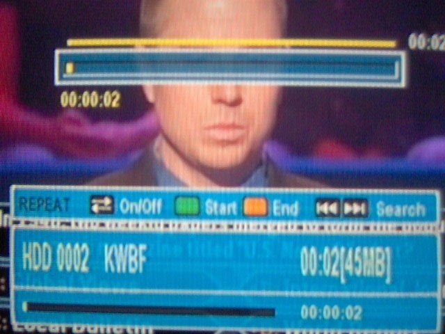

Now I decided to try out the reason I bought the unit...the PVR
Went to a channel and hit record. There's an icon in the left corner that lets me know its recording and starts the timer from 0:00:00. It disappears when 20 seconds have elapsed. If you hit info, it will show you how far long you've been recording. Now if I want to watch another program, I just hit channel up, down, or OK to bring up the channel list. When you do this, the program you are recording goes into a Picture in Picture (PIP). You can scan other channels on the satellite and still see what you are recording. Now if you want to watch another program but not have the PIP for the recorded program, just hit the PIP button and it disappears. You can record two different programs or record one and watch another. I decided to try and record two programs. I hit record and now I was recording two different channels. Now one word of warning. If you are recording two channels and hit PIP to bring up the other program, you cannot remove that until you stop the recording. Hopefully a software fix will take care of that. If you are recording a show (in PIP) and watching another, you can bring up the PIP and make it disappear again, just not when recording two shows. If you have 2 shows recording and hit stop, it asks what program to stop on the screen. There are a lot of on screen popups if you do stuff you shouldn't. I do like the warning message to verify you want to stop a recording.
After recording a few segments I stopped all shows and hit the "HDD" button on the remote. It brings up all my shows for easy viewing. Just select one and away it plays. You have full function of controls to fast forward, skip 20 second, move back 20 seconds, review, slow mo, and pause. Hit info and it shows you and tells you how far you are in the program. Very easy to work the PVR part and the best part is no tapes.

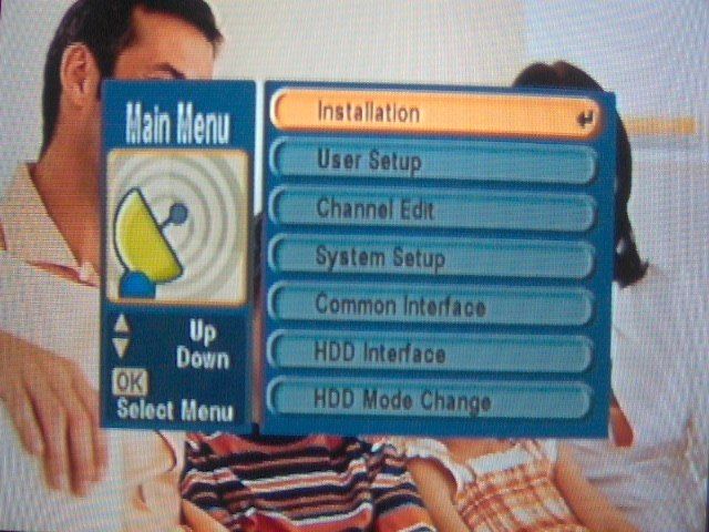

There is a menu option to do some advanced items with the PVR. You can rename the show (since it shows the channel name as the title), delete them, lock it so you cant accidentally erase it and the "cutout" function. This allows you to review programs and eliminate the stuff you don't want (like commercials) which saves HD space. Also allows you to copy to a DVD or tape without having to worry about commercials. This is an awesome feature and I wish other PVR's had this option : )

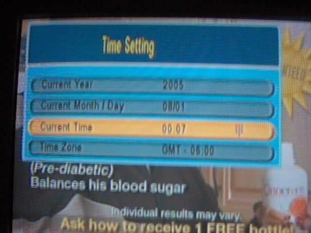

You can set timers to either turn on or record. Since the unit has a REAL TIME CLOCK you can actually record and not worry about it starting late (older Pansat units had clock that would lose so much time). It was very easy to set the timer and now I only need to set one timer (instead of two).

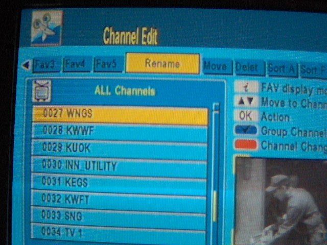

There is a full function channel edit options. I like the fact I can delete a whole bunch of channels without taking two steps. My other Pansats you go to the channel and right arrow to delete. This one you hit "OK" and it hilites the channel and moves down to the next one. When you have all of them you want to delete, hit exit and "OK" to delete them.

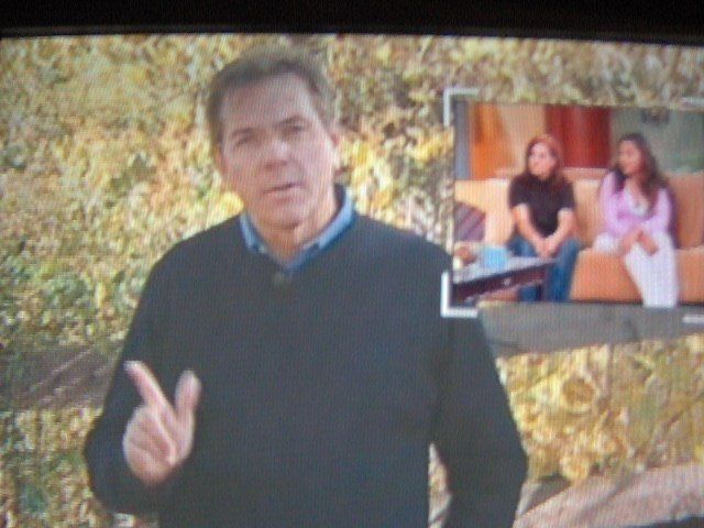

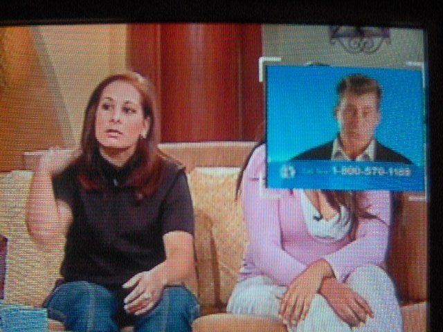

-PIP
-PIG (Picture in Graphic)

- Love the option of two tuners and PIP. I don't need two receivers & two VCR's to do the same work as this one machine does.

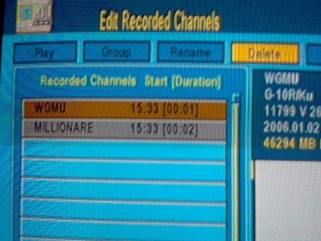

-the ability to edit programs on the Hard Drive. This allows me to view programs and delete commercials with ease. Find the beginning you want to remove, hit one button, find the end and hit another. When you exit out, it removes the stuff you don't want.

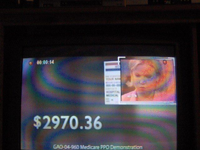

-If you are recording a program, it has a red dot in the corner letting you know you are recording and doesn't disappear. I found an easy way around that. Hit "OK" to turn on the PIP like you are going to change channels, then hit PIP and its gone : ) (what it does is make the program you are recording be hidden but its still recording). That was the first trick I found out when I recorded the hockey game.
-if you are recording a program, you can't go into the menus (to scan a satellite, edit channels, etc). You can go into the HD and watch a program that you already recorded. The ability not to be able to blind scan a satellite if I am recording is a bummer, but it is very rare that this would be happening.
-Can't set the timer to record two programs at once. The times cannot overlap. This is weird as I can record two shows manually, just not automatically.
Now this one I just happened to stumble on
-if you are recording two shows (lets say the Simpsons is the first one and something on RTN on the second one). If you stop the RTN show, you can change the channel with no issues. But if you stop the Simpsons, you can't change channels until you stop the RTN show.

The two things that make it different than a Dish DVR are
-when you back up in the program, you can hit PIP and have what you're watching and the LIVE version :)
-Easy access to PIP
