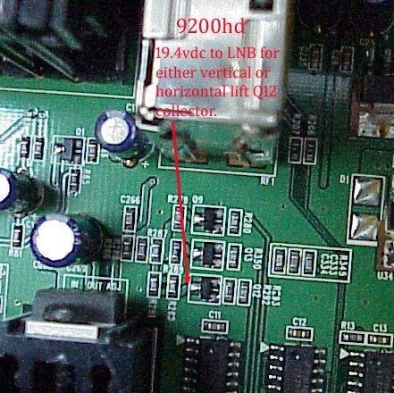

[FONT=&quot]7 The 9500hdx is easy to modify to provide 19vdc to lnbs for vertical as well as horizontal. As built, my 9500hdx supplied 13.2vdc for vertical and 18.4vdc for horizontal. The reason this is important is that many lnbs need 15vdc or more to operate (like an NJR2535S). Using the 922 to keep both the C and Ku lnbs powered up sometimes causes the receiver to confuse and accept a C-band IF while scanning for Ku, because the Diseqc switch filters DC power to the lnb, better than the received IF. [to mod the 9500hdx board simply raise the collector of Q20 from the pcb – pic).[/FONT]

Since this thread is aimed, in part, for C-band users interested in fta, I will add the means of eliminating the drop in supplied lnb power level for vertical polarity (for use with lnbs requiring 15vdc) for the 9200hd as I did in my prior post for the 9500hdx. One only has to lift the collector of Q12 as shown in the below pic.
