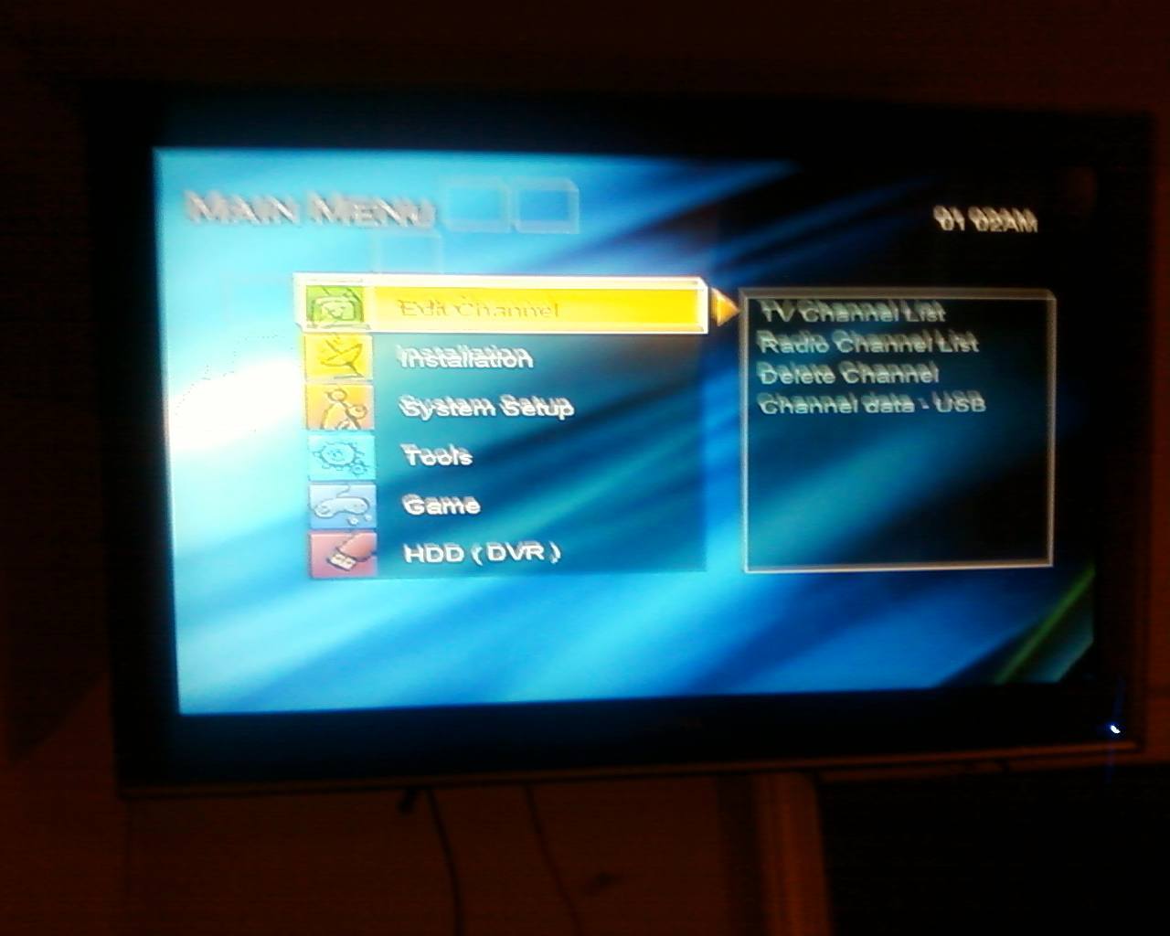

UPDATE: What the hell...I flashed it to the new Pansat 9500HDX and guess what?
It comes on and says on and that is it. But a picture fades in, or should I say the menu fades in as the background fades out!!!!
I'll post pics. The FW is useless but it is alive, though crippled it may be, but it is the first life I have seen! No remote and buttons on front do not work either.
WOW! Gonna try S9 FW now!
I'm on the 3rd attempt at S9 FW...But here is a pic of the 9500 FW!
What exactly does the Pansat firmware allow you to do? I take it that it isn't much, like when you load S10 firmware on an S9?
Right Jim, I got a crapped out S9, so I did it...I did get the S9 fw to load and boot once after that...Beer is not good for a box. I just found it very interesting the PS FW ran when I couldn't get any S9 to run. Back to working on the S9 FW...
And since it is probably shot, I loaded that megasat hd800 FW into it...it does the same thing the S9 FW does, stuck at on, or on, boot, --
Well, I don't think the megasat ever said boot. The PS never says boot but it does display a pic.

What it was doing when I started.
Why don't you get it? If you have nothing to loose, give it a shot! So I did...I was about to give up before I seen that and it'll do it every time...S9 has only booted once, and froze. PS FW may run in a good box!
BY the way, the PS FW is not froze up...the : in the time is blinking and counting time, see pic above, time starts at 1:00 AM...you just can't navigate with the buttons or the remote.
