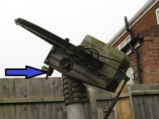

Here's a modification I did on my DH for fine tuning in KU band, its movable in every direction very important to have this on larger dishes when tuning into KU band, this installation will have something much the same.

Hi mate :) Welcome to our forum martin-f . Ya I still lurk around here sometimes. Congrats on your new toys :) I guess RimaNTSS is right that if you wish hard enough eventually sat dish stuff comes to you :)
I didn't change anything really on the motor except the chain itself. Its just simple motorcycle motor chain. I ordered it from a local shop. The manufacturer was Yaban. Yaban Chain Industrial Co., Ltd. but any equivalent will do. I think their spec sheet was this one 14_file_1.pdf
The part #on the receipt is 530X110.
The gear drive was made by Von-Wiese along with the motor. If you want you could replace the von-Wiese gear drive with a right angled gear drive as long as the output shaft diameter matches. In fact that's what I think Paraclipse ended up doing during the model run.
As far as the electric motor goes...... I wanted to upgrade the Von-Wiese magnet and reed switch assembly from a 4-magnet assembly to an 8-magnet assembly to get more counts per degree of motor travel. Apparently some of the parts in the Paraclypse motor are a lot different from the parts in the regular old Von-Wiese satellite actuator so that's a bust. It makes sense because this motor is about twice as big as the regular Von-wise motor. I enquired Von-Wiese by e-mail and received this reply from Scott (he certainly took some time to research the old motors part numbers etc so kudos to him) at Von-Wiese:
"Hi Kevin, The V04169AF33 motor you have used the P12230-0003 reed switch and the H00106-0015 output gear. We do not have either of those in stock. The E12549-0002 is essentially our P12230-0001 reed switch. This has the same body size, the leads are only 1.5" long and it is different electrically from what you have. I cannot send you the drawings, but I could put together a comparison of the specs if necessary. The output gears are not close to the same. The H10059-0002 is about 2.5" od, 57 teeth, spur gear and doubles as the magnet wheel. The H00106-0015 is about 2" od, helical gear and 30 teeth.The reed switch might work for you, but the gear would not. If you need to purchase anything, we can ship to Canada, but would need your complete shipping address to calculate shipping and any duties.

Oh and hopefully martin-f the lower thingy on yours isn't seized like mine was. It was a bear to get unstuck without breaking it. Since it is aluminum and the shaft it rotates on is steel mine had a lot of rust between them. IMG_0137.jpg
Reactions: martin-f
Hi Kevin nice to here from hope all is well :) many thanks for the information, I do have a pdf file with cog upgrade kit information I will have a look through it,
Did you not consider re gearing the gearbox for smaller movement, if correctly fitting cogs are available it very easy to get the small steps,
When I was making the DH chain driven mount (not finished yet) I installed a 80/1 gear from memory, on testing small steps you could really fine tune,
Thank you Kevin its had some bodge at this point and more than likely stuck, Ive come across things like this in the past on cars I do have ways of dealing with them,

Slightly bigger gearbox on my diy DH mount, I had to fabricate a connector to get the motor to fit, if worst come to the worst I will do something similar on this install.
