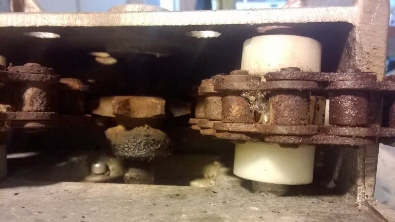

Stripped the motor this afternoon everything was stuck as expected very pleased how its come apart :), anyone who's messed with steel bolts and aluminium will know they get stuck, you should always use lots copper slip on installation,
The bushes now burnt was made from nylon, these will be replaced with oilite bushes,
The main spigot needs a good clean and re-tapping,

I've yet to check the motor/gearbox but have every confidence it will be ok maybe new brushes, I used to repair similar motors so its no problem if it does have any faults.
I need to replace the belt drive to chain that's no issue my son in law is manager of a company that supplies parts needed, including oilite bushes :),

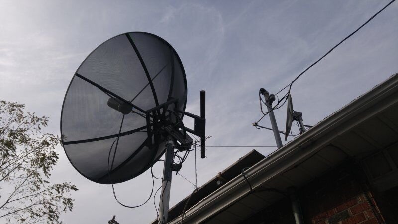

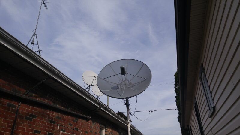

Hi Kevin, what dish did you install on this motor in the end, any pictures please :).

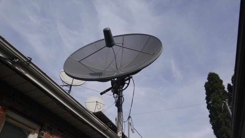

A Winegard Pinnacle 3.0m (10 foot) Perforated Aluminum custom mounted to the Paraclypse H-H. Its only setup for C-band at the moment. I also added a counterweight which I found really helped ease the strain on the motor at the ends of the arc.
Plans for the spring are to take this assembly down off the pole. I have a lead on a Andrews (now Raven) 3.0M (10 foot) spun aluminum solid dish for $200 Canadian here in town that's not in use 20170930_162203.jpg and want to try my hand with that dish at ku on the Paraclypse H-H.

Thank you Kevin, two lovely looking dishes you have there :), the spun dish should do well in Ku band my DH does very well,
I might install a counter balance on the Paraclipse, I will see how it goes pulling from the ends of the arc before I make a decision.
