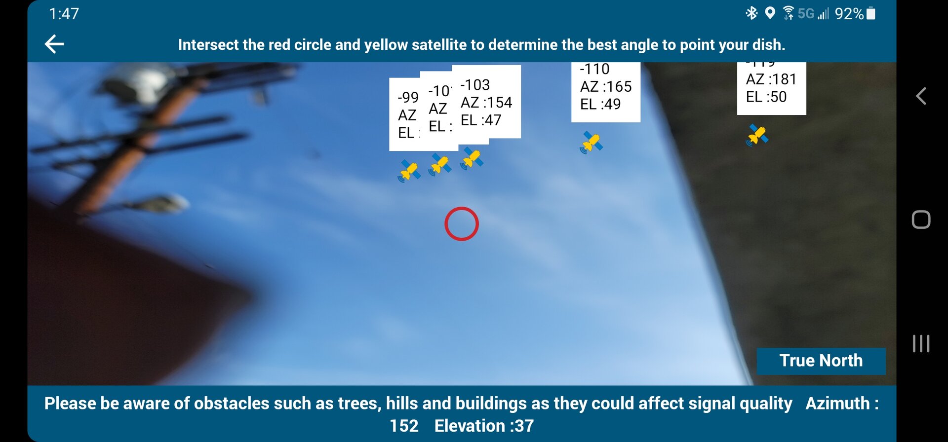

I am starting to bet on a limited line of sight to one of the birds. There coming back out to re align it again ugh.. the twit that came out today didn't even re align the Damm dish after taking a closer look I noticed that it wasn't re pointed ugh
wow lol
Is 119 behind a building? Did you get a 3 or 5 lnb? If a 3 then there is no los issue.
i'm running that LNB... Oh and shouldn't the red circle be pointed higher up??? there's some some pixelating.
Well i pulled the tower out from behind the t.v. hopefully that helps. i am thinking there was some kind of electromagnetic interference going on as well..

Don't worry about the location of the 119 Sat, your not using that Sat anyways ....
Everything your using is on the 3 Sats .... 99/101/103 which are clearly viewable.
