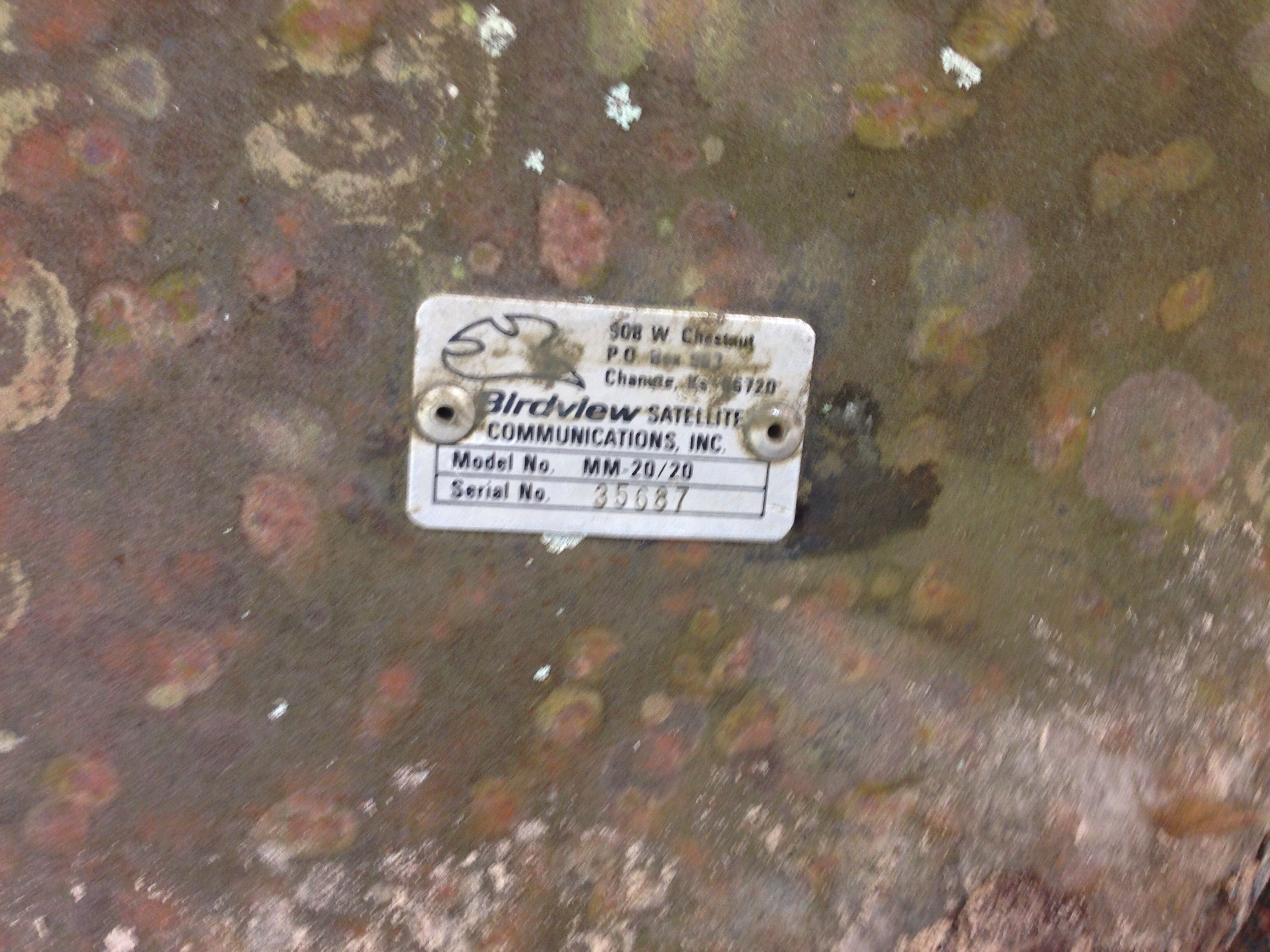

If the dish is actually a Birdview I'd say there is about a 99% chance that it is 8'-6" in diameter. They made some that were 9'-6" but they must be fairly uncommon...I have only seen one documented 9 1/2 footer in captivity. Any size BV is an excellent dish though, they just need some modification to bring them into the 21st century.

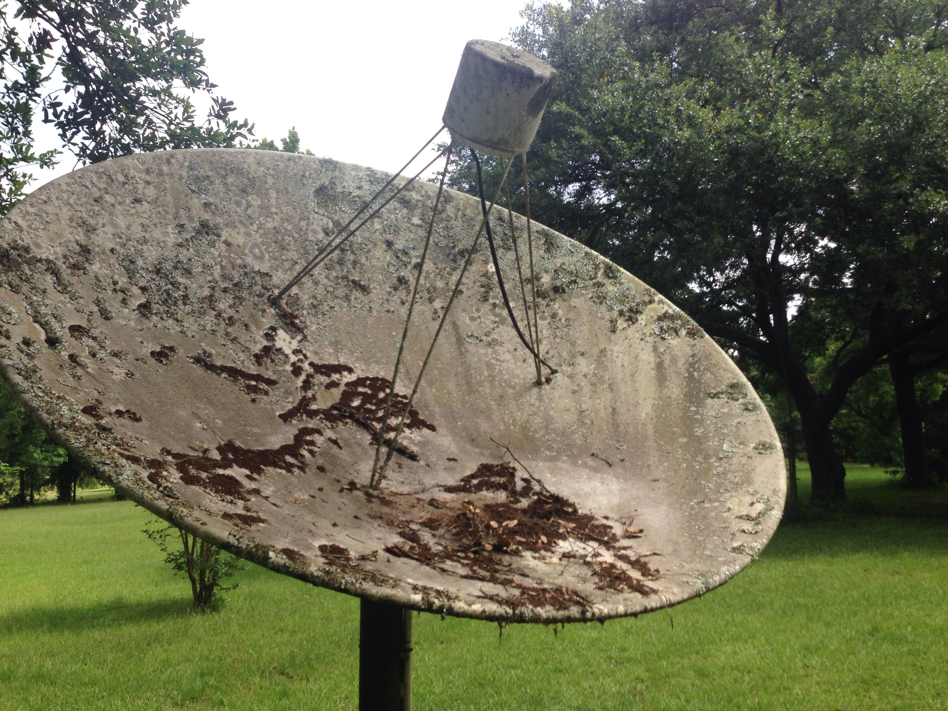

Yes it's birdview

Nice dish. Needs some TLC & a new home (provided)
A power wash and a fresh coat of paint will make it BEAUTIFUL! (Don't use high gloss paint)
Think it's best to swap out the electronics with a new LNBF. Use the existing scalar by opening up the center hole a bit. (Titanium PLL ?)
Depending on it's age, it may be a 10 turn pot for a sensor. If so a pulse conversion will be necessary to use a new mover. (GBox, VBox, Titanium ASC1) Unless - you use the receiver that came with it as a mover. (??)
OR can use a battery to move it and an ohmmeter to monitor it's position.
Some pictures of the gear box will 'tell'. Drop the cover off and on the right side of the 'screw".
Simplified alignment instructions (by me) at www.wisgeise.net/BUD Note: BV dishes have fixed declination, so ignore unless you want to really 'peak' it.
