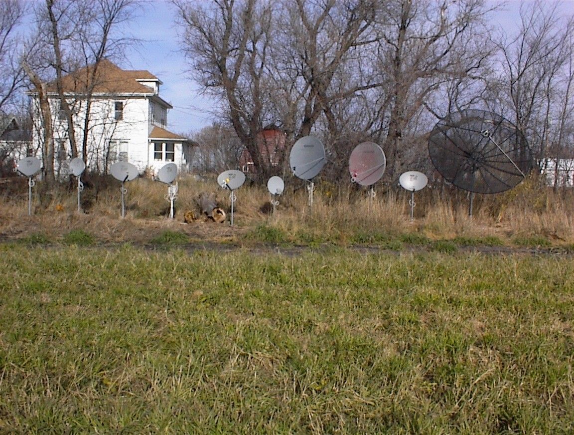

My 10' Cm, and both 1.2m DTN's are all mounted on rigid electrical conduit. I have a couple of friends who are retired electricians and bigger packrats than I.
Last week we had a bit of a blizzard in ND/MN with 50mph straight line winds and none of my dishes budged.
Drill a couple of holes near the bottom of the pipe for putting some "anti-twist" lag bolts in before you pour the cement.

That conduit is strong enough. Fill it with concrete ready mix and steel and it won't go anywhere. Good Luck
Good advice.
BTW, your dish farm looks awesome.
