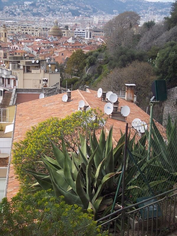

Well I finally got the photo from the student. This was a rooftop in Nice, France. They are big in FTA in Nice, eh?

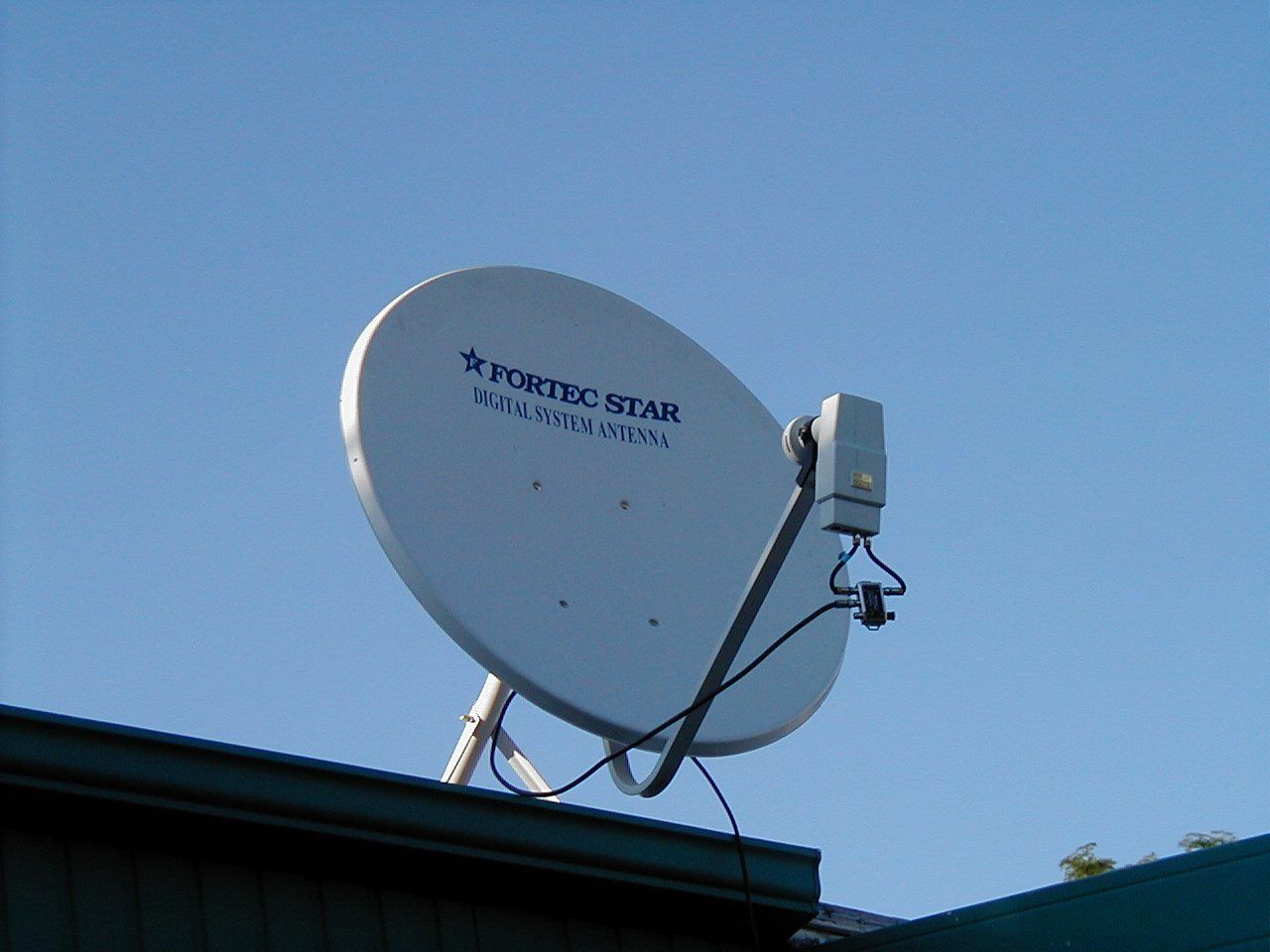

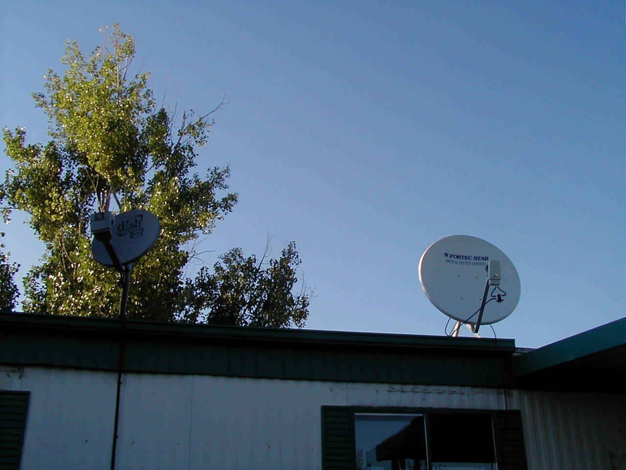

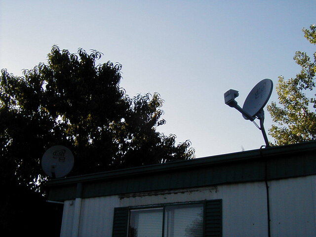

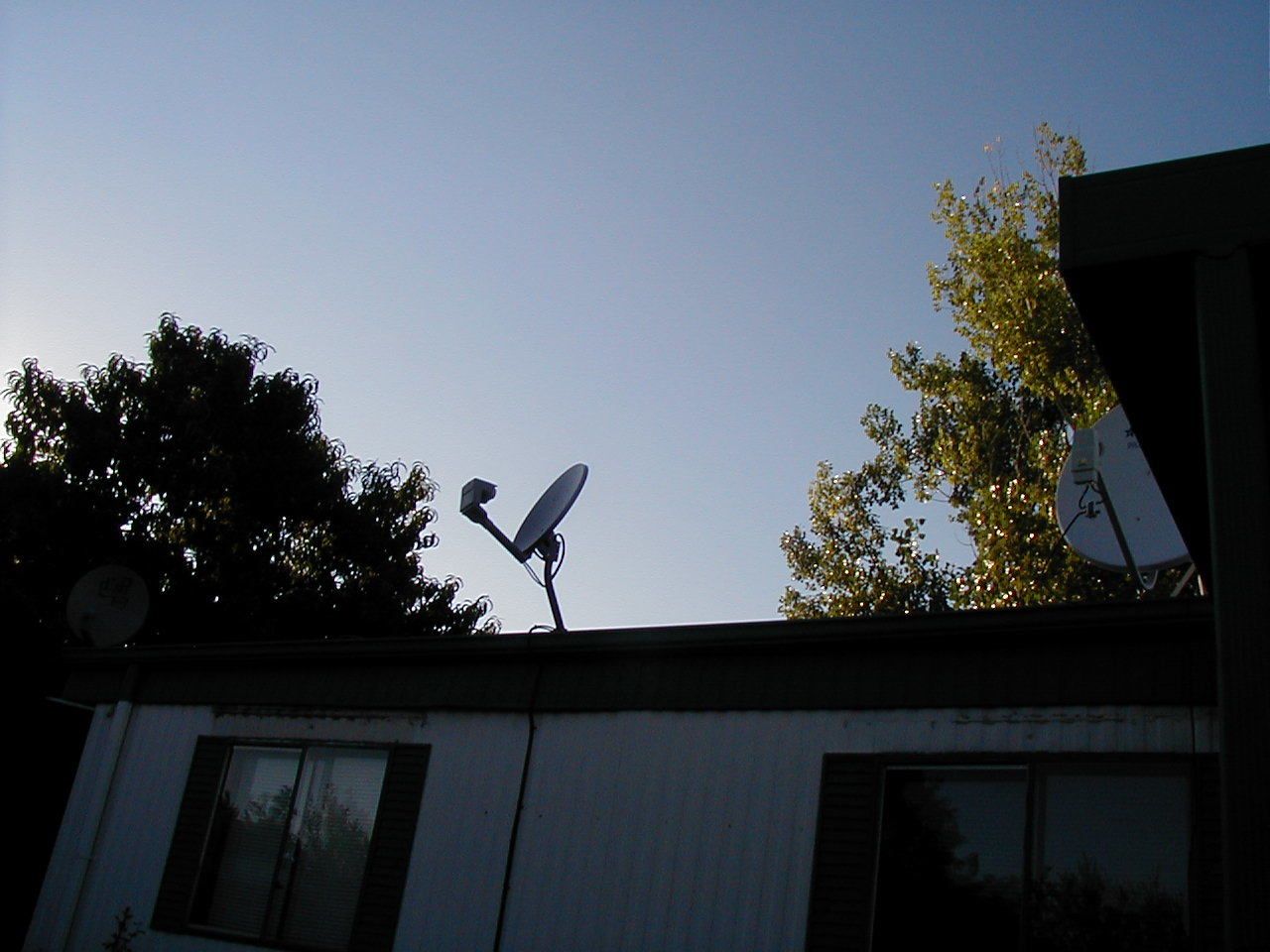

My new setup

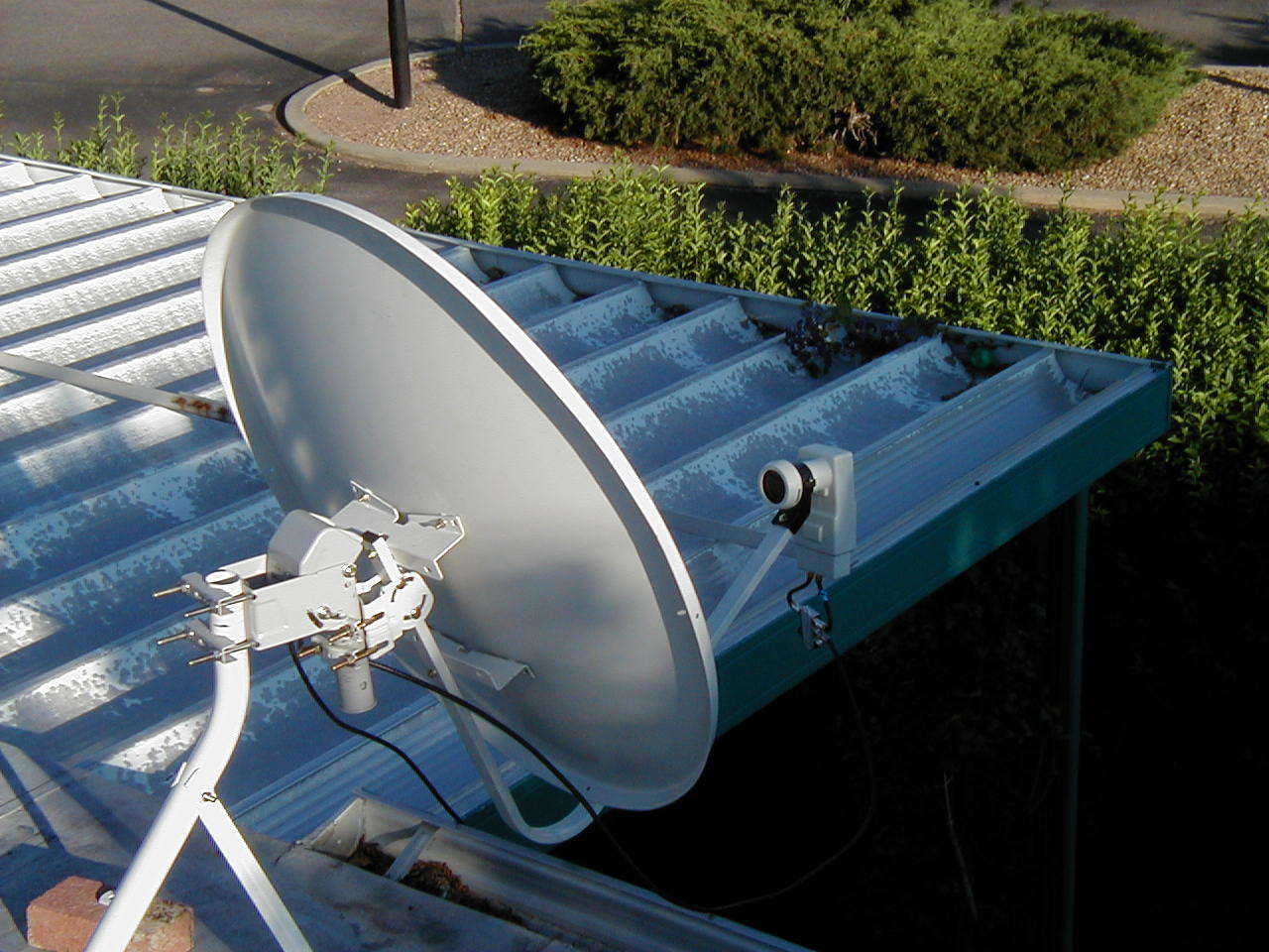

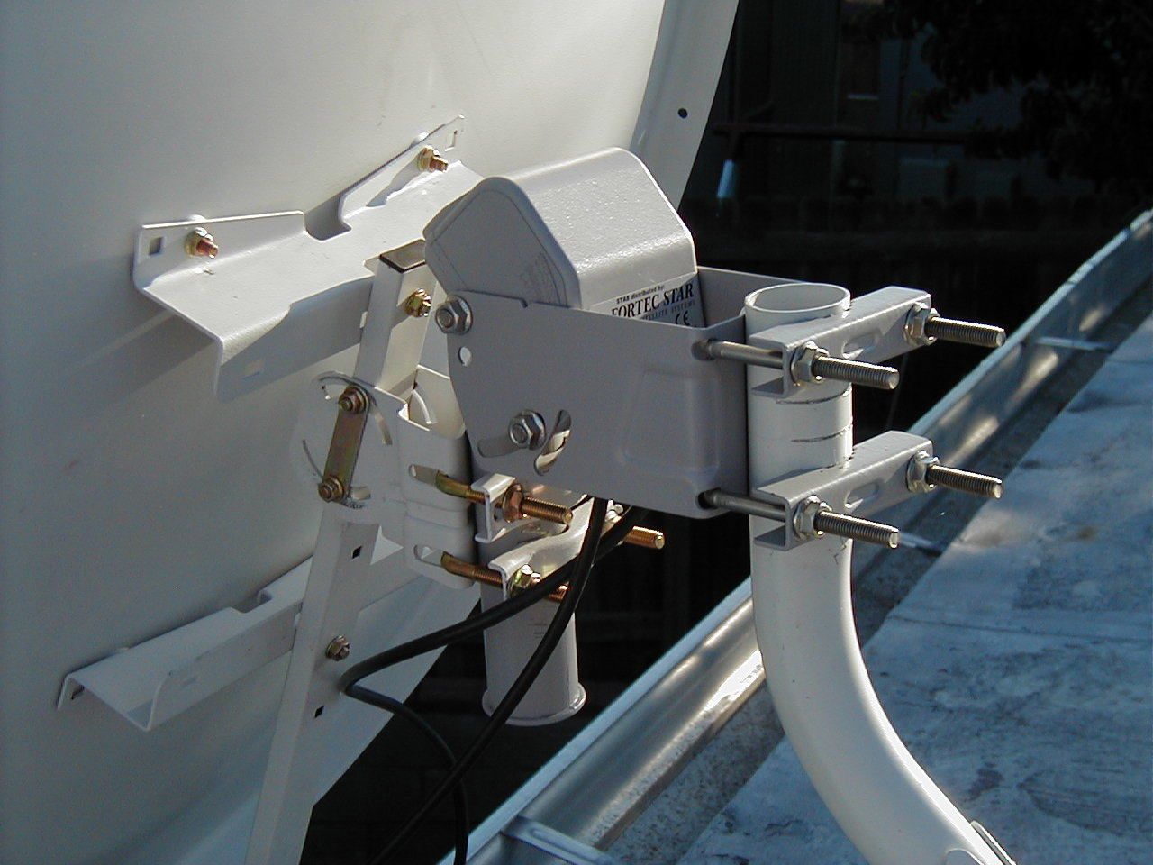

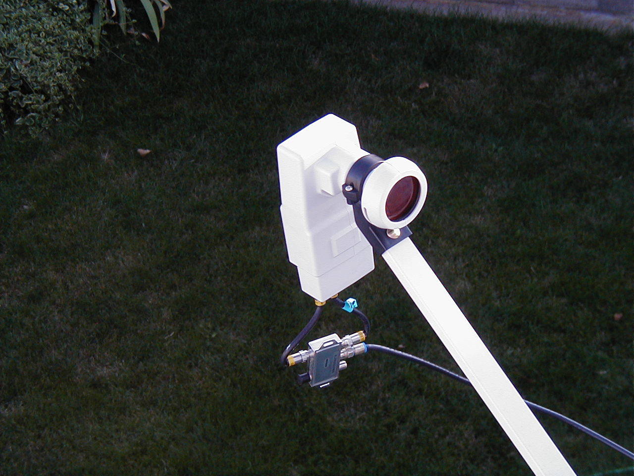

I thought it was finally time to post pics of my setup. I got the LNB from pete, and the motor and dish from Sadoun. Fortec 90cm dish with U-bolt mount, STAB HH90 motor, and invacom QPH-031 circular/linear combo LNB. generic diseqc switch (which needs to be weatherproofed... a job for duct tape.)

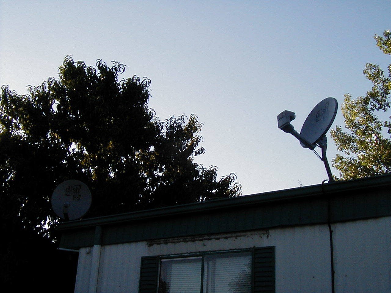

The other dishes are a dish 500 pointed at 110/119 and a dish 300 pointed at 61.5 for the voom pack.

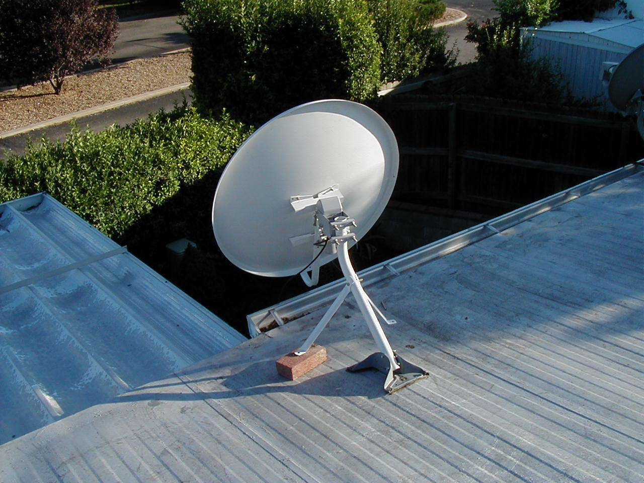

the roof is slanted in such a way that the stabilizer arms would not stabilize, so I put a brick underneath one of them. eventually I will have to go back up there and put another brick under the other one. but the brick that is there now solved a slight lean to the left. that brick was the difference between a 45 and a 90 quality reading on my true south sat (105)
the original mount that the white pole is in came from my older winegard 30". the pole from the winegard was too short for this larger dish, so I had to modify the fortec pole by drilling an extra hole.
