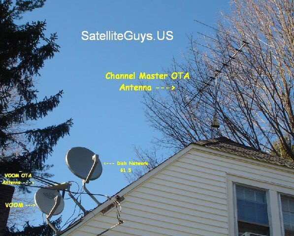

Cool shots, Spyder.. I just got a new windows background : ) Those are the best pics I have seen. I have to ask what is with the invacom on the the mesh dish if you have a 1meter with an invacom and also have a norsat ku on the mesh? Just to run independent receivers?
Actually they all operate on the main receiver via the 4X diseqc. The Norsat ku lnb is only a standard 11.7 to 12.2 lnb. The Invacom gives me the ability to catch the lower band atlantic ku signals with the benefit of the large gain 10ft antenna. I get booming quality on that rig.
As for the seperate dishes,I like beeing able to watch more than one news feed at at time :D

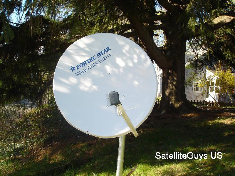

OK here is my setup.
The FTA setup went in yesterday. It took me all day to do, and its still not tracking the arc properly. I am able to get Globecast and a bunch of other things on IA5.
To get it I used USALS, I put the Dish on the mount then went into USALS entered my longitude 43.7w and latitude of 41.1n then told the receiver 9Lifetime Ultra) to go to IA5. Then I turned the dish until I got it in. :)
However if I go to 61.5 the dish only moves a few clicks so something is not setup correctly. I still have some tweeking to do.

Great pictures! The LNBF on the Fortec/Motorized dish should be straight up and down, as it skews its self as the dish/motor moves, but like you said you are still tweaking. But you are off to a GREAT start!
Ahh the manual said I should turn the LNB 30 degrees clockwise, which is why I turned it as I did. :)
My receiver needs a firmware update as its really old and does not have a lot of the satellites listed in it. So I will try picking up a cable for it this weekend. I guess this update also fixes the clock problem, the clock on this unit is always off. Its strange having a digital clock that does not keep the correct time.
BTW if anyone from CT knows this dish and motor and wants to help me track the arc please let me know. :)

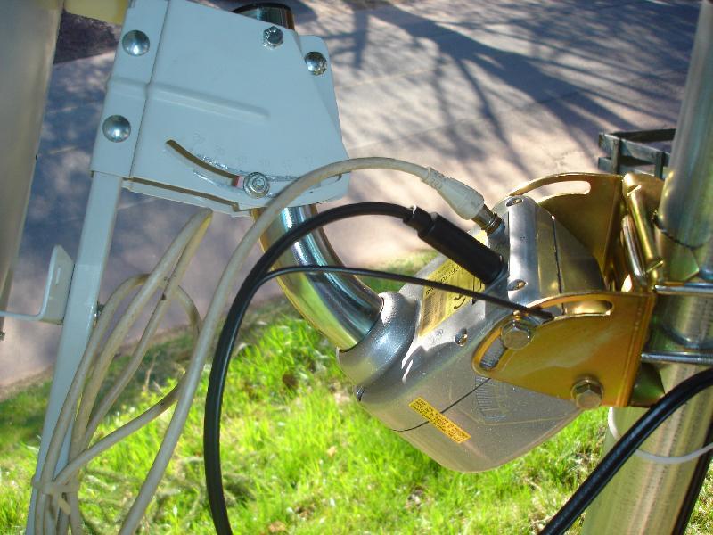

ultatryon said:
Umm.. is that photo upside down? or is the motor upside down?
Photo is not upside down.
Is the motor upside down?
That could be a good reason why it's not tracking the arc. :)
Can someone tell me if it is indeed upside down?
As far as I know, it is supposed to have the pole going down, not up. I am not 100% sure on this (as I dont have my motor yet), but the images I have seen show it down.
Yes Scott its "inverted" I was not MAN enough to tell you.......don't shoot the messenger : )
Its the Satcontrol SM3D12
