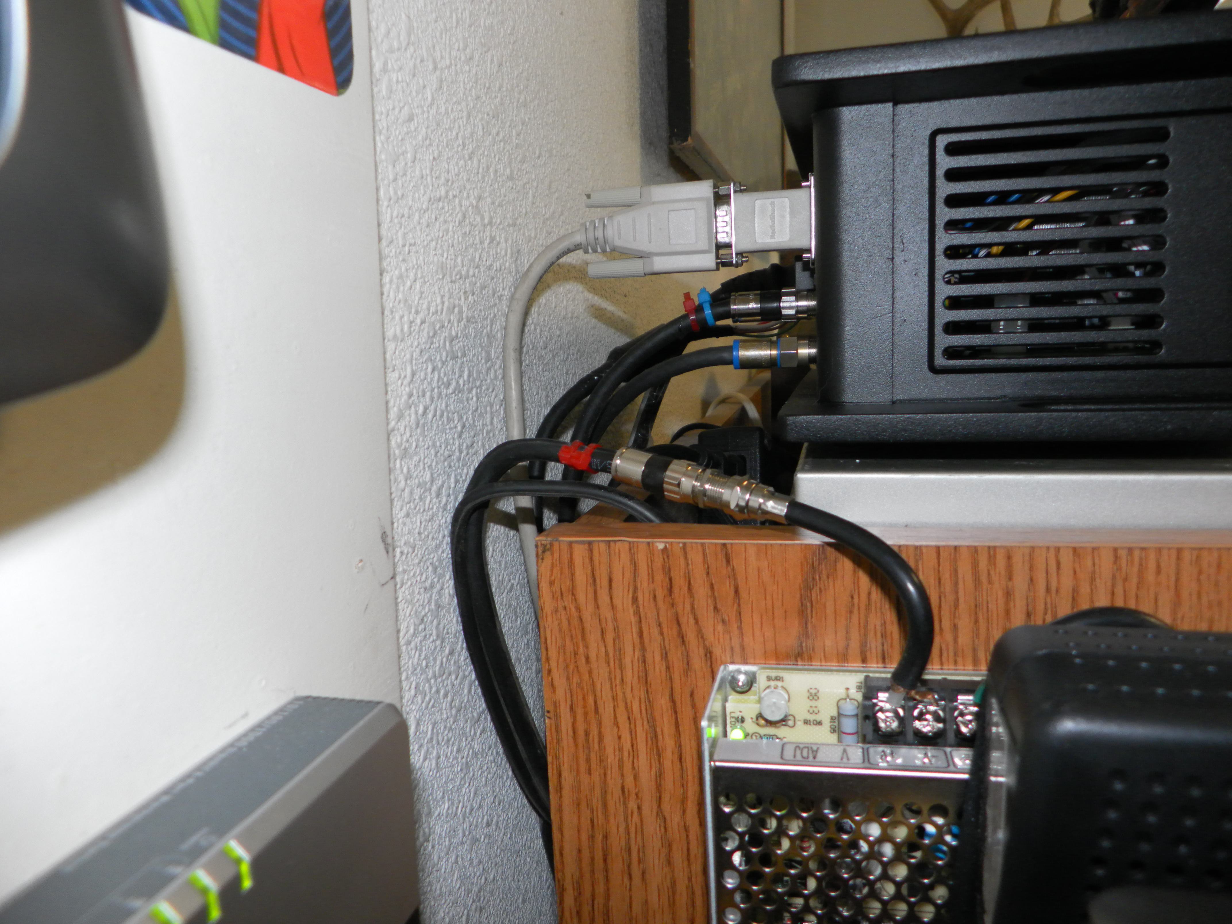

One thing about the original setup: the move to powered LNBs left me without a battery backup on the whole system like I had before. So I moved the power supply inside plugged into the back-up and send power to the switch via a coax. I decided to try the other switch mod Pendragon had devised with a Zinwell WB68. http://www.satelliteguys.us/threads...6x8-Switch-with-Power-Insertion?highlight=wnc

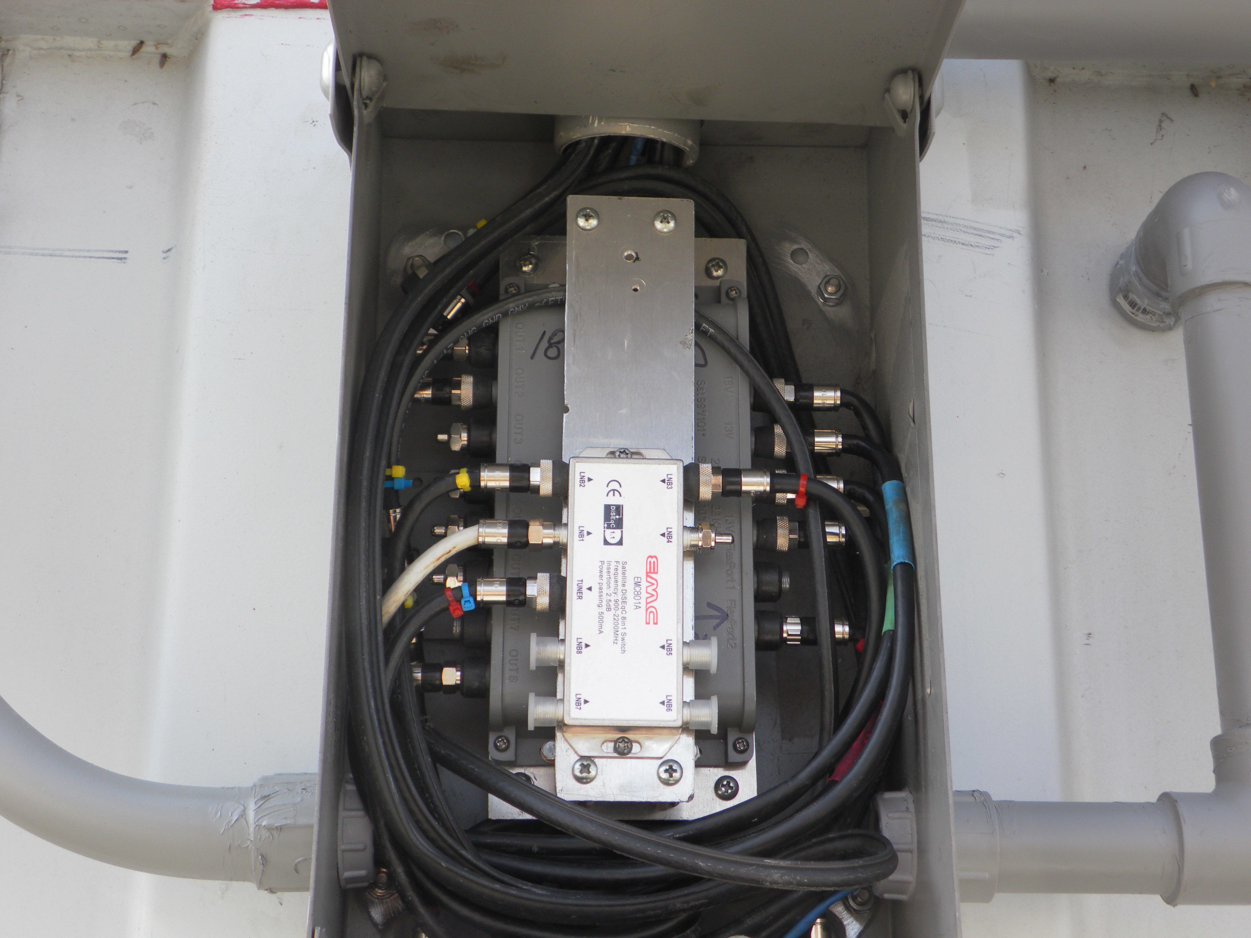

In this mod none of the power sent to the switch by the power supply is used by the switch and therefore does not contribute to the heat build up. I then moved the switch outside of the container into a Square D circuit breaker box I scrounged up. I mounted this on the north side of the container and it only sees the early morning sun. The switch is slower than the 4X8 switch but works very well so far :). I will be monitoring temps this summer.

The first pic shows the power supply that powers the LNBs. The ASC1 would be powering the switch only. The PLLs do seem to handle the weaker channels better. But the difference is subtle.
Ditto: Very nice. I'd also consider some thermostatically controlled power ventilation.
Or 'fins' al-la heatsink on the box. (my thinking is "a sealed box is a sealed box")
