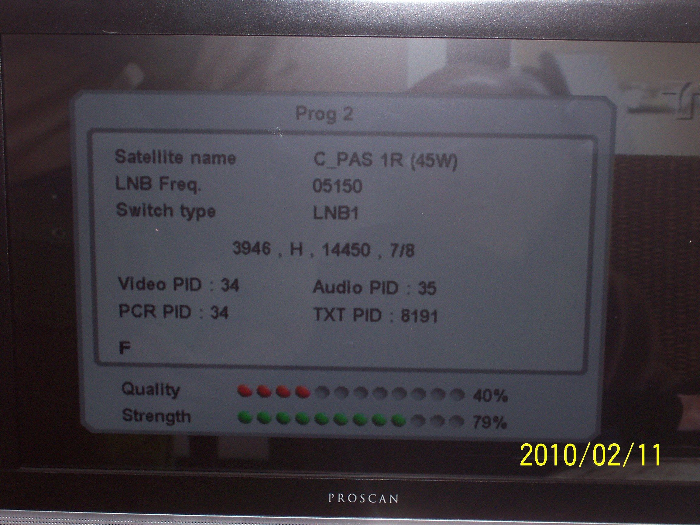

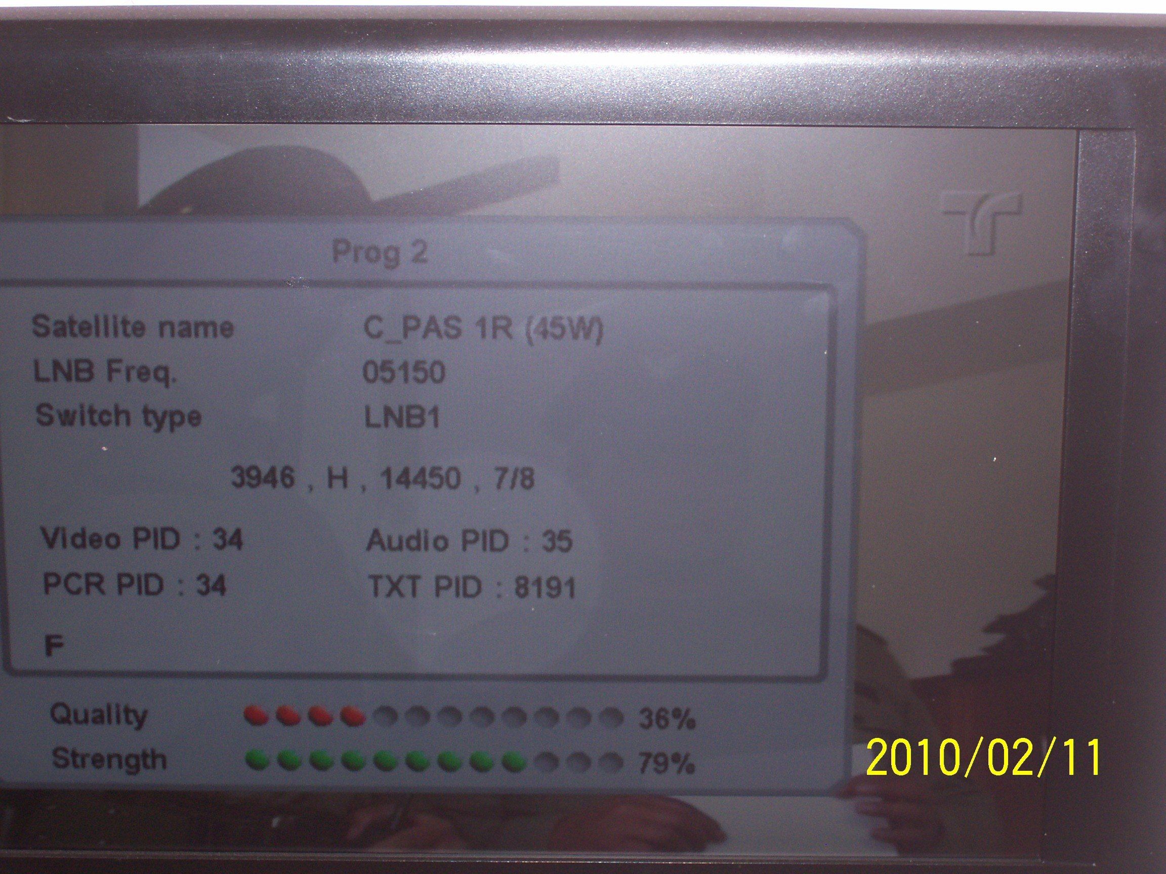

PR Locals are up again on Intelsat 14@45
tomorrow if you can check the signal quality. It sounds like satellite wobble and the dish size is on the "edge" of the footprint
I see that here in MN with the 30" dish when I scan Dish 110 & 119. Some times in the morning if I blind scan I can faintly get a hit on a spotbeam that is out of my area. Good example is 119 TP5 that covers Milwaukee & Chicago
SatelliteGuys.US - Subscription 119°W
I can pick that up once in a while
Went to the roof fixed the dish a little got now in that TP around 40q and 78s with a 4.5'
