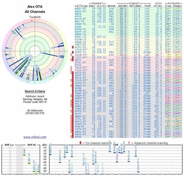

It’s CBET-DT Channel 9.1 Hi-VHF My antenna is about 8 feet off the ground. Attached is my tv fool report

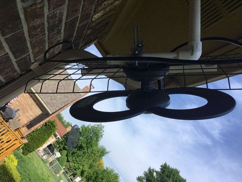

IMG 0311

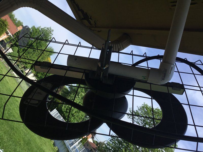

IMG 0312
Do you have the VHF dipole attached? Or can I not see it against the brick?
No, This is the older Clearstream with no dipoles

An appropriate antenna is probably going to serve you better than amplification given that what you want is all in the yellow or better.
You have two VHF-high channels now (WJBK and CBET) and will be adding another (Daystar) as part of the repack. The Clearstream is UHF-only so it isn't doing you any favors on RF channels 7 and 9.
