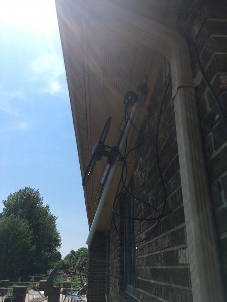

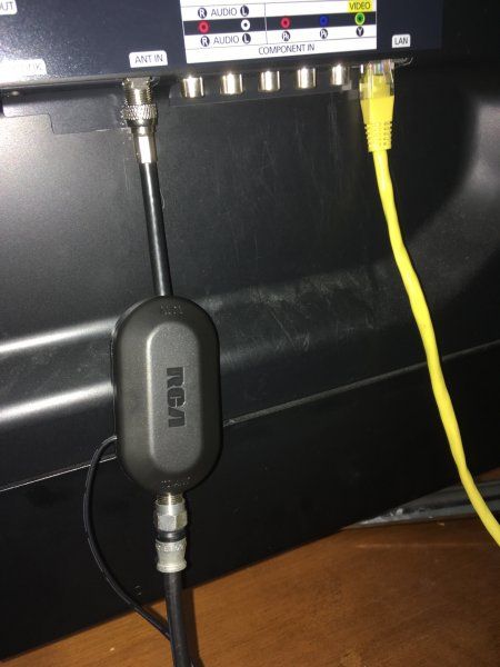

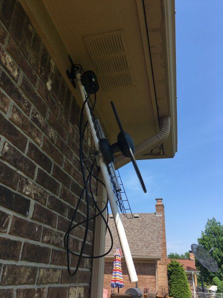

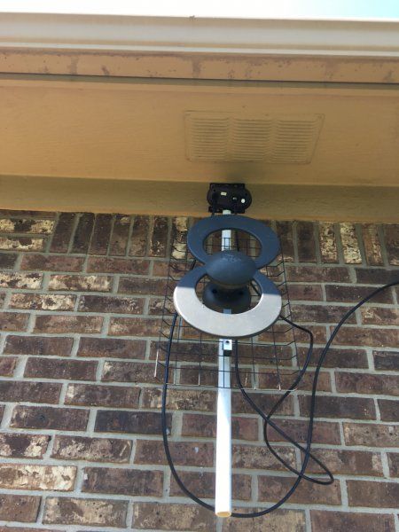

I know it's the wrong antenna, but I'll still need an amplifier when the 7 footer arrives . I had some time on my hands today so I decided to try once again on my Clearstream. I added the amp, redid the mast, and pointed the antenna. Amazingly, it worked! CBC isn't pixelating anymore and I'm getting all my local VHF channels plus TVO which I wasn't getting before. The only thing that's concerning me about the RCA TVPRAMP1Z is the short piece of RG59 going from the power inserter to the TV. Other than that this preamp helped a lot!

I know it's the wrong antenna, but I'll still need an amplifier when the 7 footer arrives . I had some time on my hands today so I decided to try once again on my Clearstream. I added the amp, redid the mast, and pointed the antenna. Amazingly, it worked! CBC isn't pixelating anymore and I'm getting all my local VHF channels plus TVO which I wasn't getting before. The only thing that's concerning me about the RCA TVPRAMP1Z is the short piece of RG59 going from the power inserter to the TV. Other than that this preamp helped a lot! View attachment 133285View attachment 133286View attachment 133287View attachment 133288

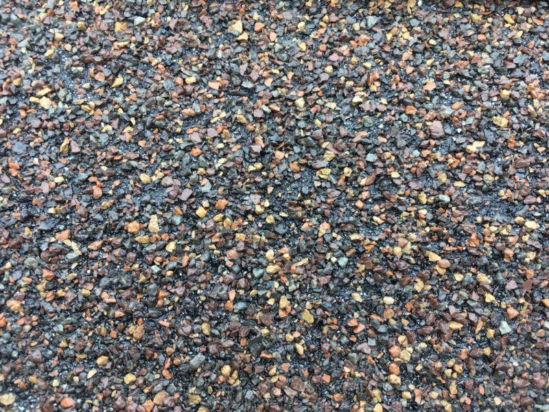

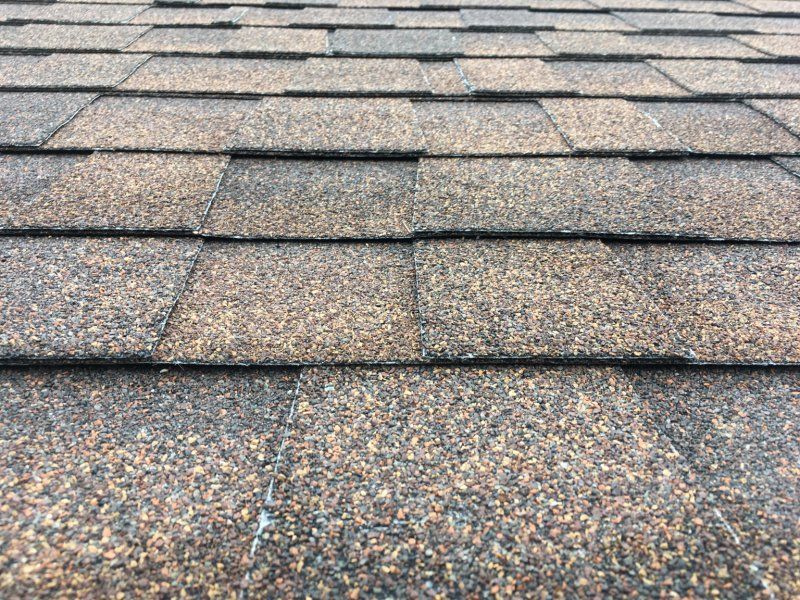

I can't put the antenna outside or strap it to my chimney. The best I can do is a attic installation. I don't know what materials my shingles are. It's just plywood and the shingles
Reactions: comfortably_numb
Asphalt and stone chips do a fairly good job of attenuating TV signals as does the plywood sheathing beneath. As foliage and rain can do a number on reception, rocks and dirt do much more damage. Its a lot like wearing headphones over earplugs except that with RF signals, there is the added complication of interference (like wearing headphones playing death metal over earbuds playing classical piano).
You may or may not be able to pick up a usable signal at 50 miles with the best antenna given that you're adding your roofing material and that of many of the homes in your neighborhood if you're not above roof level. TV signals ideally travel in a straight line between the broadcast antenna and your antenna and the more obstacles you present, the less desirable signal gets through. Elevation to clear those obstacles is helpful.
