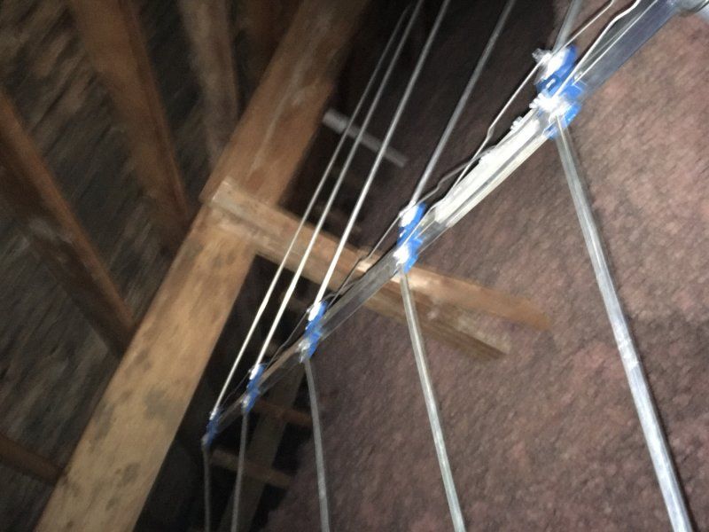

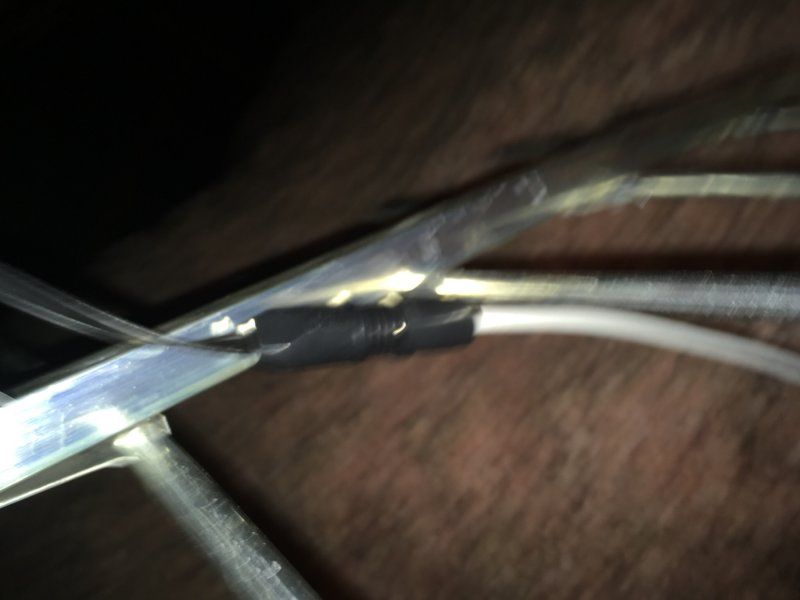

Soldering is great, but remember that these elements make for really great heat sinks.I think I'll just solder it back together.
60/40 doesn't, but there are solders (and the attendant fluxes) that are made specifically for aluminum soldering.Solder doesn't stick to aluminum.

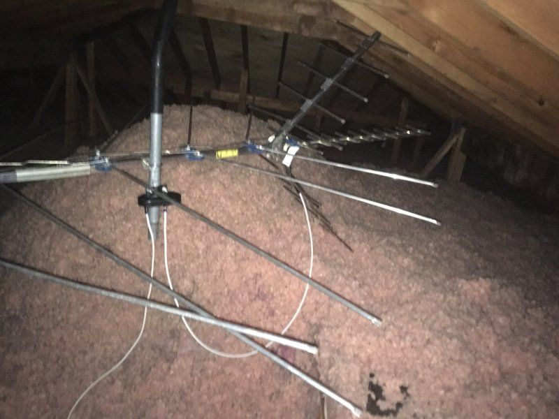

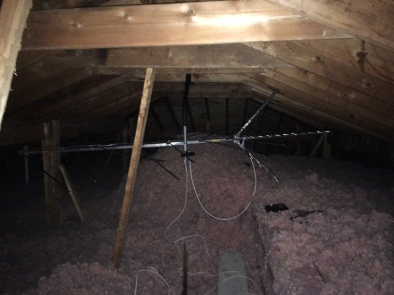

I had some time yesterday so I tested it out. I wasn't able to pick up Global or CHCH but I guess that's to be expected because they are in the red zone. What is the point of the lower boom on the VU120? Is it just for support?![]()
For the extra support/strength.Bigger antenna so there's more wind load and it is "split" in the middle so it helps with that and a second clamp on the mast.What is the point of the lower boom on the VU120?
