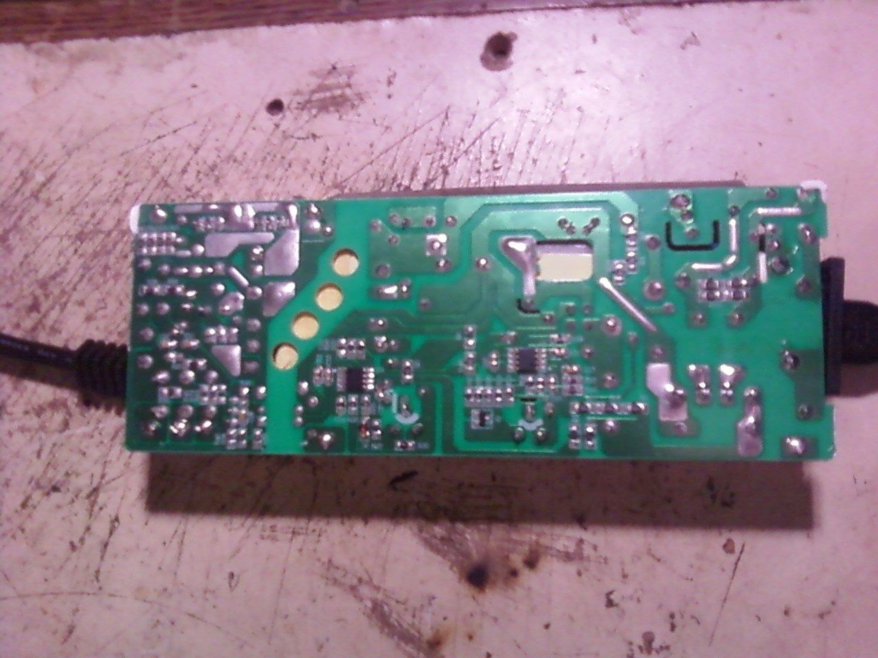

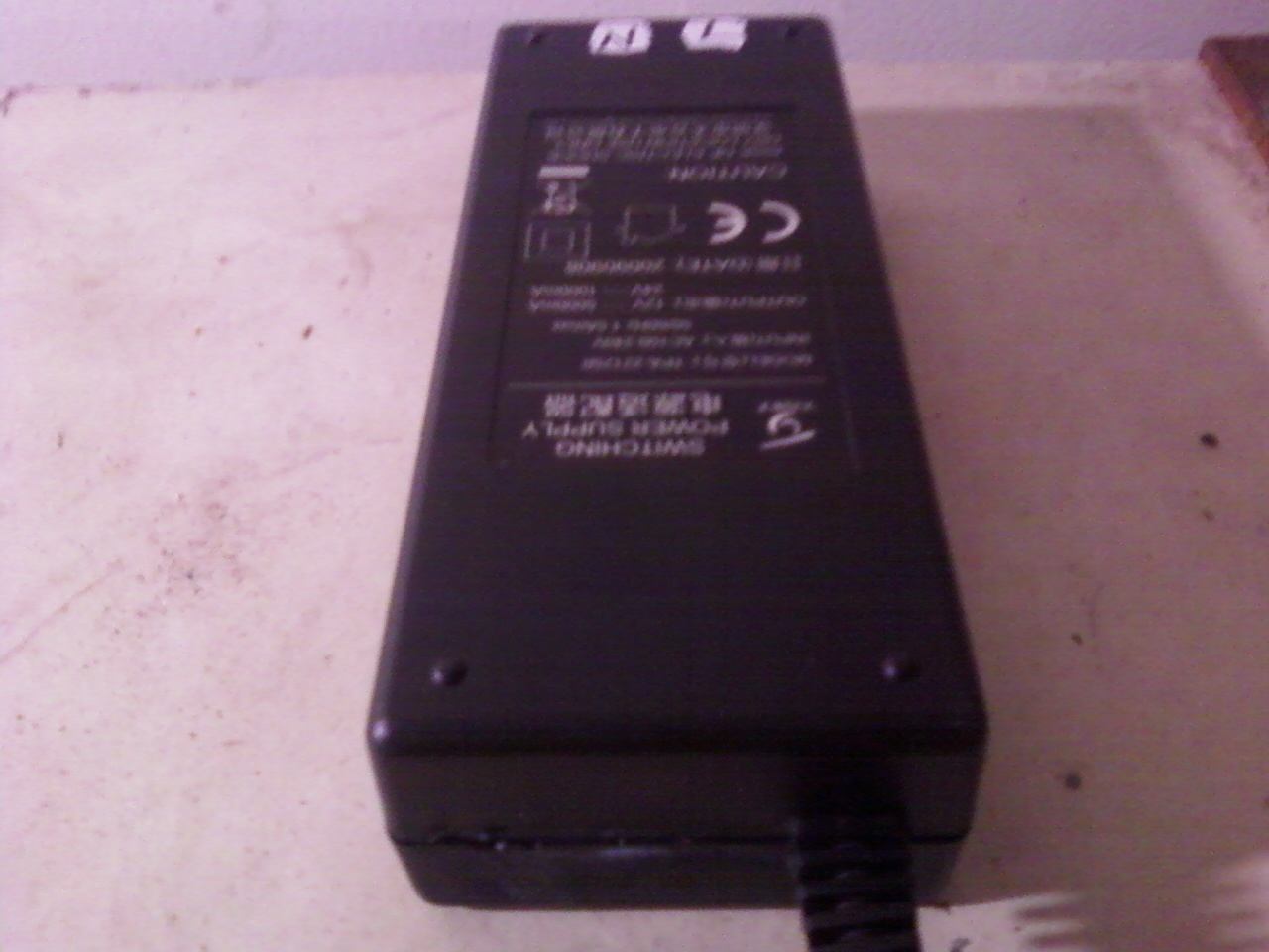

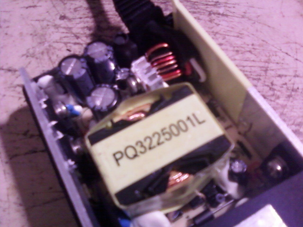

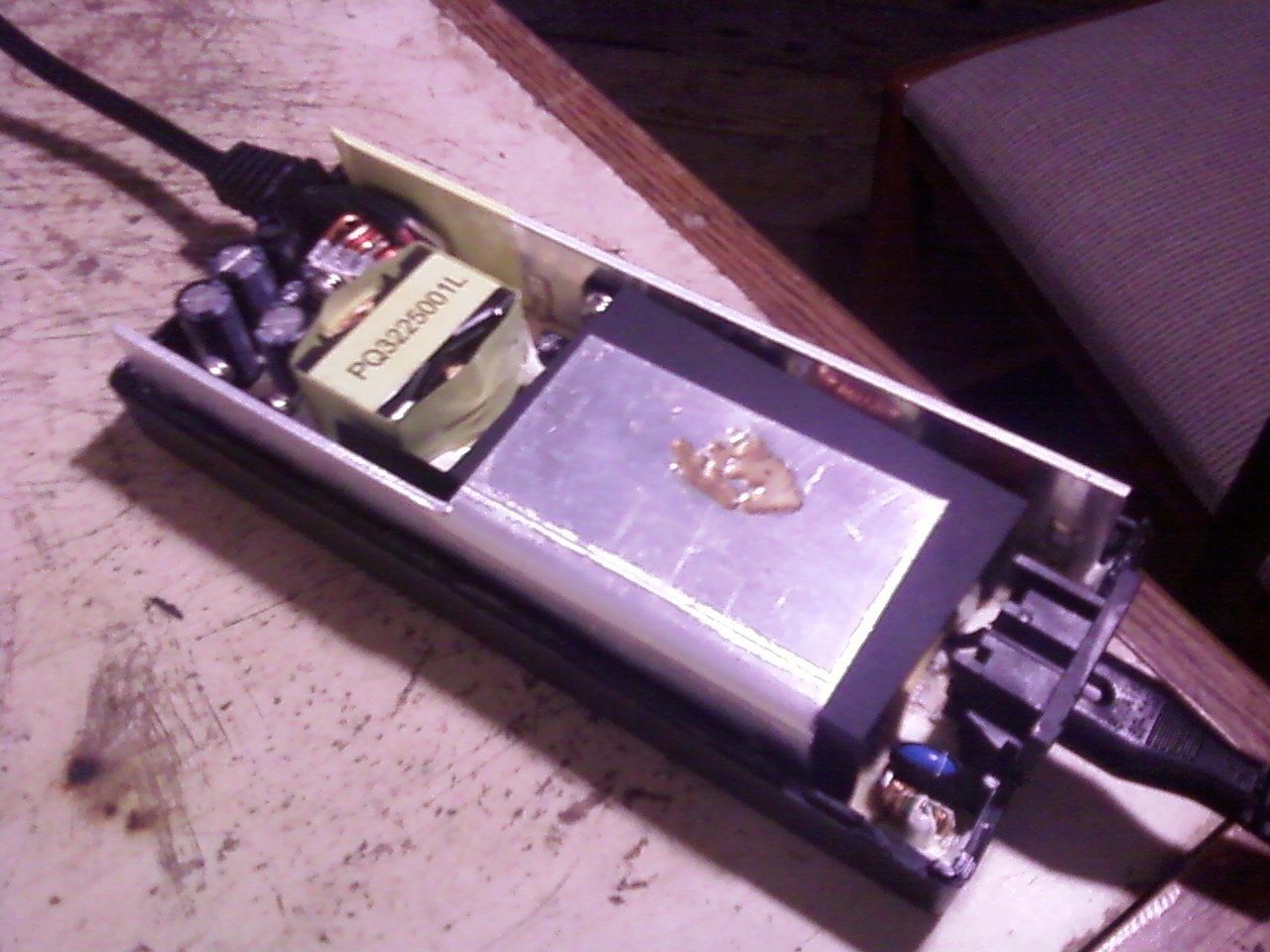

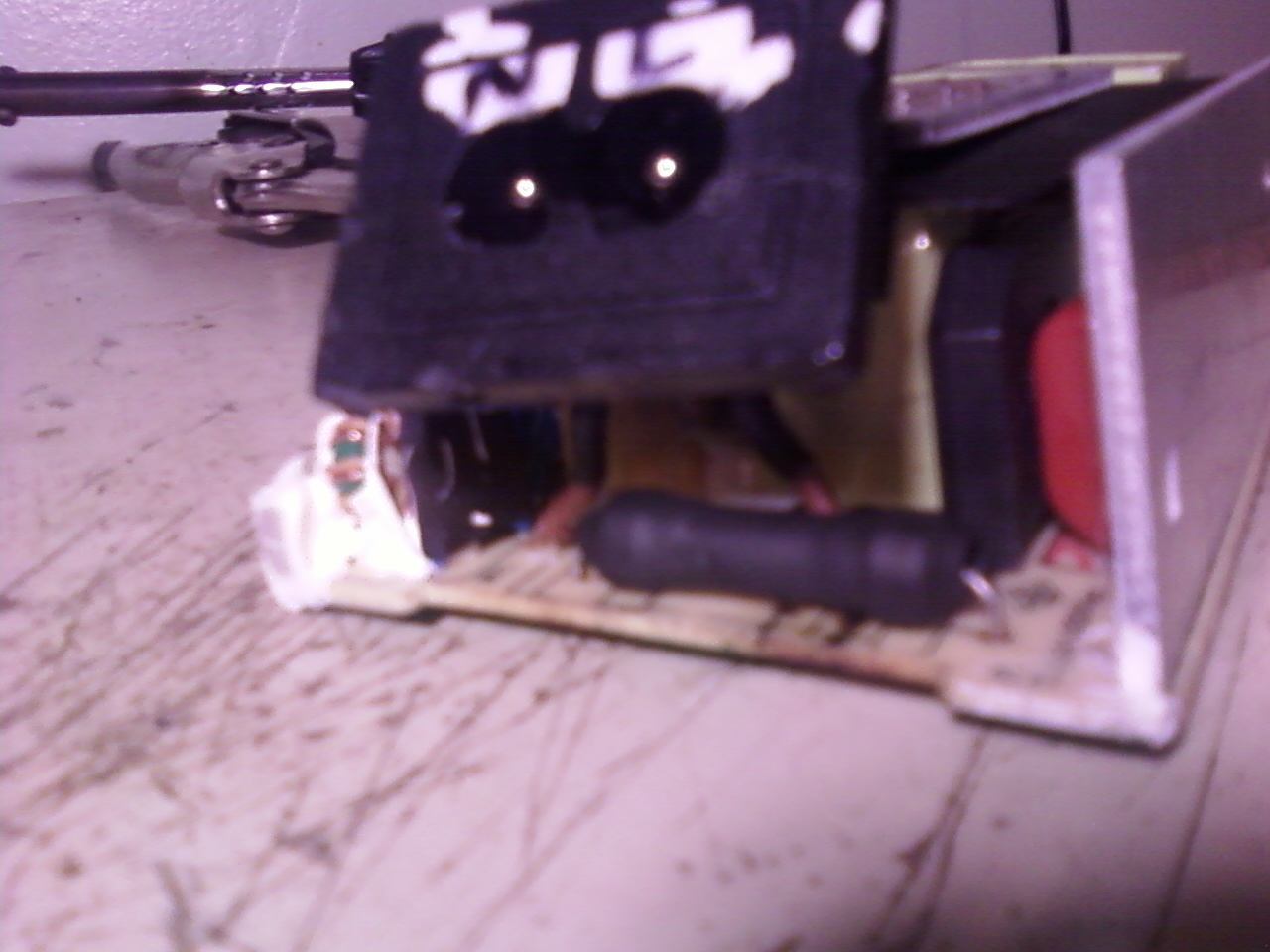

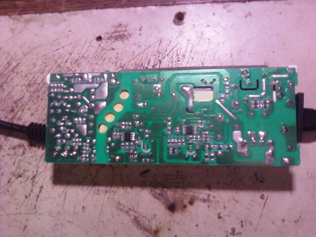

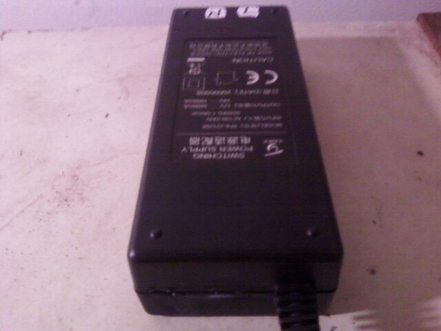

so i decided to try and fix the power supply myself ... nothin to lose. the case is glued together so if you're concerned about keeping it intact for warranty replacement i wouldn't recommend it. AC line 3.15A ceramic fuse was open. no sign of visible damage. no shorts detected using ohmmeter. replaced fuse with 2.5A fast blow and it seems to work now. did notice on circuit board that line and neutral wires were designated so i marked my supply case so i can get them right when i plug it in.

so i decided to try and fix the power supply myself ... nothin to lose. the case is glued together so if you're concerned about keeping it intact for warranty replacement i wouldn't recommend it. AC line 3.15A ceramic fuse was open. no sign of visible damage. no shorts detected using ohmmeter. replaced fuse with 2.5A slow blow and it seems to work now. did notice on circuit board that line and neutral wires were designated so i marked my supply case so i can get them right when i plug it in.

Kevin, pretty impressive stuff that you did, congratulations on your technical expertise. Maybe I'm not looking close enough but can't really tell where that AC line Ceramic fuse is. Good luck with the fix, doing it yourself sure saved you the hassle of returning the Power Supply to Florida, and no AZbox likely for a month or so.
Kevin,
Glad to hear you were able to get your PS fixed. Not sure if its too late or not but would you be able to take a higher resolution (and clearer picture) of exactly what you replaced? I'm sure you won't be the last person to have a PS go bad and your efforts would probably help a lot of people who find themselves in a similar position.

just be very careful if you remove the power supply from the case. give it at least 20 minutes from the time you unplug the power supply till the time you touch the circuit boards with your hands. some capacitors in switching power supplies like this can hold an electrical charge for a long time after the unit is unplugged. there is the potential (pun intended) for a very nasty electrical shock if you grab hold of the circuit board with both hands. gotta cover my bum with that disclaimer. you never know who's gonna google the thread and try replacing the fuse.
i am still troubleshooting this thing. i suspect one of the switching transistors is bad.
the fuse is underneath the input connector. its the black cylindrical thingy with wires coming out the ends and a rubber like coating on it in the picture. best i could do with my cheap cell phone camera.
