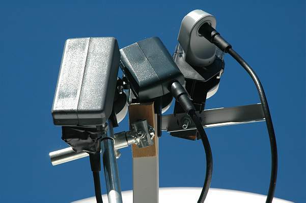

If you look at the photo I posted earlier on this thread, you can see that the IA7 LNB is above the top of the LNB arm. If you have a bracket or a piece of flat metal you can bolt on to the top of arm, then you can rest your hand on this while you aim. When I aimed for it I had the bracket in place (a different one from the picture). As well, I had the LNB in a LNB holder which helped in the aiming at the correct angle to the dish.

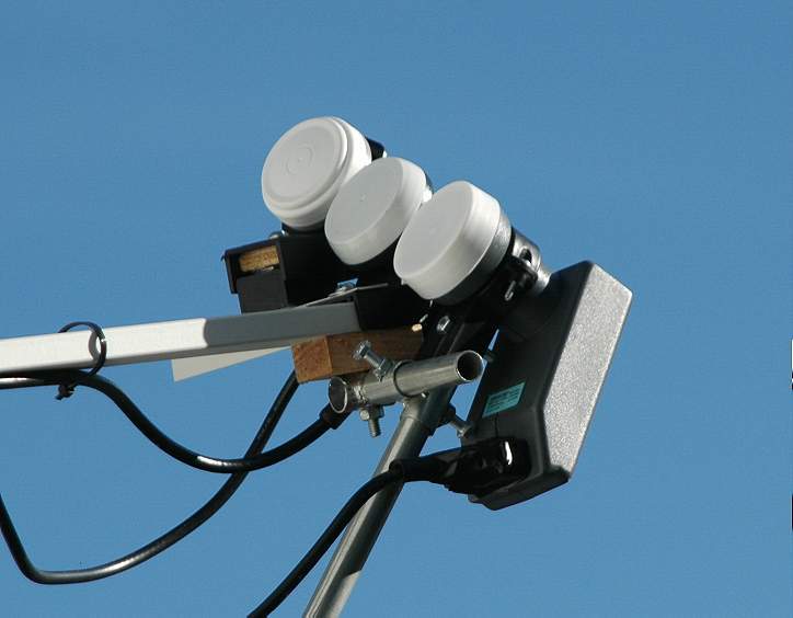

Don't know whether the attached photos will help any, they show a side view and a view from underneath. The distance from the centre bolt to the bolt for the IA7 LNB is 2 inches, but the LNB holder is slightly twisted. Your LNB would have to be a bit higher than mine.

Don't know whether a 2 inch piece of wood would make it too far apart or not, but as you can see the IA7 LNB on mine points slightly inwards towards the G10R LNB from the bolt, if it was parallel to it I would get no signal.
