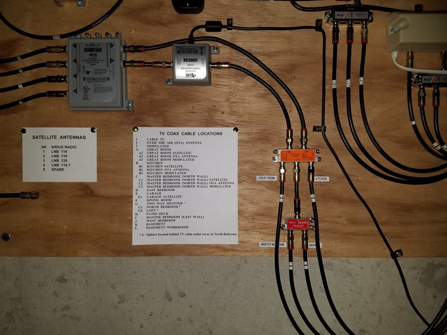

My two Hopper 3s are connected with a Duo Hub. Only one H3 is connected to the Internet by Ethernet. Both Hoppers can see each other. It has worked great so far with no Hopper+.
