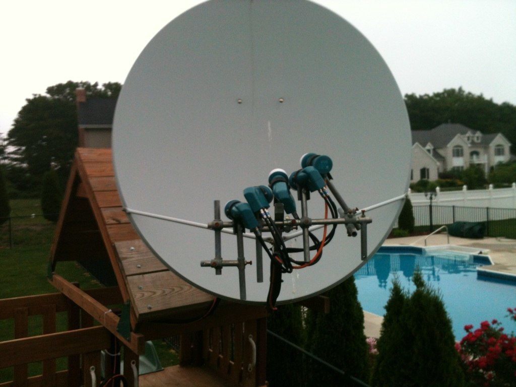

I'll tell you my idea, your project will go a whole better if u try this with a 1.2 meter four footer. I think u may find your offset lnb's with a 36" may be a problem.
I've easily managed 95/97, 101/103 and 123/125 combos on 1.2 meter ku dishes with no problem
Do you have any photos of these combos to post them here? I was able to receive 97 and 101 with some clipping of scalars of regular LNBs' on 36" dish. What was the distance from LNB to centre of the 48" dish? Cheers, polgyver
from left to right, 89 95 97 101 103
