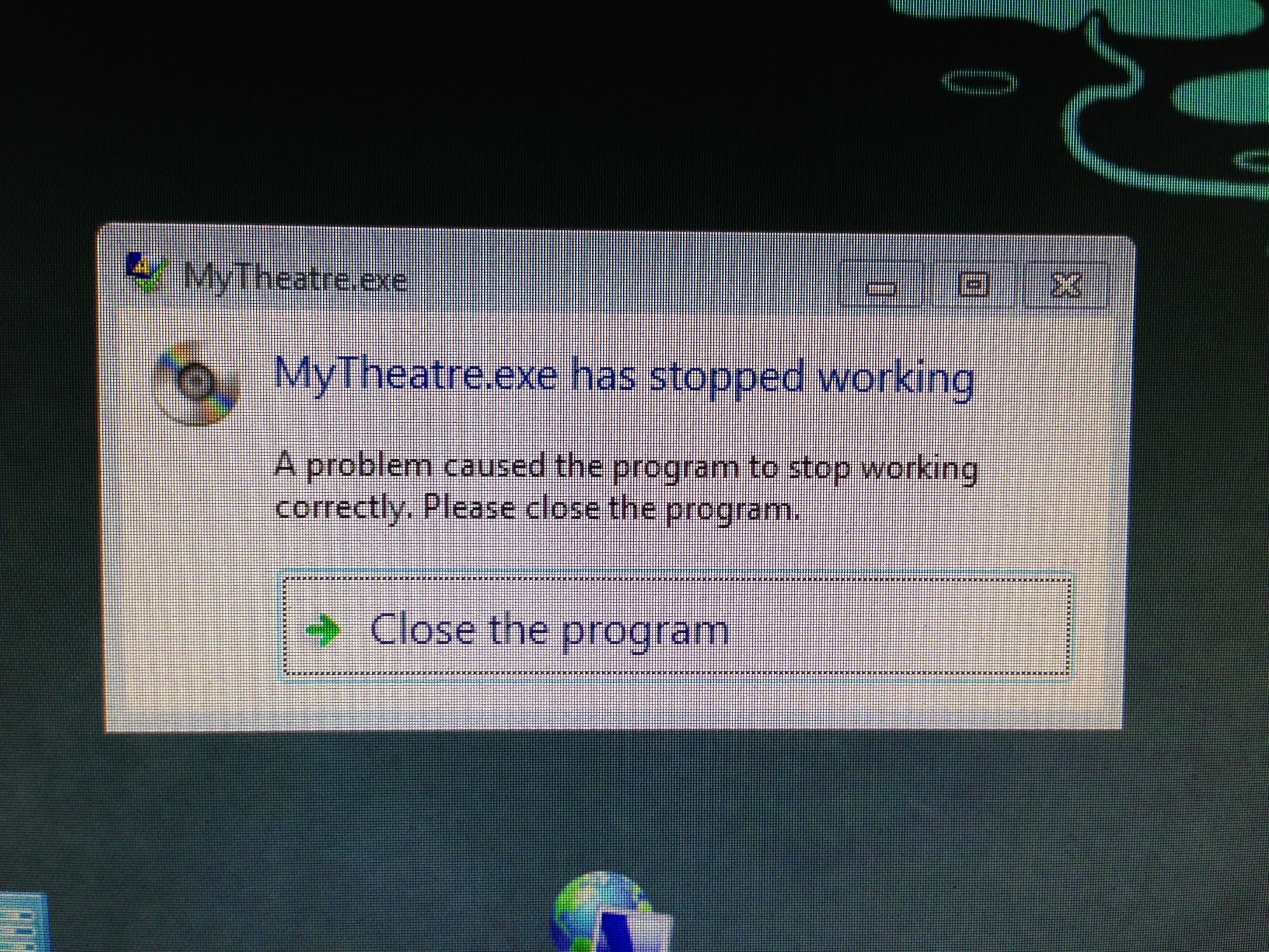

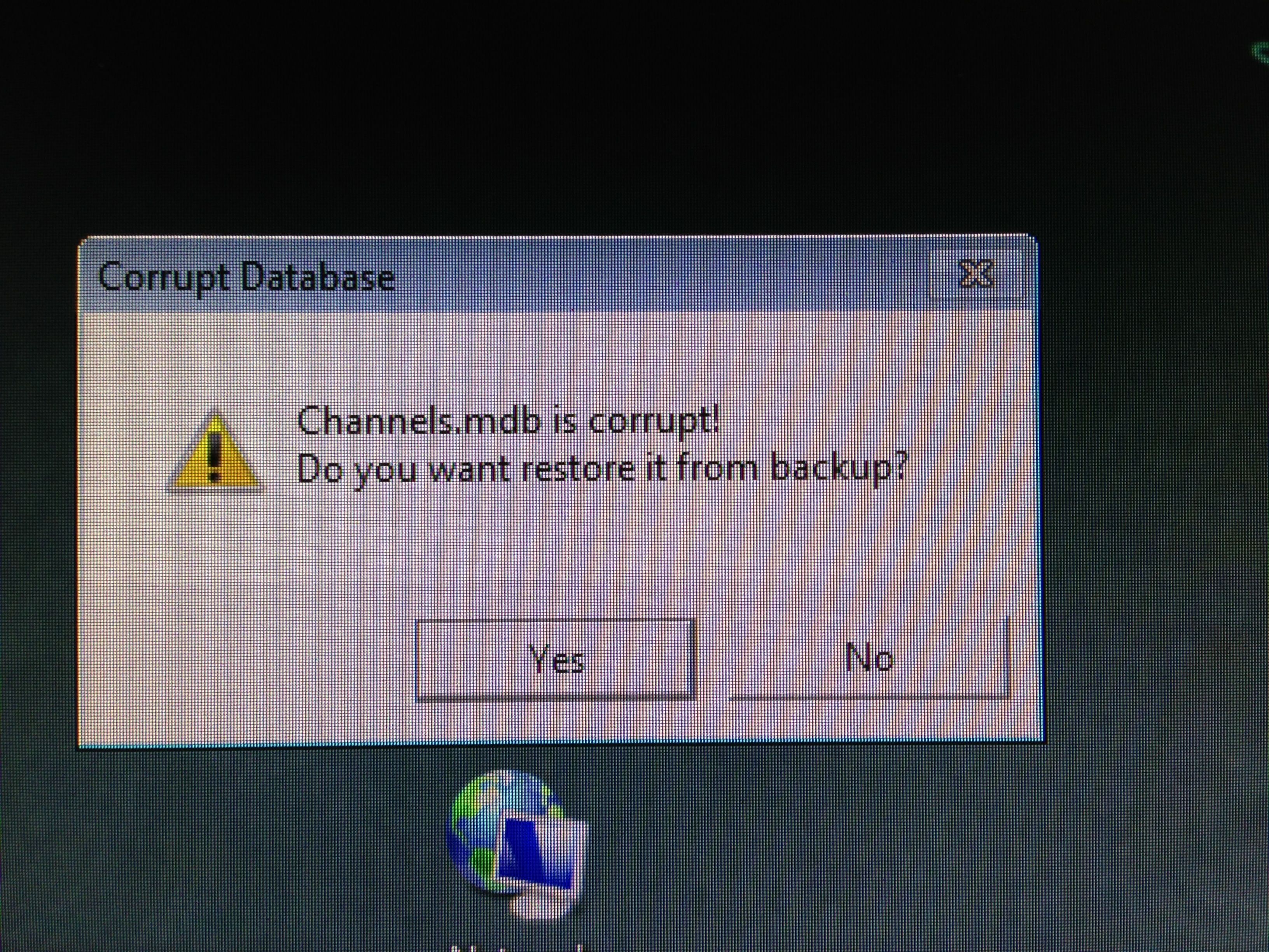

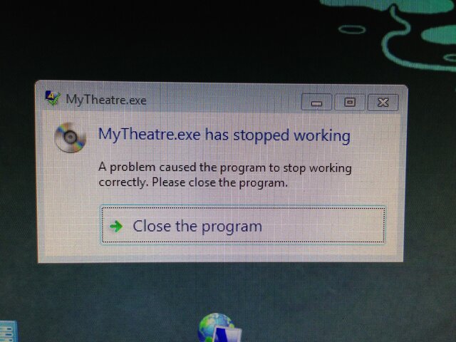

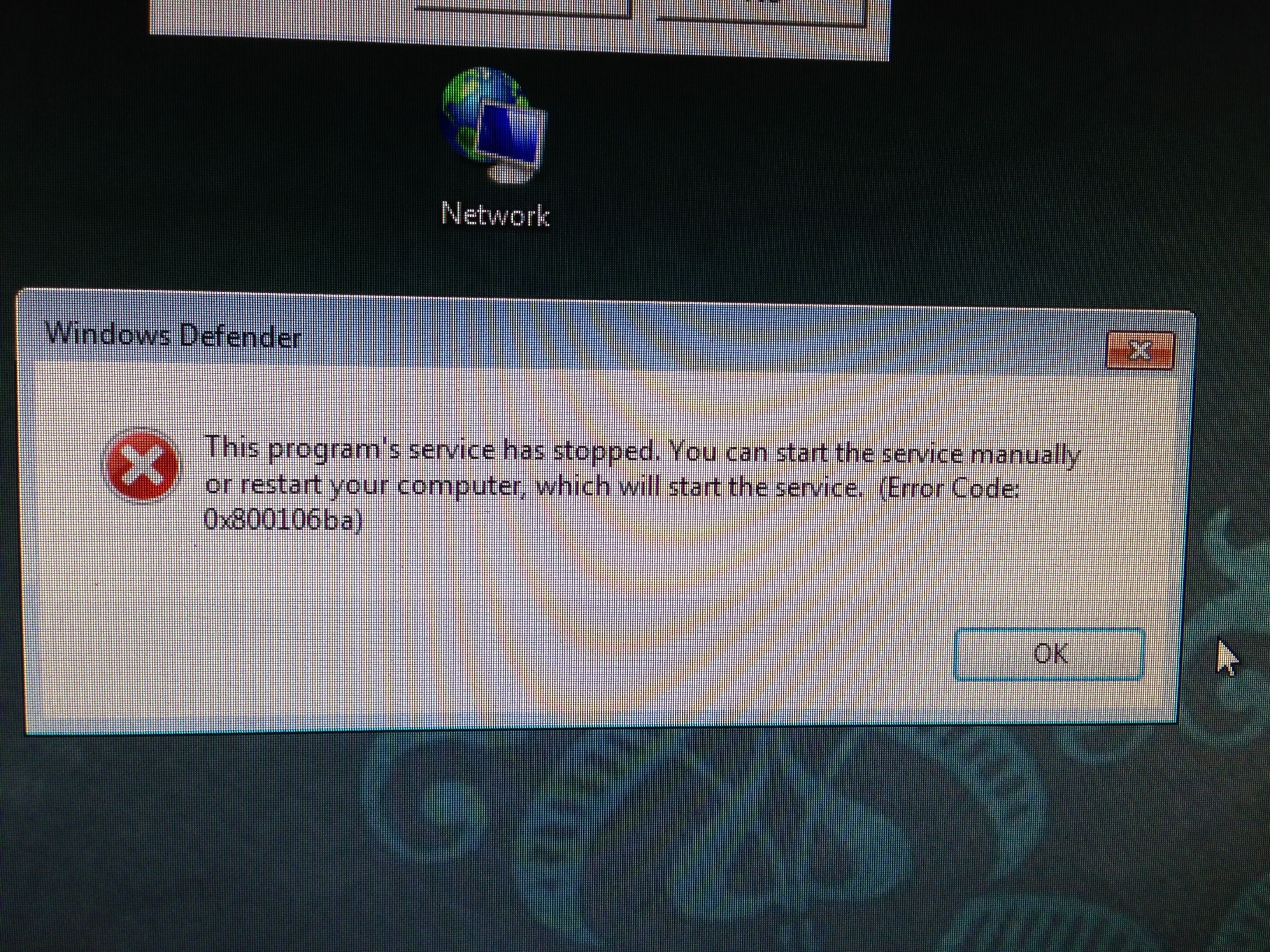

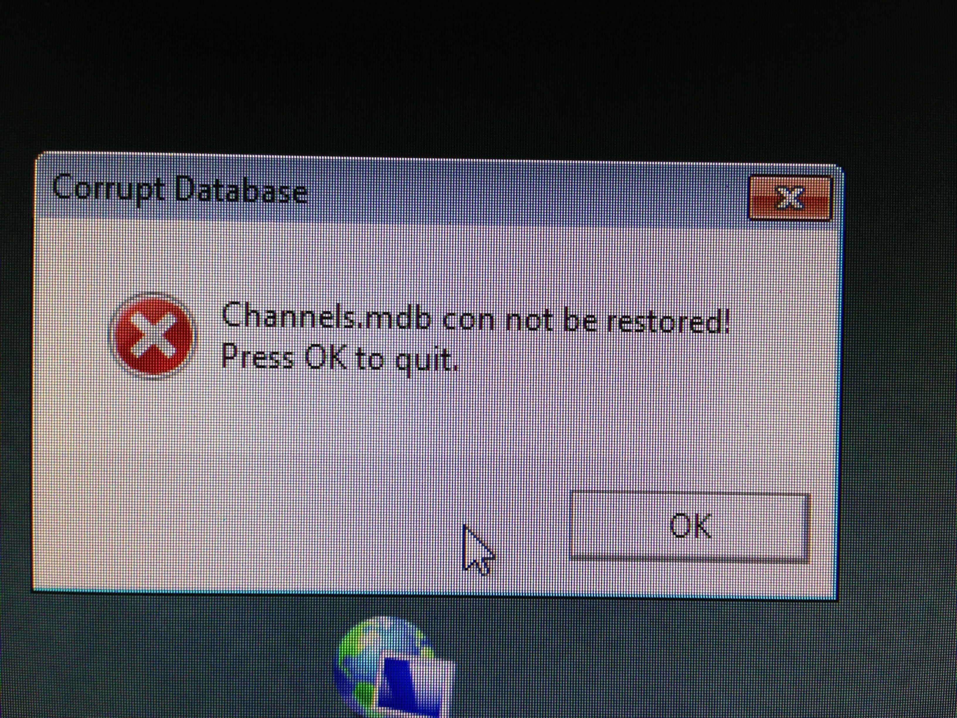

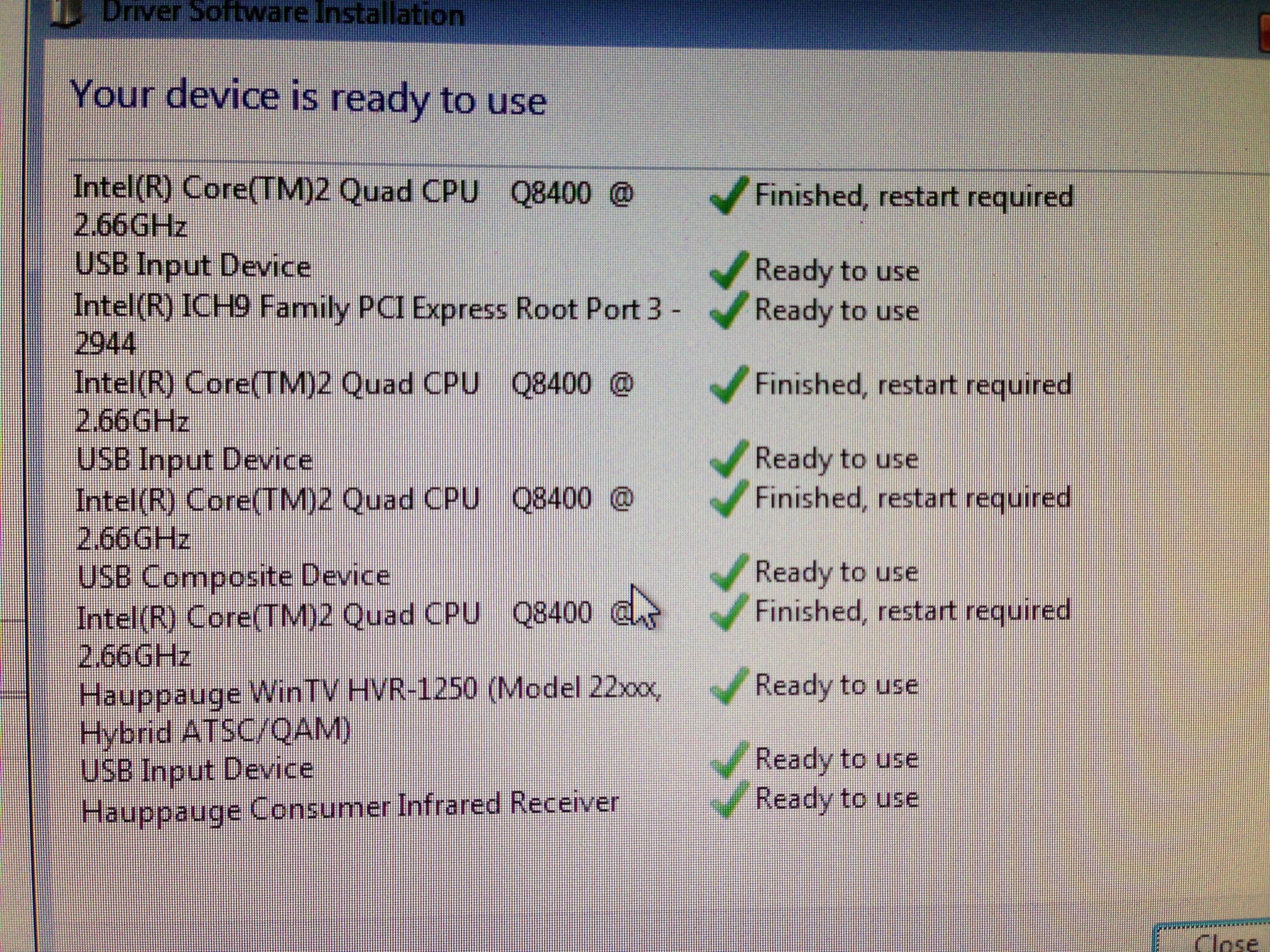

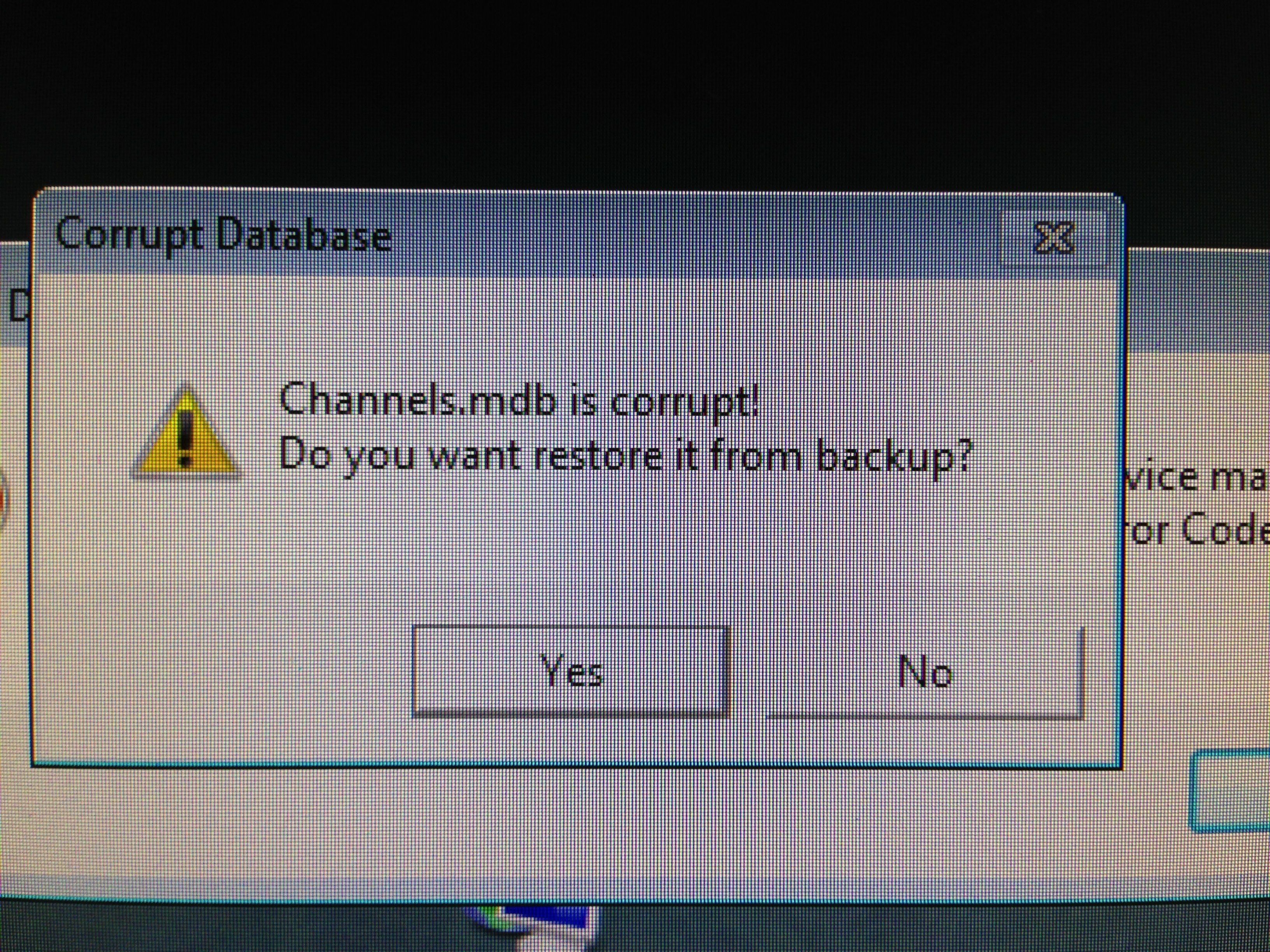

Ok, I made progress but at the same time, I'm stuck.
I went to Best buy and bought some silver diamond paste. (really??) Anyway.. I bought the goop.
I took the quad core CPU out of the dead motherboard, took the dual core out of the HTPC and switched them.
I gooped the CPU and put the fan cooler on it. When I powered the machine up it wasn't very happy about the new stuff but it came up and went through a long process of updating drivers and what-not..
It eventually came up to a working state. BUT, when I try to run My Theater it comes up with a message that says the channels.mdb is corrupt and asks if I want to restore from a back up.
I tell it yes and it errors again. Nothing I do will let the program start up now. EVERYTHING ELSE in the system works fine..
Does anyone know what this might be and how I can fix it?
Thanks!

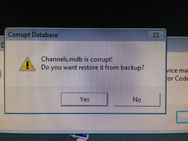

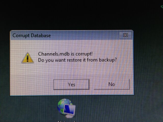

Thanks!

I got it working..
When I was swapping things around I broke the data connector on a 2 TB disk. :o
I used some epoxy glue to stick the broken plastic part back but I need to let it set up for a few days so I can't plug it back in just yet.
Well, that was my D: drive. And my PC was setup to use D: for the temporary files.
It was using D:\TEMP and D:\TMP for whatever it needs to use that for.
Well D drive is kaput for now and not plugged in.
No temporary folders so programs were pooping themselves trying to access something that's not there.
I found where to change the settings in windows manager and everything works just fine now. :D
