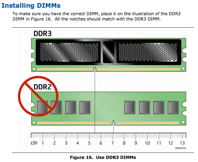

I ended up buying a new motherboard that the old CPU would fit in. I thought I was careful of the details but when it came in the memory sticks wouldn't fit.
Turns out the old motherboard used sticks called DDR2. The new board, even though it used the old CPU it takes newer memory sticks called DDR3.

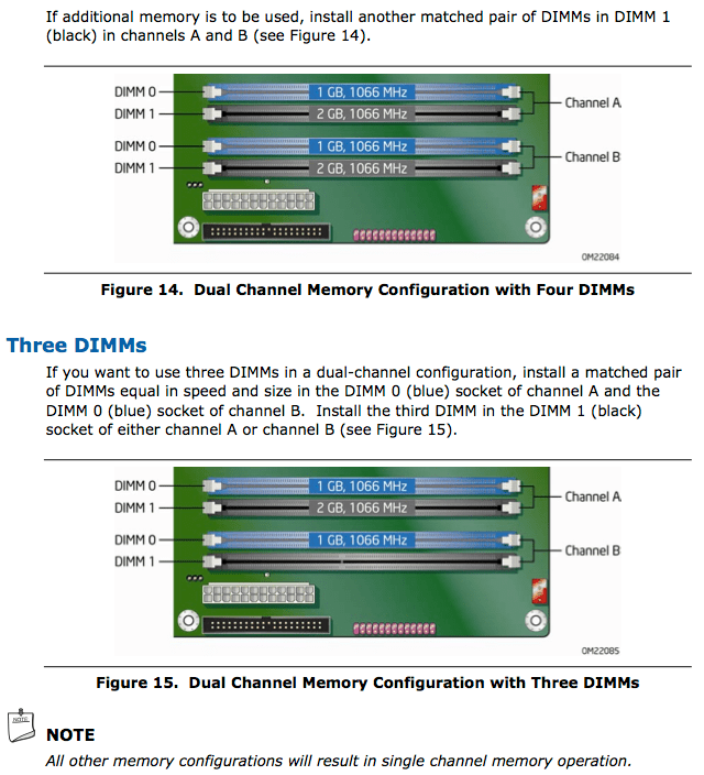

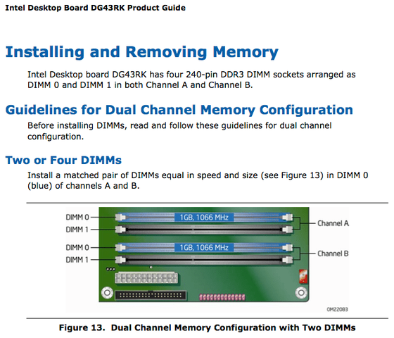

Dee, are you installing the memory in identical pairs and in the correct memory slots? The motherboard manual will describe the memory installation, and motherboards differ from manufacturer to manufacturer. Some require that one bank be filled before another, and the banks are often separated from each other, not consecutive. There should be a diagram showing the proper installation and order of population.
The manual shows that there are four memory slots and they are labeled DIMM0 through DIMM3. It says to put one in DIMM0 and one in DIMM2, skipping a slot so they are one in every other slot.

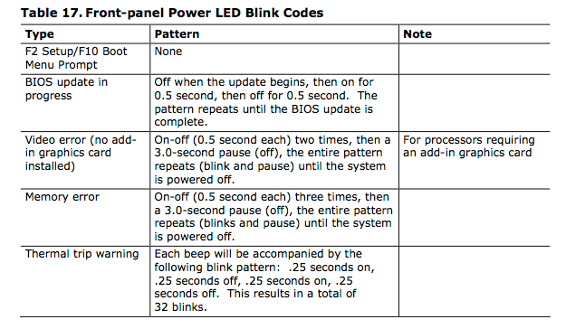

According to the beeps it makes and the lights blinking when I power it up, there is a memory error.
The manual says the memory has to be SPD. I have no idea what that is but it says it is absolutely required.

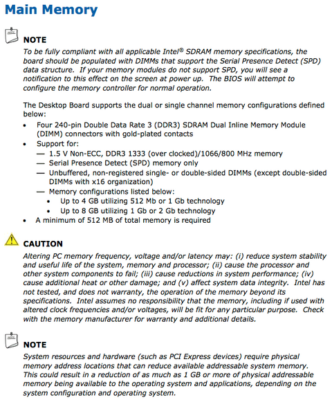

Maybe you can tell me if this will work. I was thinking that MAYBE it's because I bought the cheapest memory sticks I could find. Maybe that's the problem.. ?? Yes? No? I don't know.. :confused:

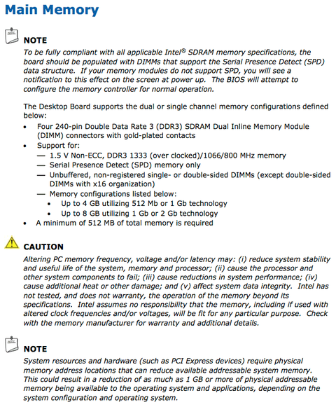

I went to the Intel site and found the following info about my board,
System Memory Features
  • Four Double Data Rate 3 (DDR3) SDRAM Dual Inline Memory Module (DIMM) connectors with gold-plated contacts
  • Non-ECC, 1.5 V, DDR3 1333(OC)/1066/800 MHz memory
  • Serial Presence Detect (SPD) memory only
  • Unbuffered, non-registered single- or double-sided DIMMs (except double-sided DIMMs with x16 organization) (I DO NOT UNDERSTAND THIS PART)
  • Up to 8.0 GB utilizing2 Gb technology
  • A minimum of 512 MB of total memory is required
To be fully compliant with all applicable DDR SDRAM memory specifications, the board should be populated with DIMMs that support the Serial Presence Detect (SPD) data structure. This allows the BIOS to read the SPD data and program the chipset to accurately configure memory settings for optimum performance. If non-SPD memory is installed, the BIOS will attempt to correctly configure the memory settings, but performance and reliability may be impacted or the DIMMs may not function under the determined frequency.

I followed a link on that page where they suggest memory that is known to work. BUT, they only list two types and those are discontinued.
Then I went to Crucial memory site as you guys suggest and I found this information
It says that the memory they recommend for my board is
  • Module Size: 4GB kit (2GBx2)
  • Package: 240-pin DIMM
  • Feature: DDR3 PC3-10600
  • Specs: DDR3 PC3-10600 • CL=9 • Unbuffered • NON-ECC • DDR3-1333 • 1.5V • 256Meg x 64 •

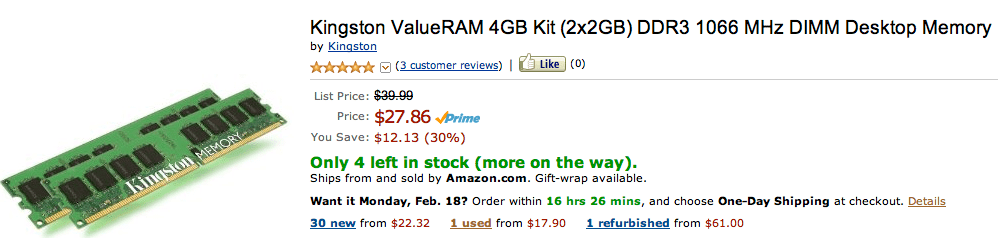

Now, the memory I bought is Kingston brand. I bought it from Amazon.com
Amazon gives this information on it,
Included in the package is two 2GB modules of 1066MHz DDR3 memory. Specs are 240-pin DIMM.

Another thing I am now taking into consideration is that after reading up on the server stuff, it says that, much to my amazement, that servers use lots of memory. That ZFS stuff, which looks really cool, apparently wants tons of memory.. Huh??? Why?? Oh well, never mind, my brain is about to melt down already..
So, I did a search on Amazon for Unbuffered, "Non-ECC , pc3-10600 , DDR3 DIMM, kit, 240-pin -notebook"
I'm thinking I should go ahead and get 8gb of memory so the server will be happy.
I narrowed down my search to stuff that is Amazon Prime available and I found this stuff for a reasonable price.
Silicon Power 8GB (2x4GB) DDR3-1333 PC3-10600 Non-ECC 240-Pin SDRAM Dual Channel Desktop Memory Dual Channel Kit SP008GBLTU133V22
The dufus on a skateboard does NOT inspire confidence in me, at all. But whatever.. If they think that makes the memory "cool" then more power to em.. Idiots.. :mad:
Anyway, Amazon was a little light on details about this memory so I googled the stuff and I found Newegg.com where they have a lot more detail (but a higher price!)

Designed to be highly compatible with different models of computers and motherboards using AMD and Intel platforms
I prefer to get the stuff from Amazon because I have a Prime account not to mention the overall price is lower than Neweggs..
Given what you guys know, in your opinion, if I buy this Silicon Power 8gb memory, would that be the right stuff for my board? Am I on the right track?
I'm really afraid to blow even more money and have even more useless stuff laying around. I just don't have a lot of money to work with but if I cut back and ride the next week out on Ramen noodles I can do it. (j/k!)
Thanks !! :)
