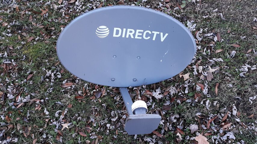

This is the Satellite Dish that I have.
I used one for a while, its size is definitely a limiting factor. I mostly used it on 30W, it was good for casual reception of the stronger transponders (Cuba, Arab league, Spain), but insufficient for the weaker transponders (Argentina, Uruguay). I also briefly used it on 34.5W Ku, but it would loose signal at the slightest rain.
So based on that, I would say that it should be ok for 95W CCTV/CGTN, and for NHK/RT/CGTN on 103W. It should also work quite well for KBS on 123W. As for 97W it should work ok, but might have interference problems on some transponders as 95W and 99W are quite powerful. (I had such problems with reception of 2M-monde and Canal Algérie). It might work for PBS on 87W and maybe even on 125W, but probably not reliably
You would probably receive other channels and satellites, but those would likely be very marginal receptions
in all cases, expect to lose receptions during heavy snow or heavy rain, as the limited size won't allow for much margin for signal degradation
In summary:
As etlam34 pointed out, you're probably not going to find your OTA channels (aka "diginets") on Ku band FTA. Investing in a better OTA setup (more height, more gain) may be more fruitful.
While the Slimline is the largest (22.5" high x 32.5" wide) pay TV dish currently deployed in the continental US (CONUS) for English language programming, it isn't particularly well-suited to reliable FTA use where a 30" "round" single focus dish is probably a practical minimum and 36" or greater is recommended.
