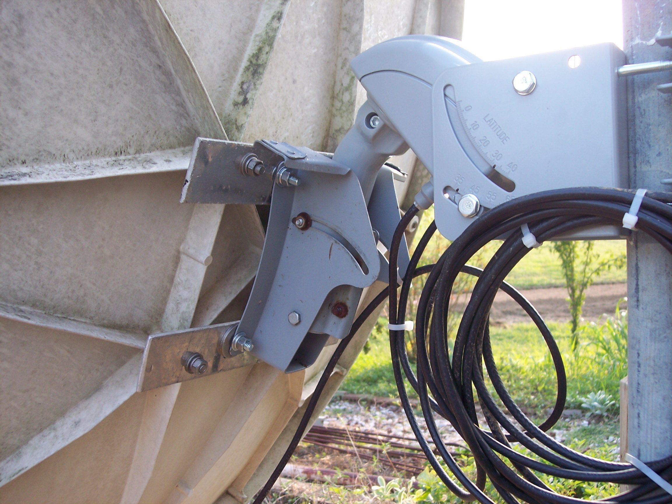

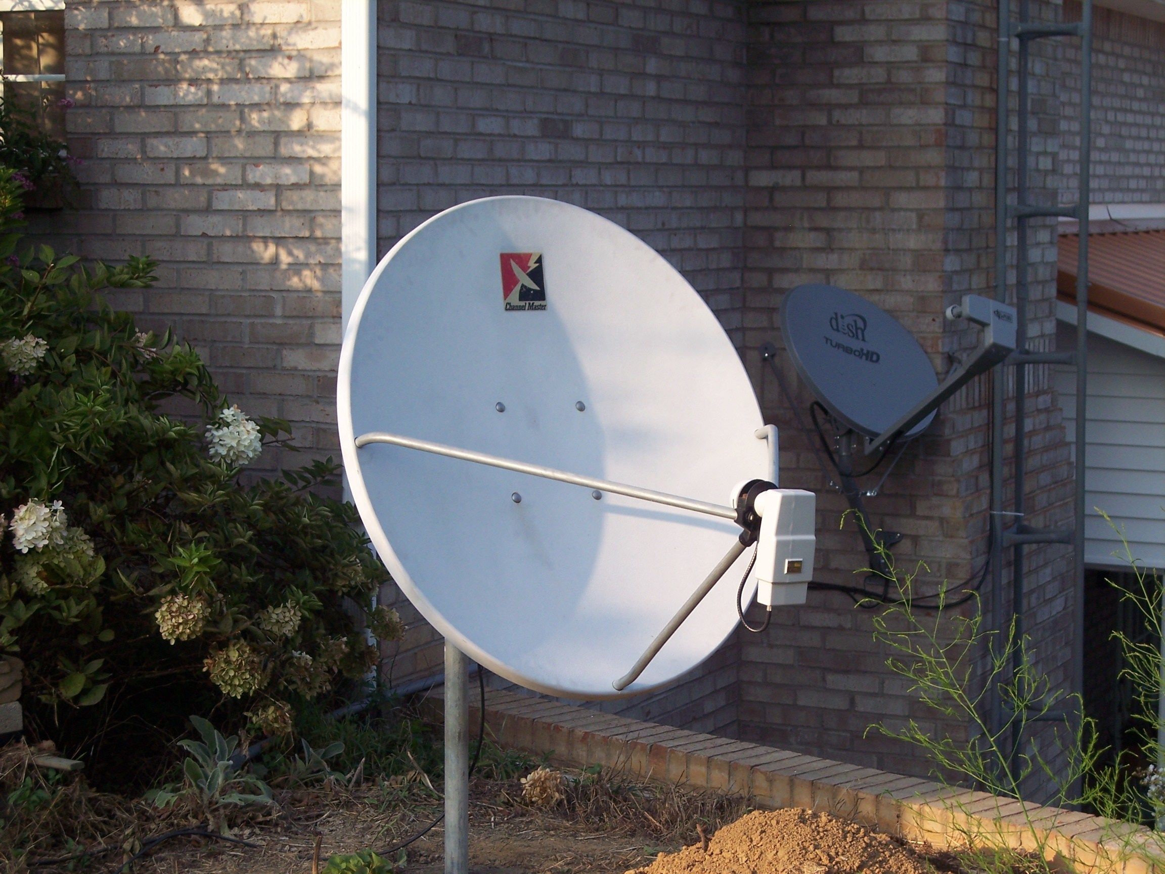

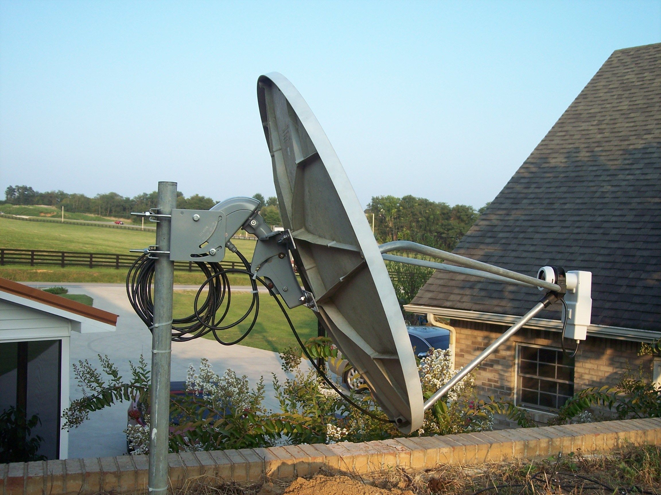

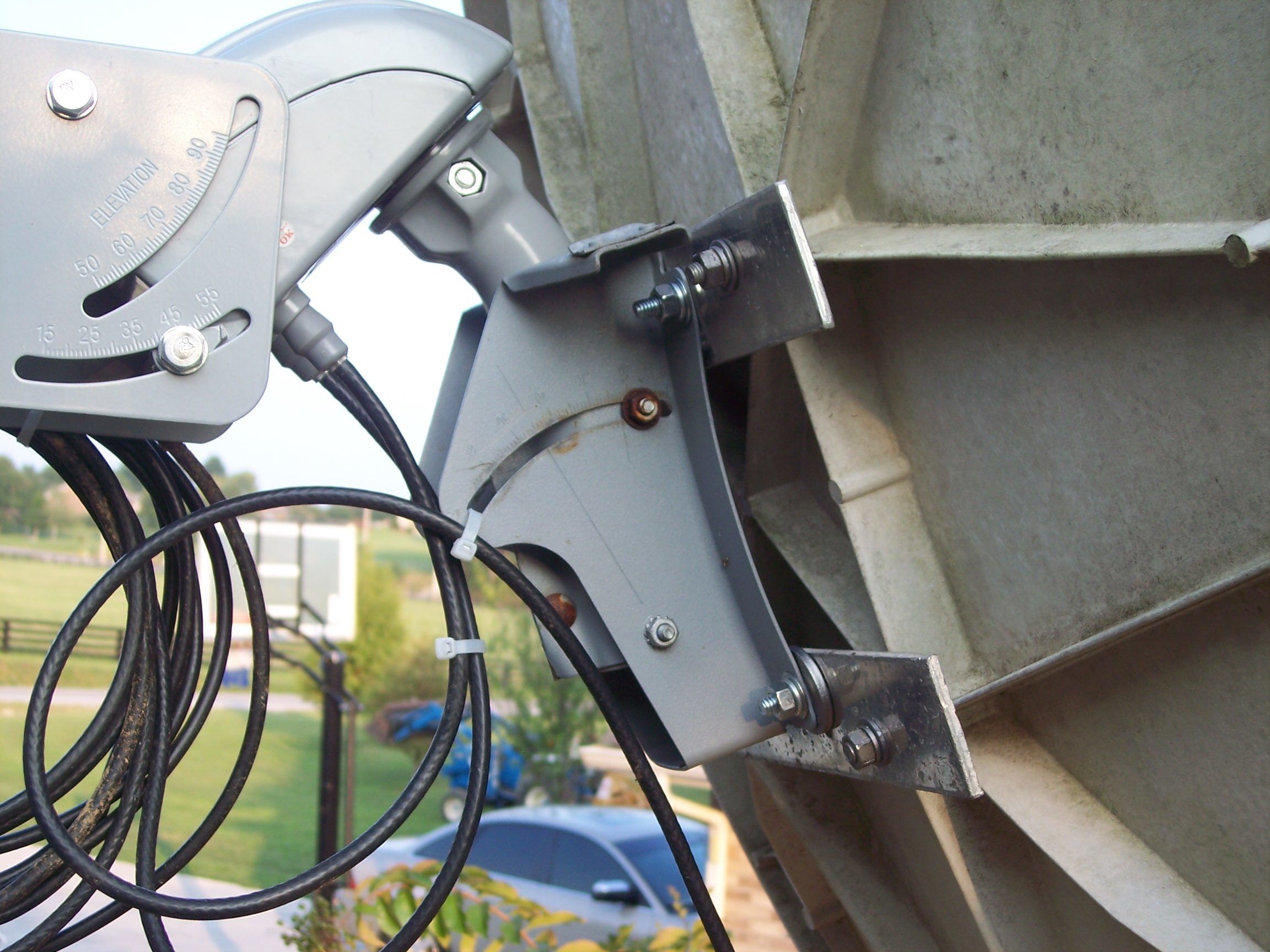

I'm setting up a 90M Channel Master Dish with a SG9120-B motor. I redesigned and made my own mount on the back of my dish. My location is Lat - 37.1° N Long. 84.6° W. If I figure it right, my True South should be pointing in the direction of satellite AMC 16 ku band at 85° W. Is this correct? On my mount I designed, when the face of my dish is completely level 90° to the ground the sleeve that clamps on my motor shows it is at 10-12 degrees so I know that's not correct. I think my other dishes I have when set the same way show about 25 degrees. I think my dish should be pointing upward and I think ther might be a few more satellites further up as in 61 degrees. I will test this out tommorrow, I have a new pole perfectly squared in the ground and I am waiting for the concrete to dry.
Please post some pics of your modified mount, if you don't mind. My 9120 motor arrived this afternoon and I was going to make a mount for one of my primestar dishes this weekend. I have been looking at some of the various mods in other threads for ideas of what worked and what didn't work.
OSU1991, I try and do that in the next couple of days. what I did was modify a Direct Tv dish, a old one that has a lot thicker and stronger steel. I took that mount off the dish and cut the lnbf holder off. I used two thick pieces of aluminum strips to mount to the dish and the Direct Tv mount was bolted to those upside down. I does seem to be quite strong but, I don't thing the new mounts would be strong enough, they are made of very thin steel. I'll post some pictures as soon as I can.

My modified dish mount
Here are the pics I promised.
