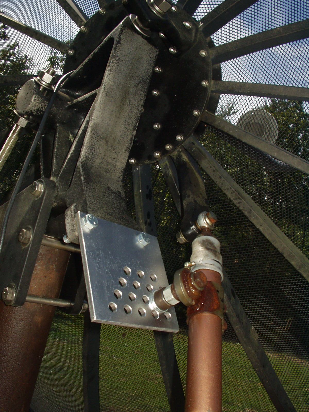

This is a picture of the mount plate I made for the Von Weise Actuator on this Raydx. Notice the two bolts that hold that silver plate in place? Those are the original actuator mounting holes, one of which is too close to the dish arm preventing it from coming back to 139W and the other was too far away, which wasted about 3 inches of actuator stroke. Where it's mounted in my homemade plate the dish is on 139W and only has about a quarter inch of West movement before the actuator hits the West limit. That way I can get almost all the stroke of the actuator back East. Where it's mounted also prevents the tube from hitting anything on the polar mount as the dish tracks Eastward. The way it's set I have pretty much all of the 24" stroke in use and I do believe I may be able to get back to 30W with this one.
That 24" stroke may be a problem for this Vbox 7 I've got connected to that Von Weise as there's 1099 counts from limit to limit?? Not sure this will work as the counter never shows me a negative or positive number when it crosses over 1000?? It just goes back to 000 and starts the count all over again. That Von Weise mover has the 8 magnet wheel in it. I also have a 4 magnet wheel that I may have to use when it's all said and done.

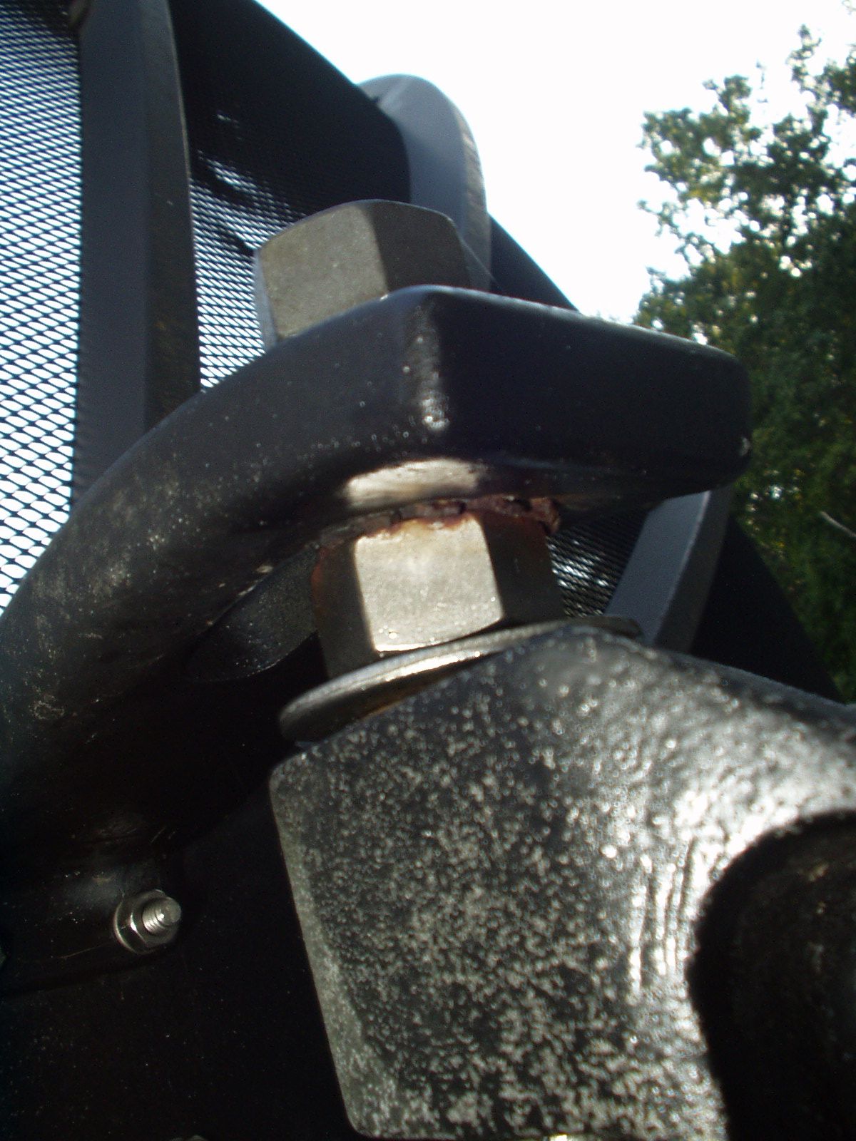

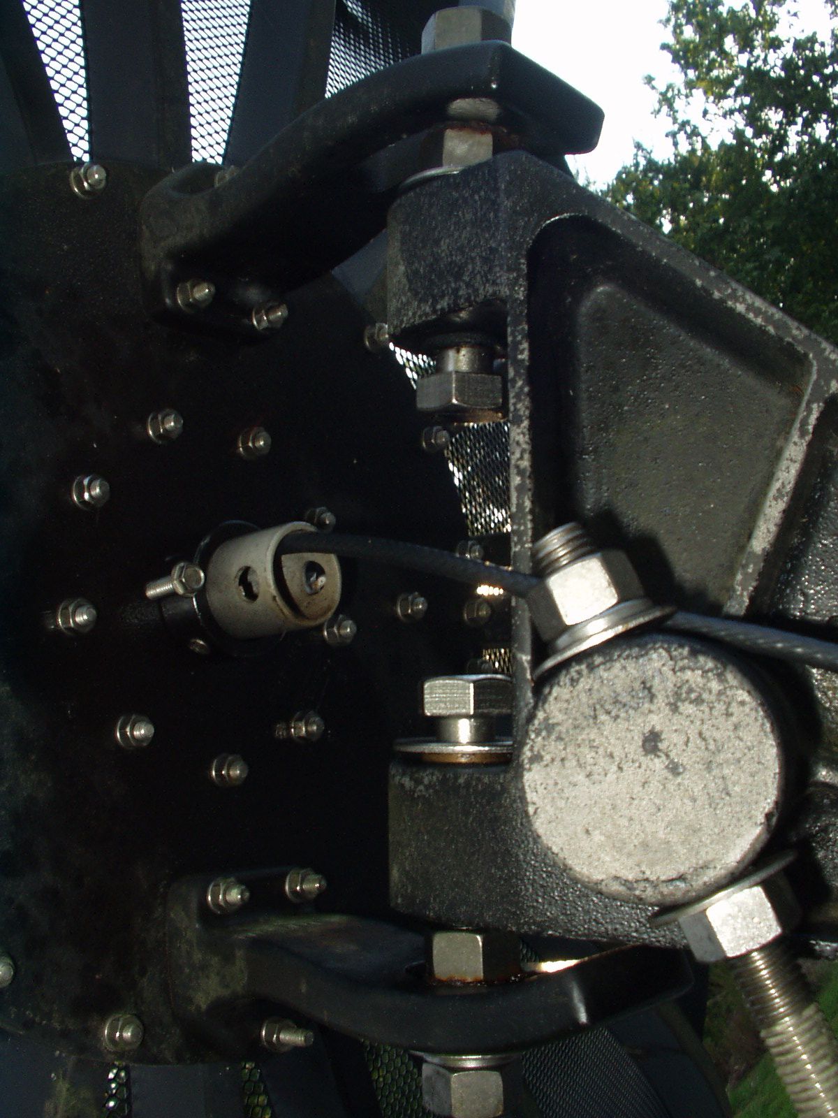

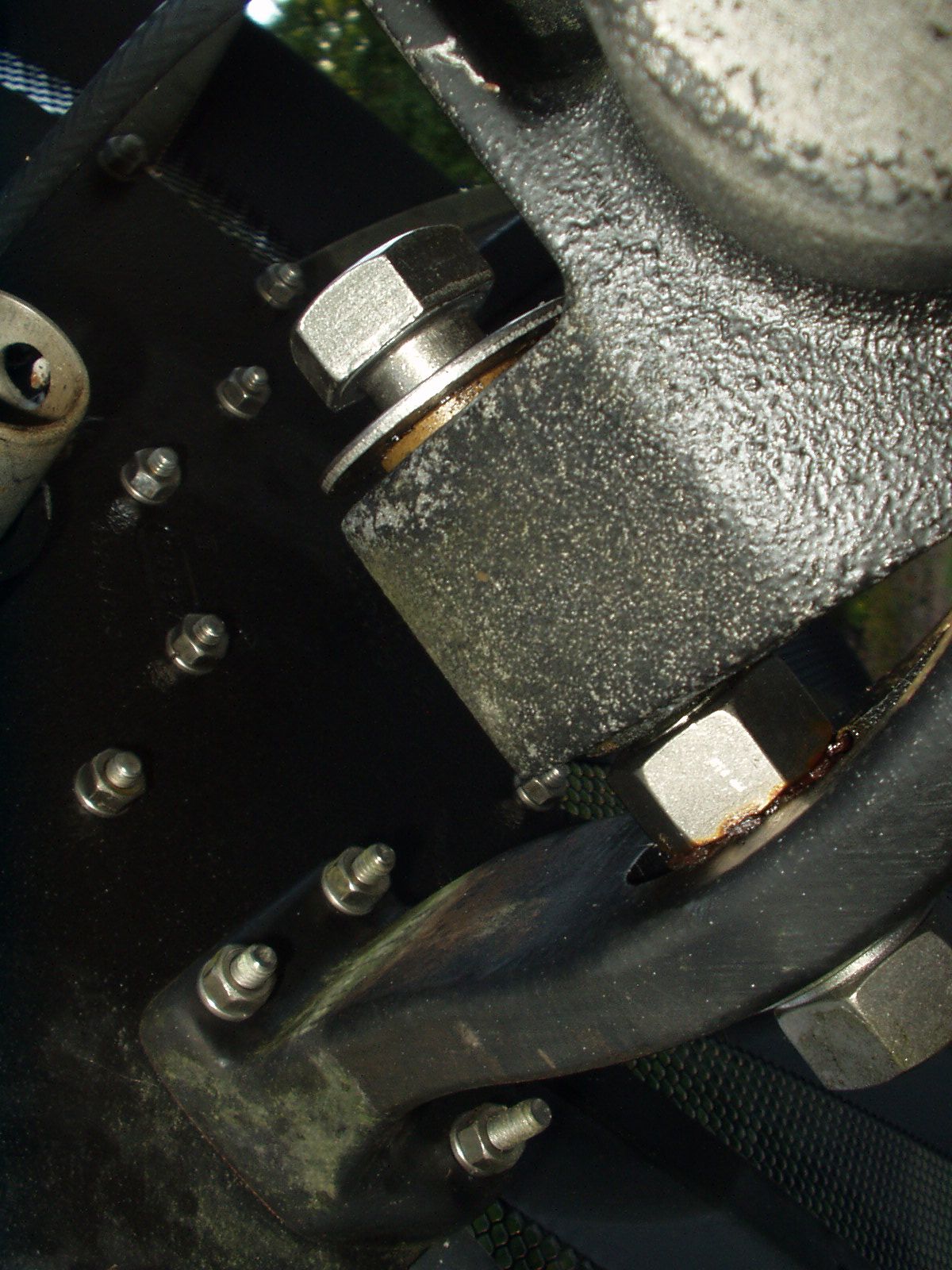

Here are a few pictures of the declination setup on this polar mount. Notice in the first picture that there are two 3/4" stainless bolts holding it together at the pivot point along with various hex nuts and flat washers. Notice also that where the hex nuts are there's a regular steel star type lock washer that has dug into the aluminum and this is where I believe the problem is.
The way those cast aluminum pieces are made that come off the back plate on that dish they have a radius that would indicate to me that there is "suppose" to be a piece in there that matches that radius instead of those nuts and steel star lock washers. Both the top and bottom bolts have to be loosened to change the declination angle but with those lock washers dug into that cast aluminum I got a feeling it's going to be a bitch getting that thing to move in small enough increments to make those declination adjustments that are needed to fine tune any setup.
I think I can make some 3/4" aluminum blocks with a 3/4 x 10 threaded hole in'em then grind and file the back side so it matches the radius in those dish mounts. That way they can slide easily with the bolts slightly loosened and make things a whole lot easier to work with.

The steel lock washers certainly look out of place. I could see them being used between lock nuts but they would be redundant. Not sure I might see nylon bushings in the stationary part. If so the bolts should be tightened in the moving part which could be why the lock washers were installed there. In my opinion the locks should not be used, or at least not used between two moving parts where they would wear into the surface loosening the bolts causing play. Looks like a really strong mount though.
edit: I see the slots in the upper and lower dish-side brackets now (found my glasses). If you replace the lock washers with fairly thick and wide flat washers you might still be able to do some fine adjustments if you leave the nut a bit loose...

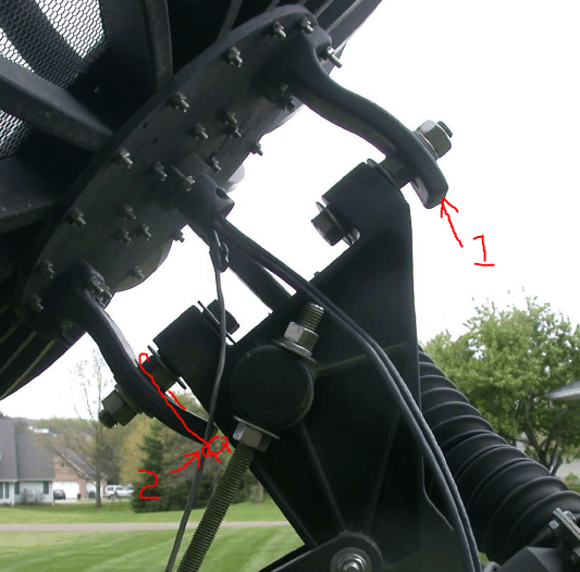

I don't have a Raydx but, looking at the pix chc59 posted, I can see where declination adjustment could be a real PITA. One solution to aid your declination adjustment might be as follows:
Drill & tap the upper slotted arm and install a jack screw to adjust the D3 dimension. (Location 1 in attached)
Fabricate a U-bolt and strap, not unlike a muffler clamp, to straddle the lower bolt/slotted arm to adjust the D2 dimension. (Location 2 in attached) Another option for the lower arm might be to, instead of the U-bolt, clearance-drill the end of the arm and drill & tap the lower pivot bolt to accept a pull screw. In either case, gravity is your friend.
My guess is these mods would be less work than trying to get your Dec. well set with the factory means of "adjustment".

capned thanks for the suggestions as these aren't something that I was considering. Will rethink what I want to do with it now though.
No problem, Lone Gunman.
Another thing that would probably be a big improvement would be to replace the 2 hex screws being used as the hour pivot, with a partially threaded stud of suitable size. In the pic, it appears those 2 screws are not on the same axis, which would cause a bind/undue wear in the elevation casting. Replacing those with a single stud as the hour shaft should eliminate that issue and should also reduce/eliminate any change in your Dec setting when the nuts are tightened. If you can find a stock stud of the correct size, this should be an easy and relatively inexpensive improvement: http://www.grainger.com/content/cat_405_threadedrods?page=9
I agree that losing the star washers is a good idea. Replacing those with USS flat washers might work well. Put the smooth side of the washers facing the slotted brackets and use a screw & nut to form the radius of the slotted brackets before assembly.
Nice thought but you can't run threaded rod against the bronze bushings that the assembly pivots on. FYI, those bushing holes appear to have been machined on the same setup in person, ie, they're in line with each other.
I was originally thinking of replacing the hex nuts with some 2" square x 3/4" thick T6 aluminum blocks threaded 3/4 x 10 with a radius on the blocks to fit into the radius of the slotted brackets. Those would give me more surfaces to work with to try to make it a fine adjustment type thingie also, which is my major concern with the whole deal.
As I said, right now I'm just brain storming and trying to come up with something that's simple but effective. No, haven't gotten there yet though. :oldwink
Agreed, but using a partially threaded stud where the center, unthreaded portion, rides in those bushings is what I was suggesting. Not unlike having the unthreaded "shank" of those two screws riding in those bushings but without having to rely on the cast surface of the slotted declination brackets for both ends to be on the same axis; unlikely. The idea is to find/make a stud of the correct diameter (3/4?) with an unthreaded length (center) slightly shorter than the length across those two bushings. Yes, no doubt those bushing bores are, or at least intended to be, on the same axis.
