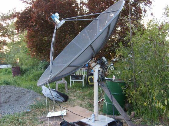

Having perused these forums for the past couple years, finally took the plunge
and set up a 7.5' mesh dish which someone was giving away free. It has an
AJAK H to H positioner and a Chaparall Diamond Cband LNB with markings of temp K 20degrees.

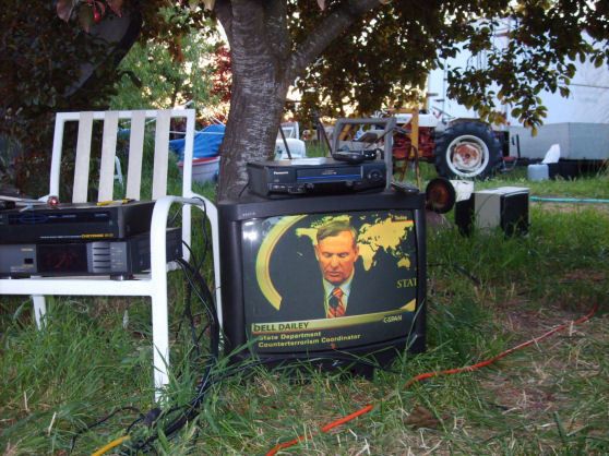

Located a Toshiba 1820 C/Ku band receiver,but without a remote. Having gotten
everything hooked up, was pleasantly surprised to receive crystal clear FTA
from F4, G1, & F3. Also tried a dual C/Ku LNB but didn't receive any Ku band
possibly on account of not having a remote for the receiver.
My question is, can someone recommend a FTA analog/digital receiver that would drive this dish and give the most bang for the buck?
Secondly, is there a receiver that would do all that and have the option
of adding subscription programming at a later date?
What about upgrading the LNB?
Couldn't have gotten this far without the excellent info. & links from this site.
Still new to this so hope this is posted in the correct forum.
Thanks in advance.
The only receivers that do analog & digital are 4DTV boxes. They allow you to subscribe to programming too. Something like a Motorola 922. You could always add a FTA box for the other free stuff
you could do that too. Usually folks have the theory on the LNB's if it aint broke don't fix it ;)

You are correct in thinking that at least part of your not being able to receive Ku is due to not having the Toshiba remote, you need the remote to make the receiver select the Ku input.
Not sure if you could run your Ku cable to the C-band input just to see if you could get the Ku going or not, sounds like you are heading a different direction anyway but it might be worth a try. :)
