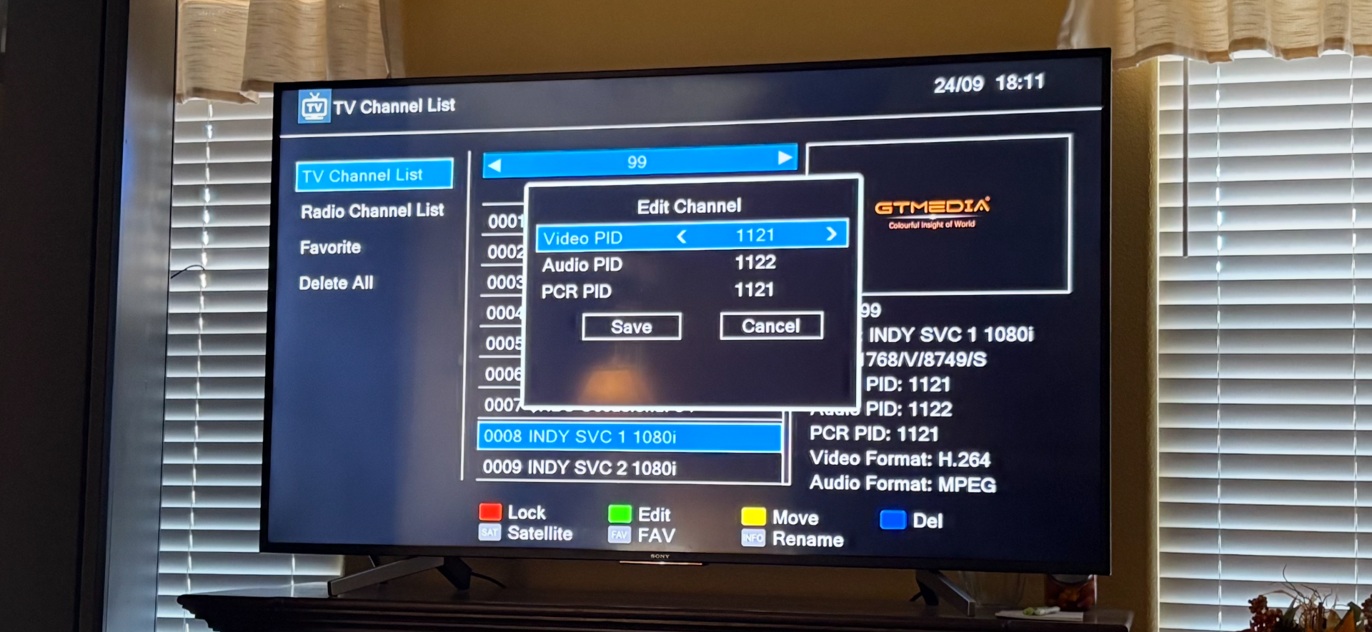

lost_mesa :
From the main menu, go to Channel, TV Channel List, select a channel, press green button on the remote, then press OK. That brings up this screen which allows you to edit video and audio PIDS.

lost_mesa :...That brings up this screen which allows you to edit video and audio PIDS...
Works for me! Easier than using the editor. And I could save my changes. Maybe the box firmware version is important. My S/W version is V203.03.06.28.207 March 18, 2025.
Added: Doesn't work! I could save the new PID. But when I exited out to watch the channel and change channels, then the old PID returned.
Added2: From long ago, I learned if you want to change PIDs, you must also change its SID. Or the info gets written over as soon as you receive the signal. So try changing to any unused SID and maybe the new PID info will stick.
Got it to work on radio channel. On 101 KU, 12000 V 20000, WRAL scans in on a blind scan, however it has no audio. Change VPID to 0, change APID to a Muzak/Mood APID, change PCR PID to 0, hit Save. The audio will then change when you exit the menus.
HOWEVER, if you change away from that channel and then back, it reverts to WRAL's old PIDS.

I tried it on WRAL. As soon as I hit save, I can see the pids on the right hand side of the screen change for a fraction of a second, but they immediately return to the original values. Like they are being overwritten by something. Not sure what software version I have. Where do I find that?
Make sure you're not tuned to WRAL when you make the edit. I selected the "Microspace61" channel then edited WRAL, then hit Exit and it asked me to "Save."
